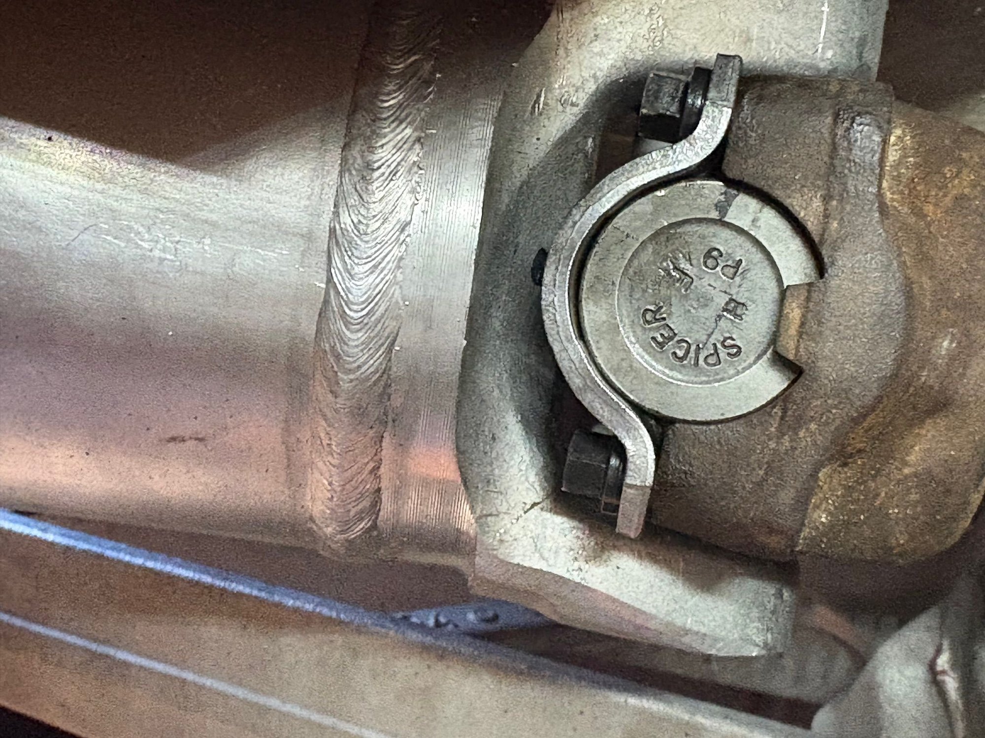

Whaleman's Avatar
Whaleman
Joined: Mar 2017
Posts: 4,202
Likes: 1,323
From: LeClaire Iowa
This photo shows what arbee was pointing out. Once the strap is down tight more torque will not change the position of the strap or exert any more pressure on the Cap. Dan
Old Oct 20, 2025 | 12:26 PM
arbee's Avatar
arbee
Joined: Feb 2003
Posts: 2,677
Likes: 812
From: Saskatoon Sask.
Thank you!!! FINALLY someone with common sense!
