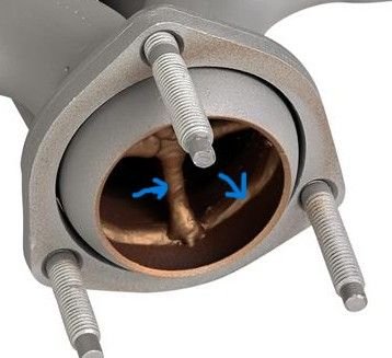

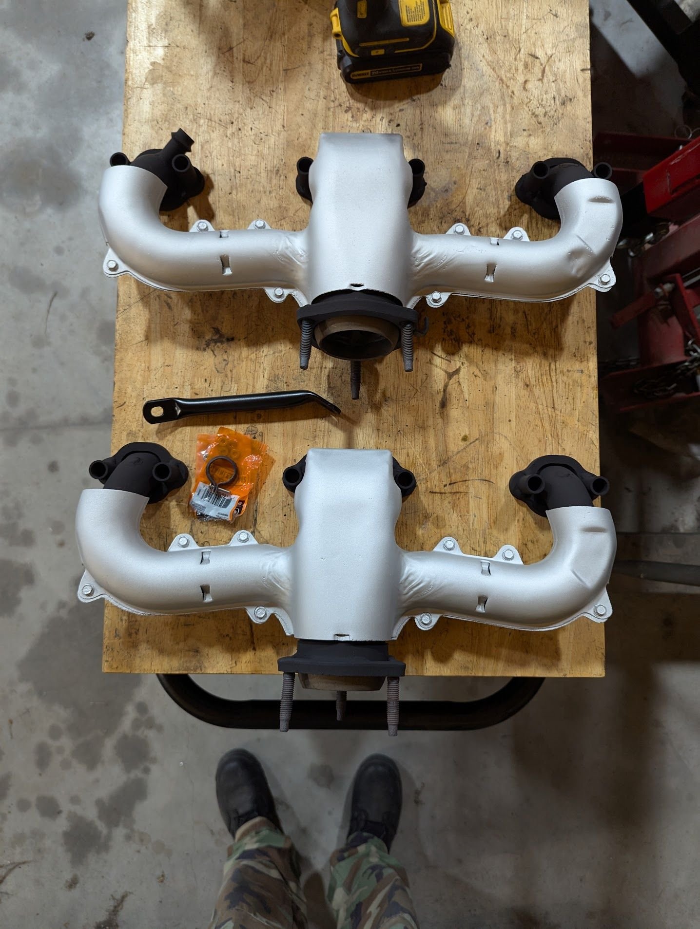

this is what the stock exhaust manifold looks like at collector.
these measurements come from a 84. but all these style exhaust manifolds look like they are pinched off the same at collector.
stock csa .88.6. 88.6 x 115 = 101.89 cfm
ported stock csa 1.03. 103 x 115 = 119 cfm
next restriction would be cat and mufflers
