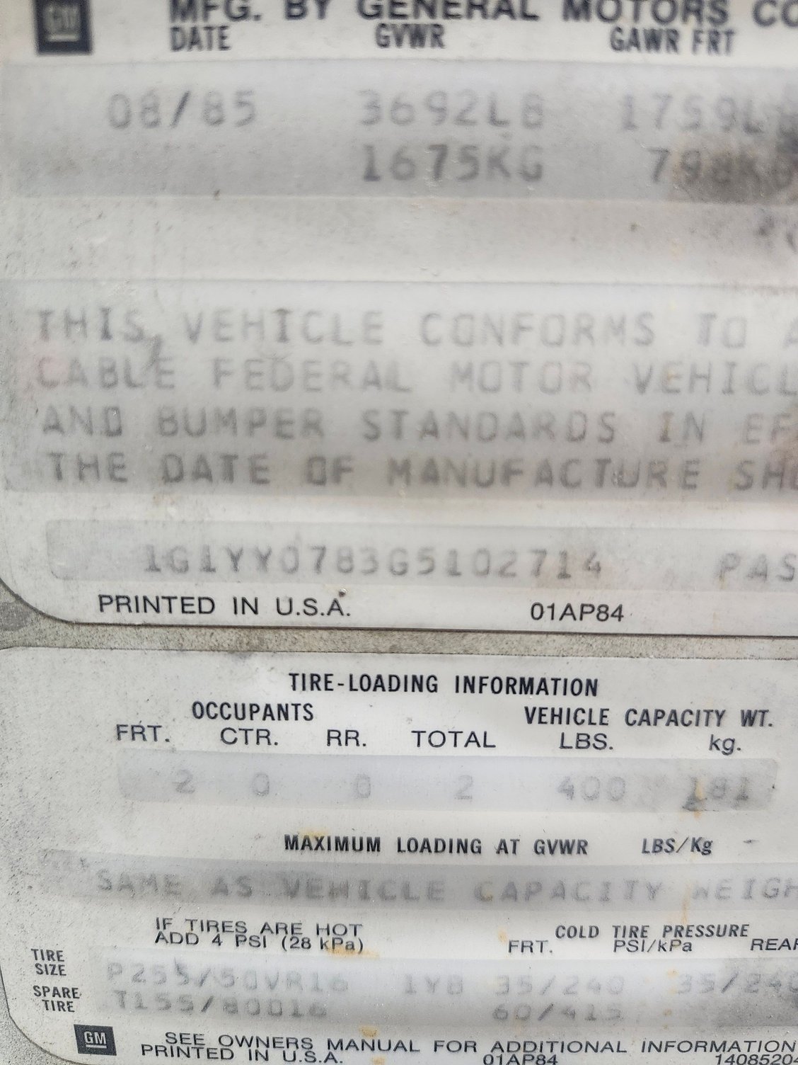

1985 had NO VATS - what the VIN of the car?

Default Vin and build date

1986 and yes there was VATS. 10th digit VIN 'G' - 1985 would have been 'F'.
Old Nov 1, 2025 | 05:43 PM
Swest71's Avatar
Swest71
3rd Gear
Joined: Nov 2025
Posts: 3
So for all intents and purposes this is an 86 and the 85 MY wiring diagrams are irrelevant?
Old Nov 1, 2025 | 05:54 PM
WVZR-1's Avatar
WVZR-1
Joined: Sep 2003
Posts: 25,384
Likes: 2,736
You need '86 wiring diagrams and base all of your diagnostics and ECM pinning etc based on the '86 also.

MFG Date is NOT the same as the model year. As others mentioned, VIN has the actual model year.
Guessing your '86 also has iron heads, as in the valve covers have bolts around the edge. This makes it an "early" '86, later in this run switched to aluminum heads.
