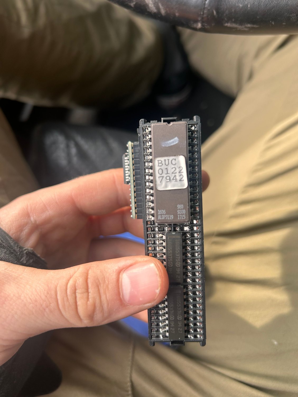

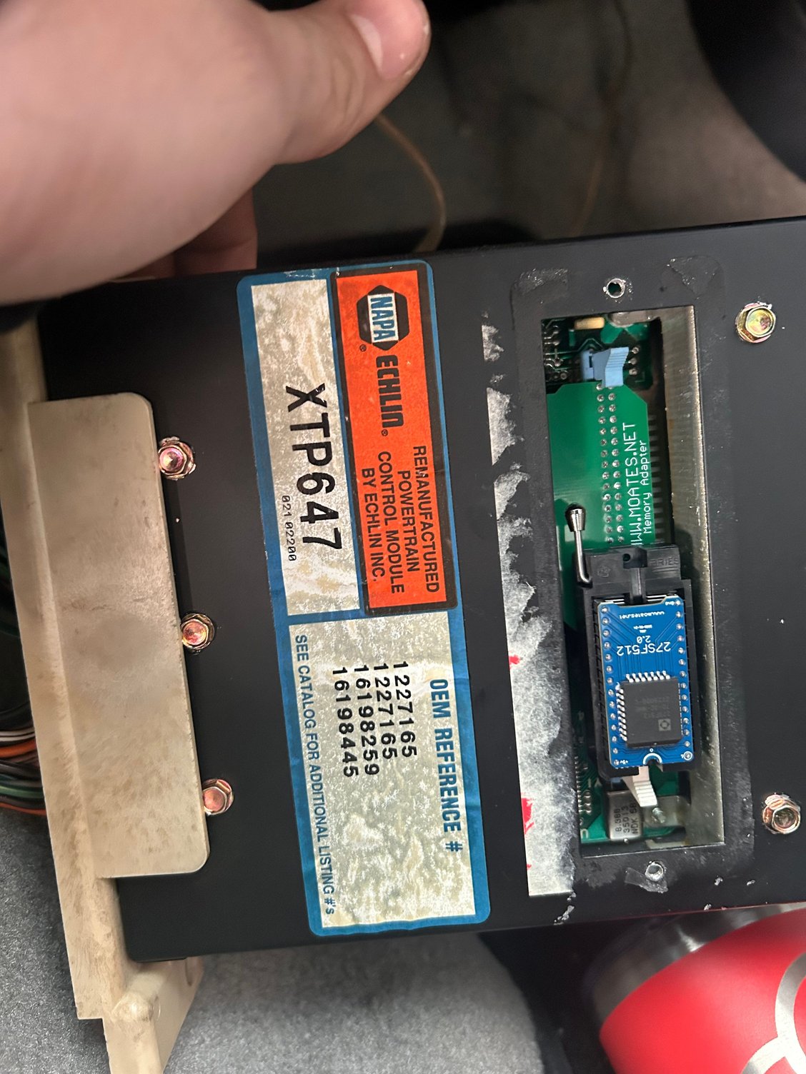

This is the sicker on the eprom, also i have a reman ecu

I took a look at your bin. Nothing but 0xFF FF...as if it had been erased until address: 0x4000. You need to split the bin and save addresses from 0x4000 to 7FFF as a 16k bin, or read the device again and save the upper addresses as a 16 k bin. Maybe you selected the wrong device type when your read the eprom, but some factory eproms are 27C128 while others are 27C256.
From the part number 0122 7942 it should be BUC 1724.
Here's one the bin that I split from your original. It compares well against the other bin that I posted (4 bytes different).
