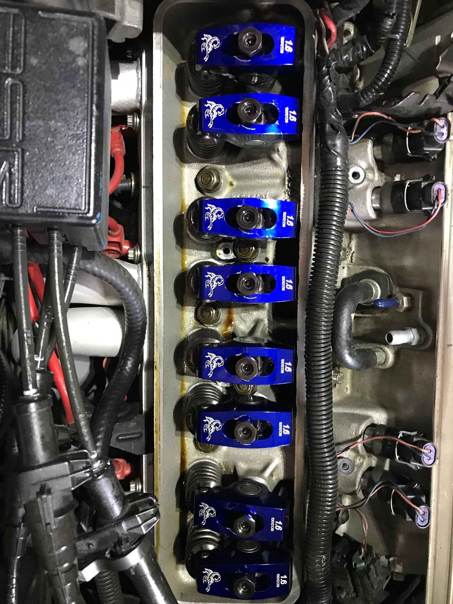

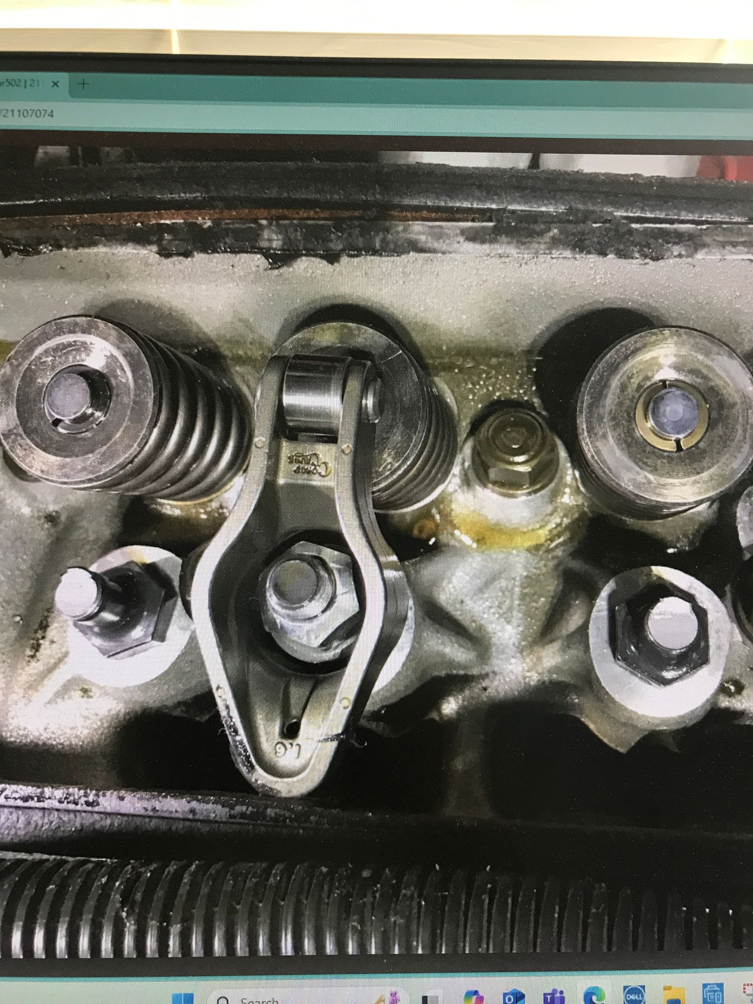

I am not an X-pert on the rocker's or springs but ,I know what worked for me after trying 2-3 different sets that didn't work ,springs the same I tried the ( these will work on any Chevy small block) NO they won't I went with the (Alex's Parts) springs these are custom made for your motor TX. speed harden push rods stock length ones .. The rockers been in two years in have checked them still adjusted just like the day installed .. Pic of off the shelf, Thes work on any small block RIGHT .. Not an X-pert just what worked for my 93 LT-1
I changed the springs without taking off the heads the old school rope in the spark deal was kinda easy kinda not, but it worked .. I think way better that removing the heads, I can' stand coolant everywere .. Just me .
Did you use just a set of Roller Tipped Rockers? The second pic???
No, I had installed a new set of (these springs will work on any small block NOT) After the things started breaking I removed spring rockers started over. the Crane rockers I here work fine cheaper than the one's I have installed, not wanting to take any chances, I removed the rockers put springs in the can sold the rockers to another LT-1 owner I never heard back guessing they worked OK .. I understand they work.

Just a comment in case it wasn't clear... the post that @radar502 made shows a good example of two sets of different kinds of "roller rockers."
There's "Roller Fulcrum" rockers, which are the ones in blue. These have a true roller (with needle bearings) on the rocker stud, as well as roller tips. They produce less friction overall on both the stud guide and the top of the valve stem. They also have a higher ratio of 1.6:1 instead of the stamped 1.5:1. This may require some modification for clearance under the valve cover because they are bigger.
Then there's "Roller Tipped" rocker arms, which are the Crane Cam roller rockers in his second picture. This are also 1.6:1 roller rockers (higher than the 1.5:1) stock, but have standard rocker arm pivots. Even still, the fulcrum action is improved because the rocker pivot washer has groves that allow oil to more easily penetrate down into it, and thus they still provide less friction there beyond the stock rocker arms. And of course, they also
Do you need any other modifications on the 113 alloy heads to run the roller top rockers or just bolt them on?
fhanks.
You mean for the roller TIPPED rocker arms?
No, from the second picture (Comp Cams, sorry, not Crane Cames), they require no modifications whatsoever. They literally just replace the existing rocker arms. It's pretty great. I install them on everything I own that's pushrod.
