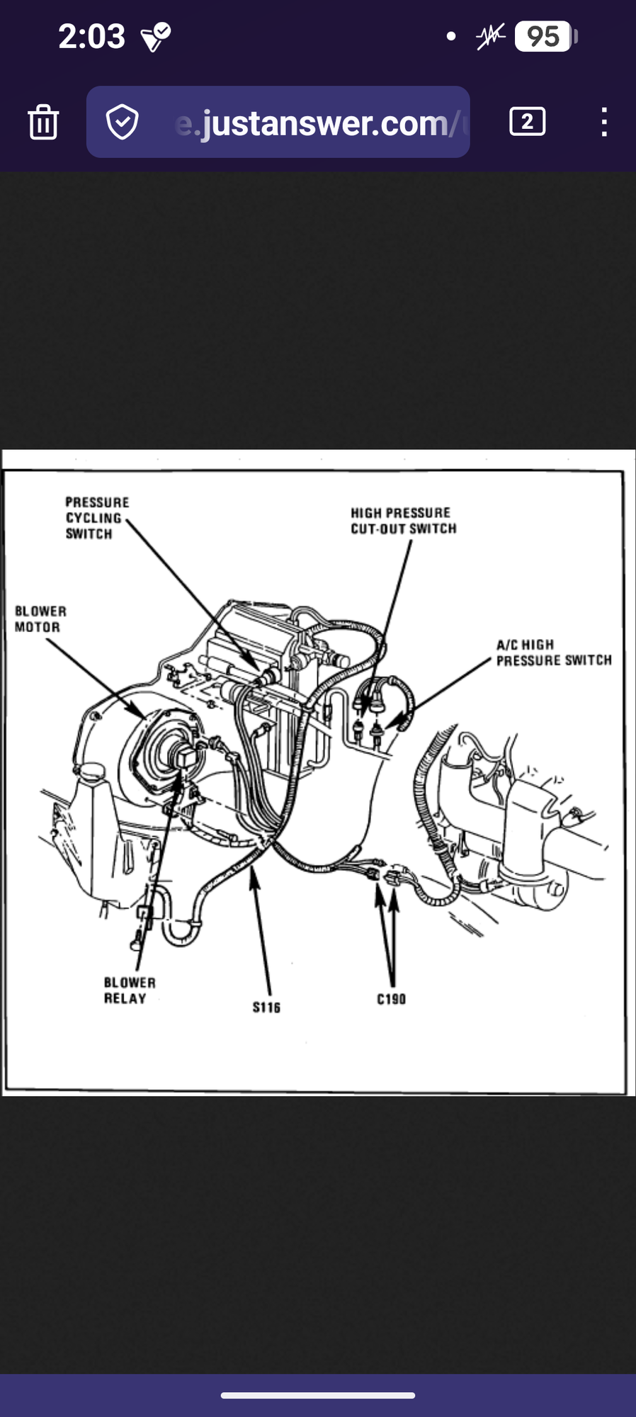

The high pressure safety is next to the fan request switch that is normally closed, opens around 220 psi to signal ecm to turn fan on. The high pressure safety next to it is normally closed, opens around 400 psi to stop compressor. The large plug right at the a/c box where the thick aluminum suction pipe connects to evaporator core, that safety (marked pressure cycling switch in diagram) is closed above 20 psi opens below 20 psi to cycle compressor. The 12 volts to a/c clutch goes through those two safety pressure switches, you can remove the low pressure safety plug and place a wire into that plug to bypass the safety switch for testing or while charging with refrigerant to keep compressor running till charged enough.

Thanks for the help. I bridged out the plug closest to the firewall and the Clutch came to life. Looks like I will be finding a R134a leak. At lease the car is a convertible so on hot days I can just drop the top.

The pressure cycling switch is the one you bypassed to get the a/c clutch to come on, check its not come loose. Be careful don't over tighten is an aluminum port just needs to be snug.
