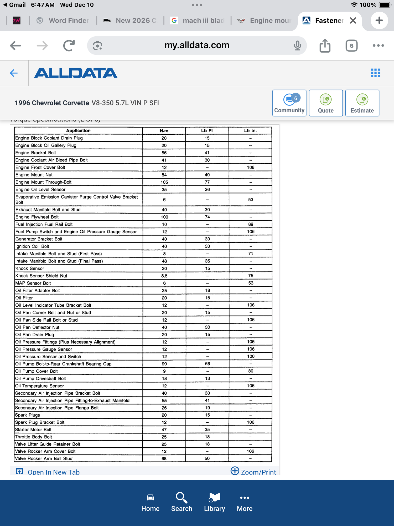

I have a 96 base model just trying to tighten down the nuts on the underside of the engine mounts to the subframe. What foot pounds do I use?

40 lb/ft
