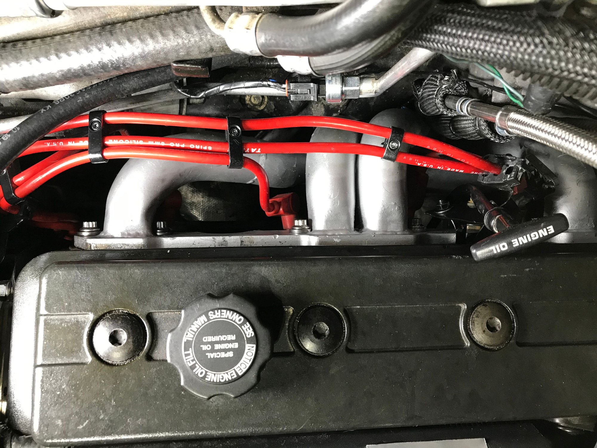

Default 93 LT-1 moded no RGR
This 93 LT-1 got about the same mods no EGR open exhaust 1.6 rockers ported heads 307 rear Etc. No tuner here, I used PCN of NC. runs great been using them for years, do you need one??? The tune pepped up my 93 BIG time no codes .. My 2 cents ..
