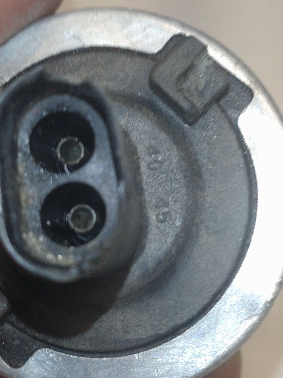

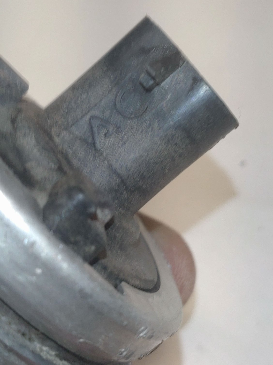

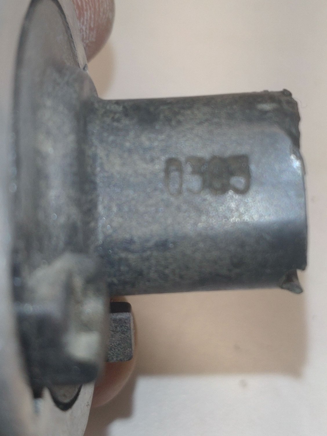

This is my stock sensor from my 1984 th700r4. I don't see many numbers on there and nothing similar to a GM part number.
"AC" is AC-Delco.
"40 45"
"0385" possibly.

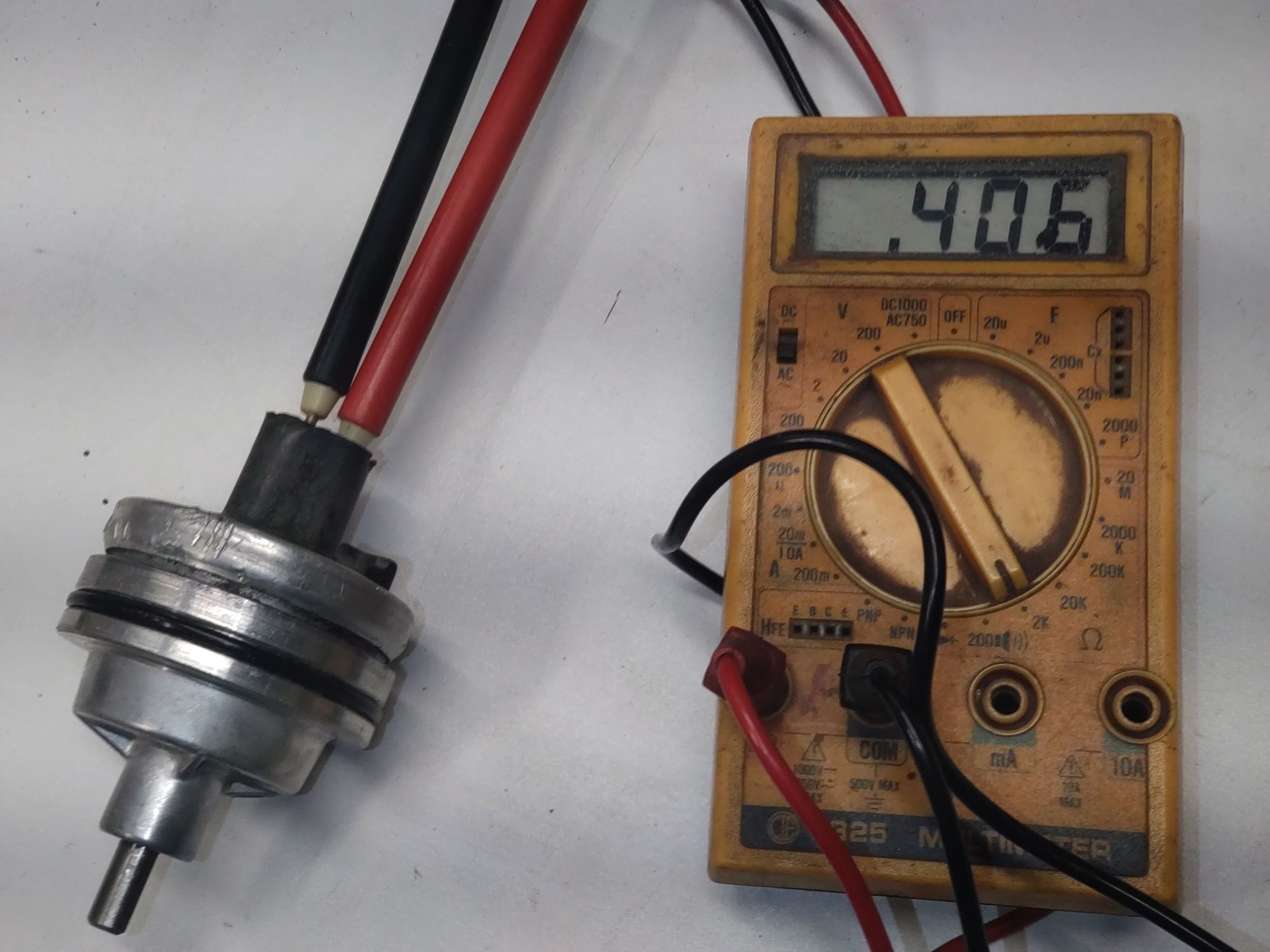

The sensor is a rotating magnet and a coil with about 400 ohms.
I switched over to measuring AC voltage and by turning shaft by hand it was easy to reach 1 Volt.
I think the sensor is failry robust. There could be some wiring problem. Both sesnor wires go directly to the cluster.
So you should be able to measure 400 ohms at the cluster connector between pins C15 and D11.
If the resistance measures within range it could aslo be a problem with the small plastic drive gears, one on the sensor and one on the output shaft.
