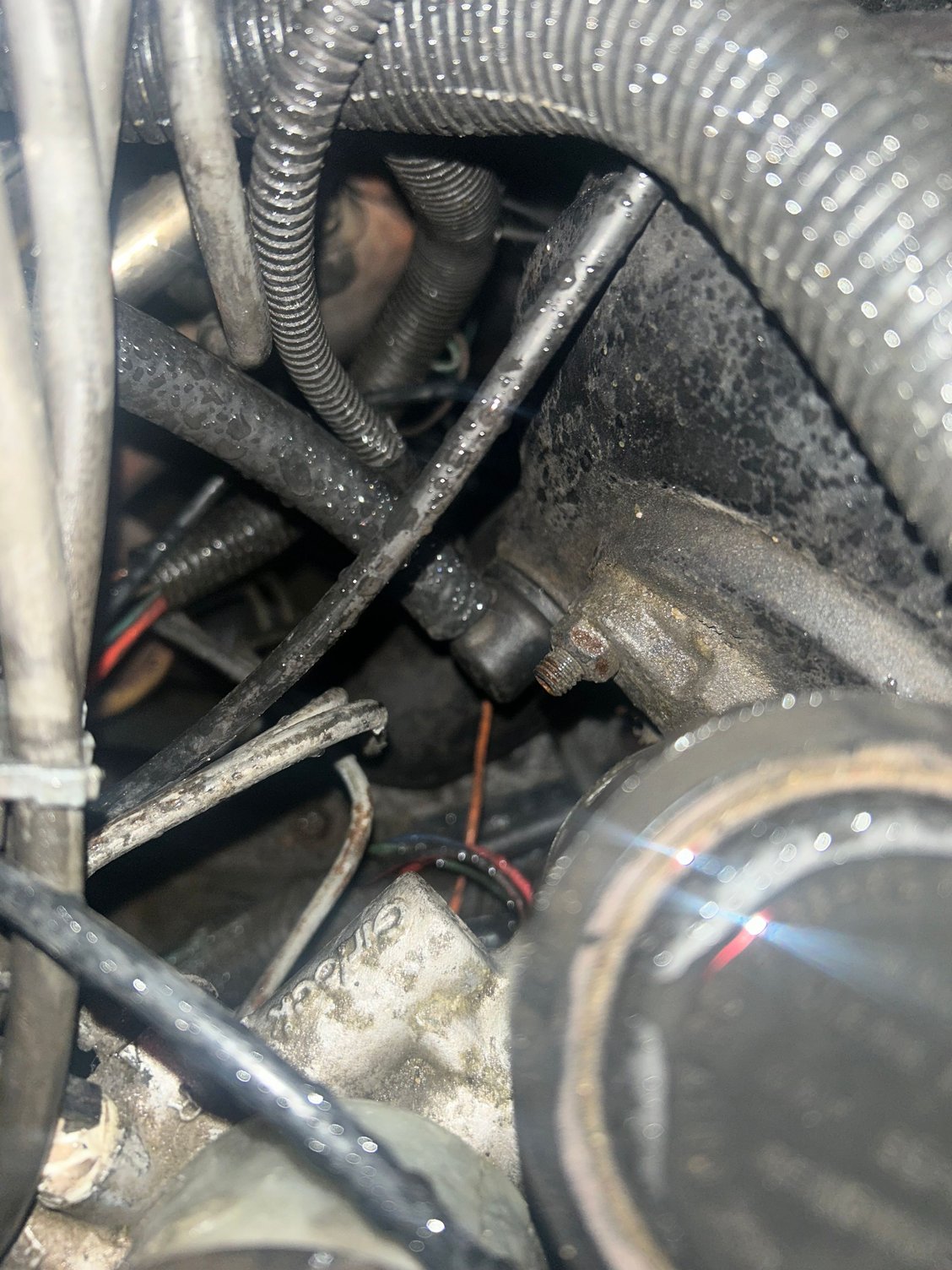

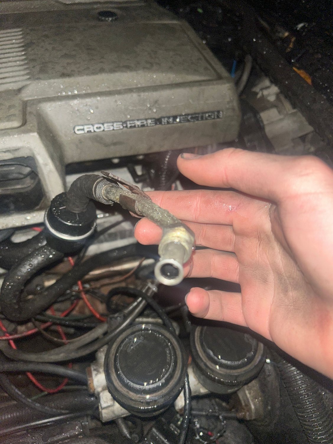

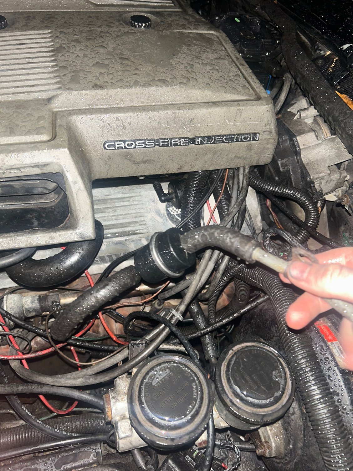

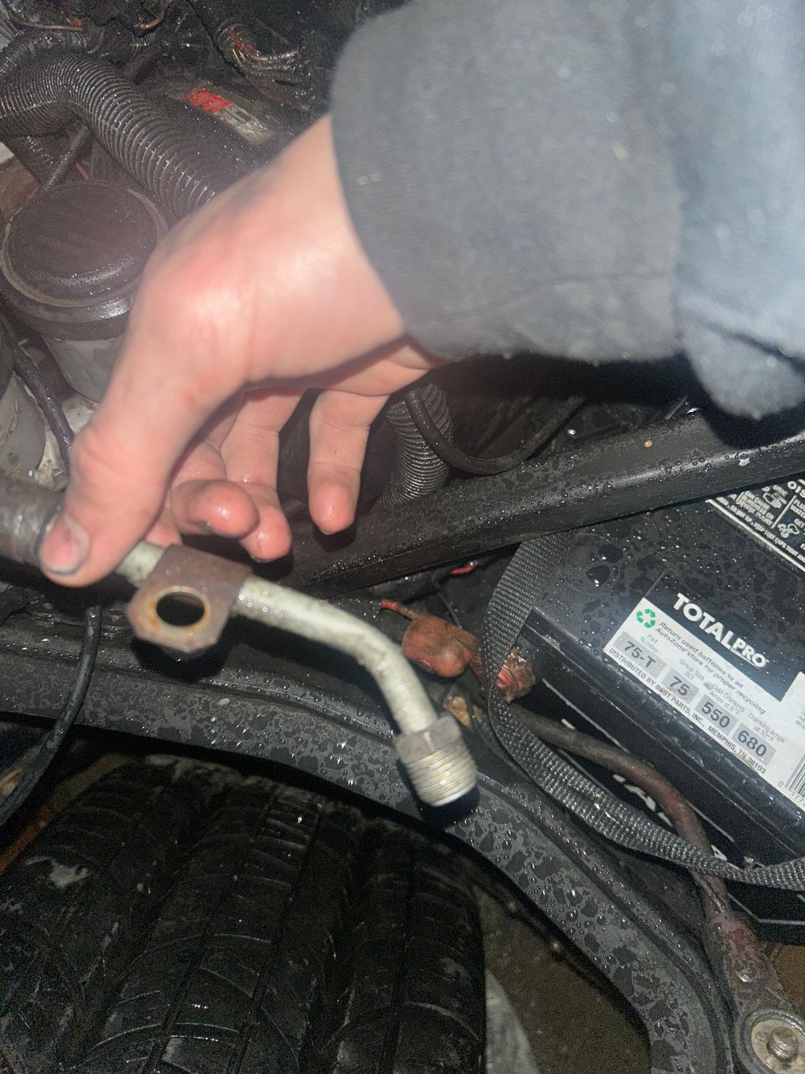

1984 Corvette, stock. I can’t figure out where this threads into to save my life. The other end is clearly connected to the brake booster - but where does the other end go? If someone could circle the general area that it goes in the engine bay that’d be great!

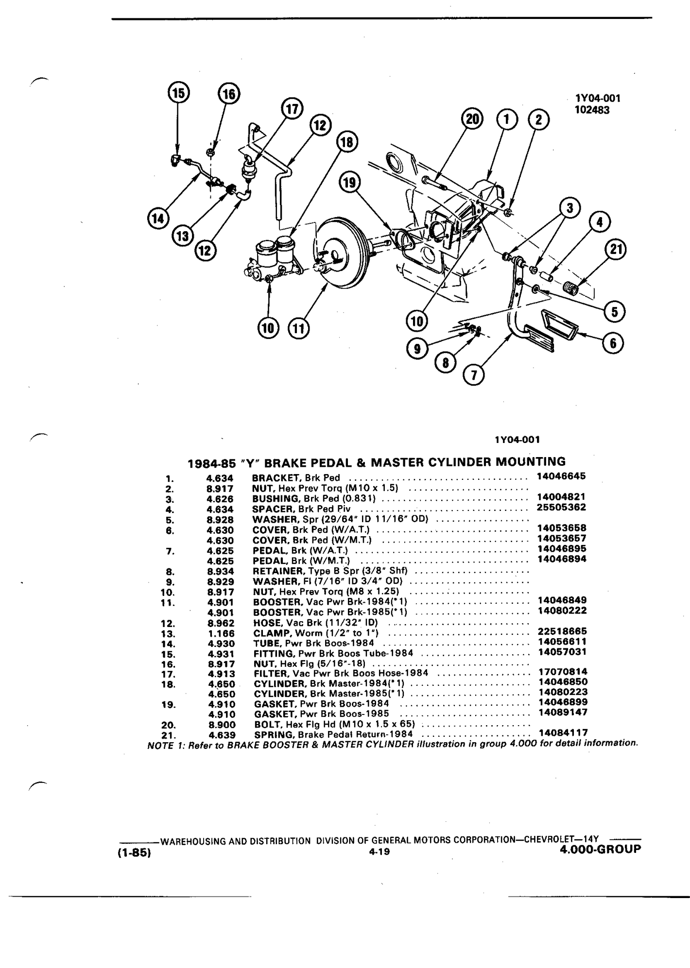

This should be routing for '84 and I'd think help you.

On the intake lid behind the rear TBI unit.

power brakes? Looks like poerbrake booster filter
theres a stud on manifold and an elbow to thread into. Need that hook up for power brakes
