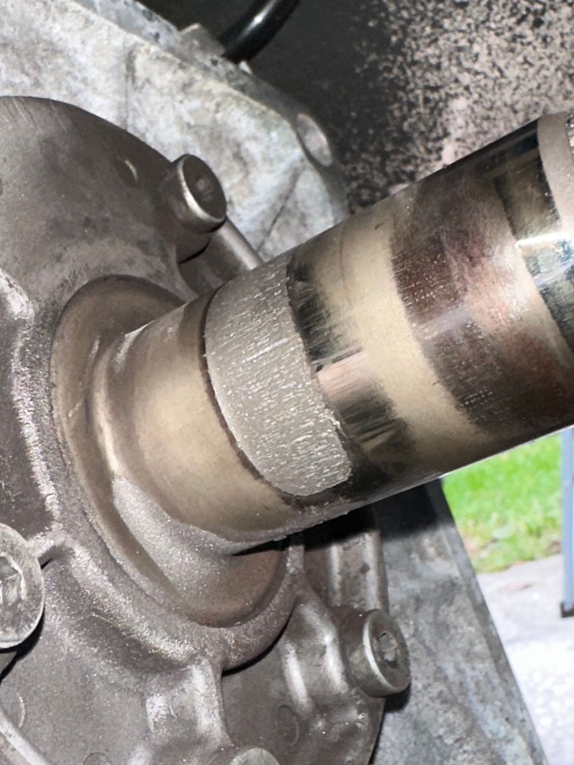

I was expecting to find heat spots but surprise - Chinese quality. The throw out bearing failed. The inside of the bearing started spinning on the outside of the input shaft collar. It gauled the collar as it moved and spun on the sleeve.

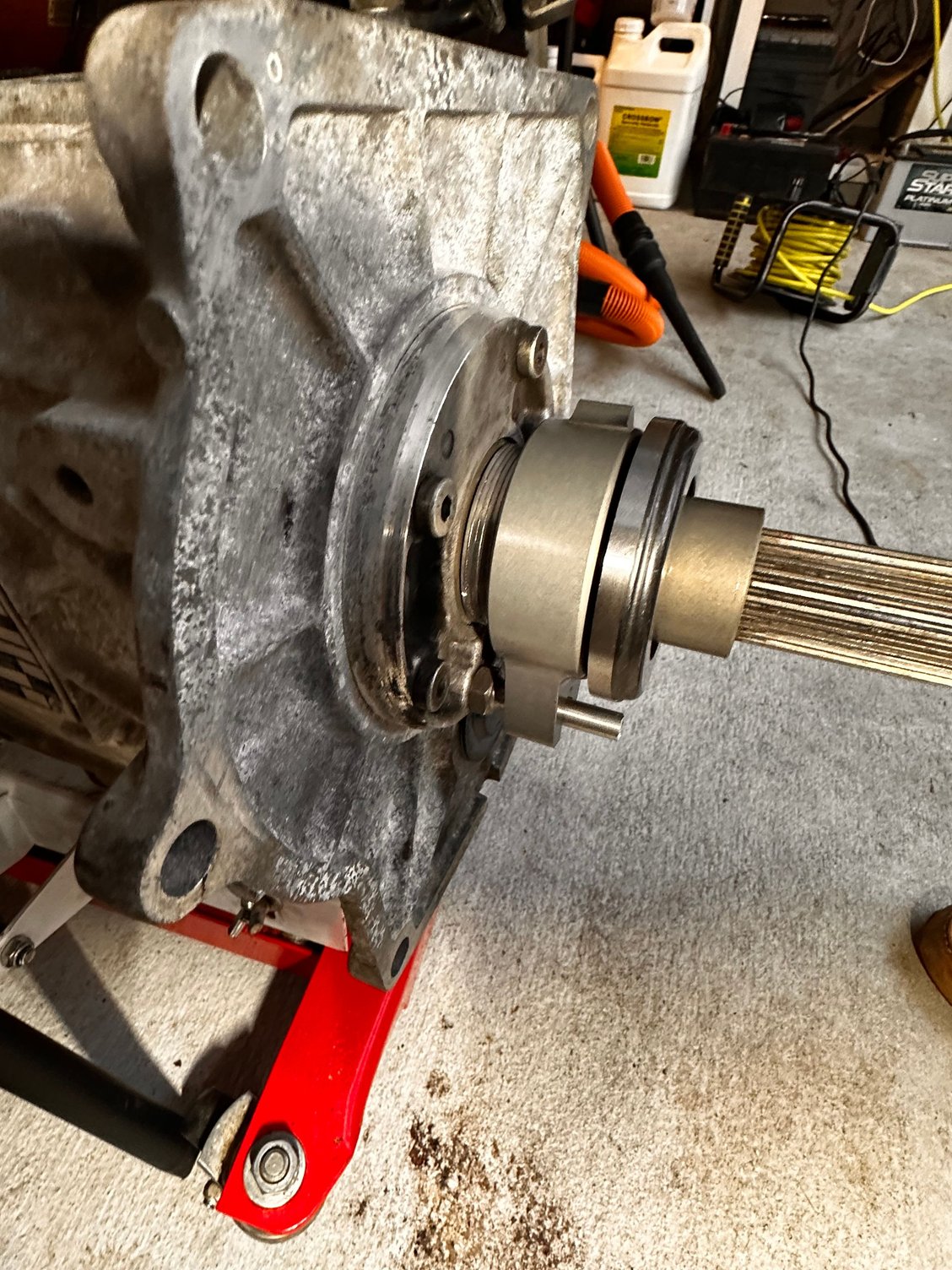

I did not replace the collar. The slave/throwout bearing for the RAM conversion slid over the collar as an assembly. The RAM system presented a perfect solution for me. After a 30 miles test drive, I can live with it.
Vette is all stock, 1993 Z07.
42,000 miles
New RAM slave hydraulic throw out bearing combo which slides over the input shaft collar
New RAM slave hydraulic throw out bearing combo which slides over the input shaft collar. The fit was very tight, which was a PITA during assy - pushed the assembly on to the collar us g the PP fingers.
Shims are visible. I used all provided and was around 0.190”
Pic shows uncut locating pin
The travel for the throw out bearing is the length on the inner assembly sleeve (bronze color). The bearing is replaceable. I read the hydraulics is rebuildable. I don’t plan to do this again.
Input shaft collar damage. Didn’t want to install another crappy pull type throw out bearing and possibly completely ruin the sleeve. Didn’t want to install a new sleeve and risk it leaking trans fluid of it being damaged again from crappy products.
