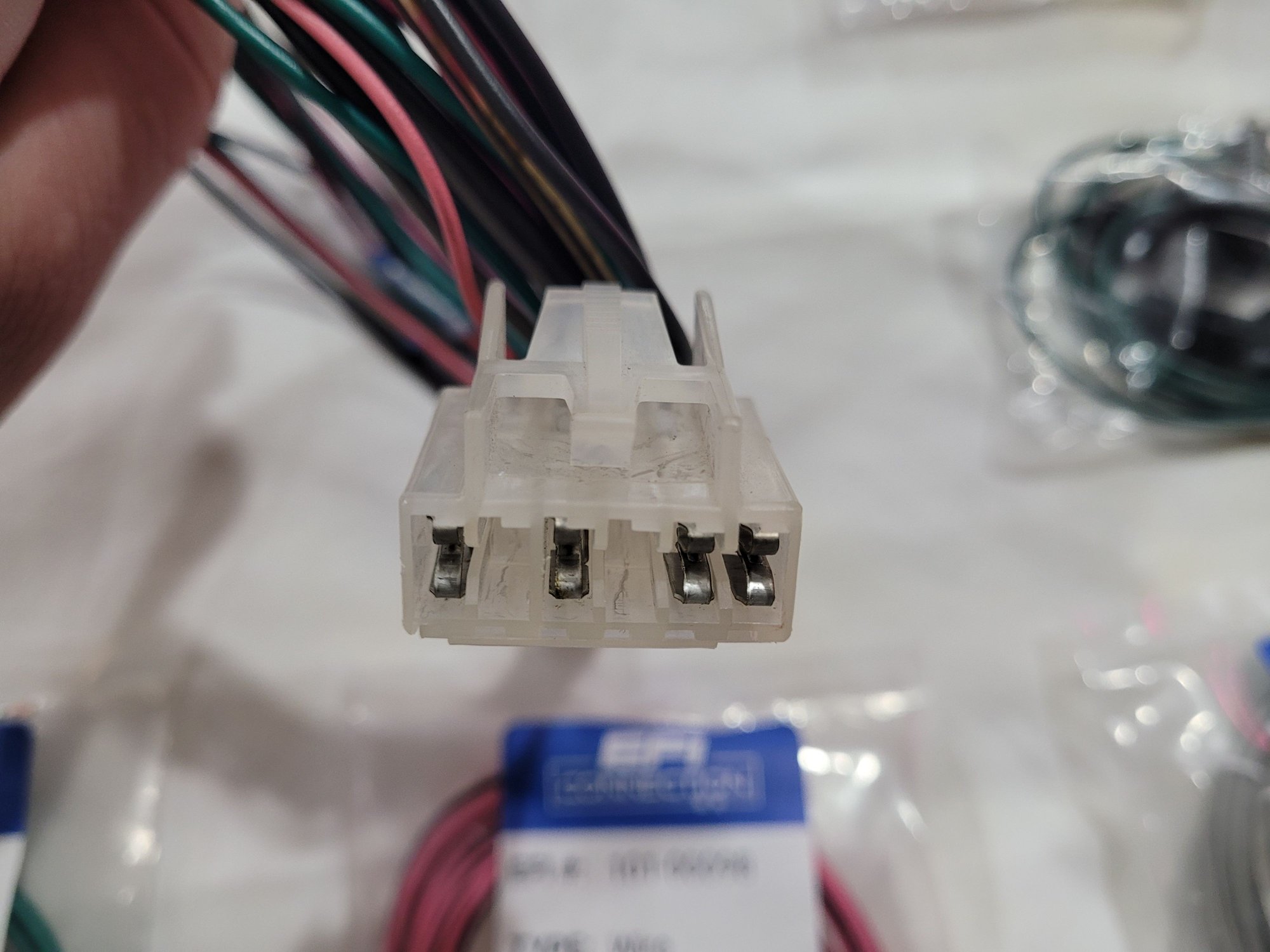

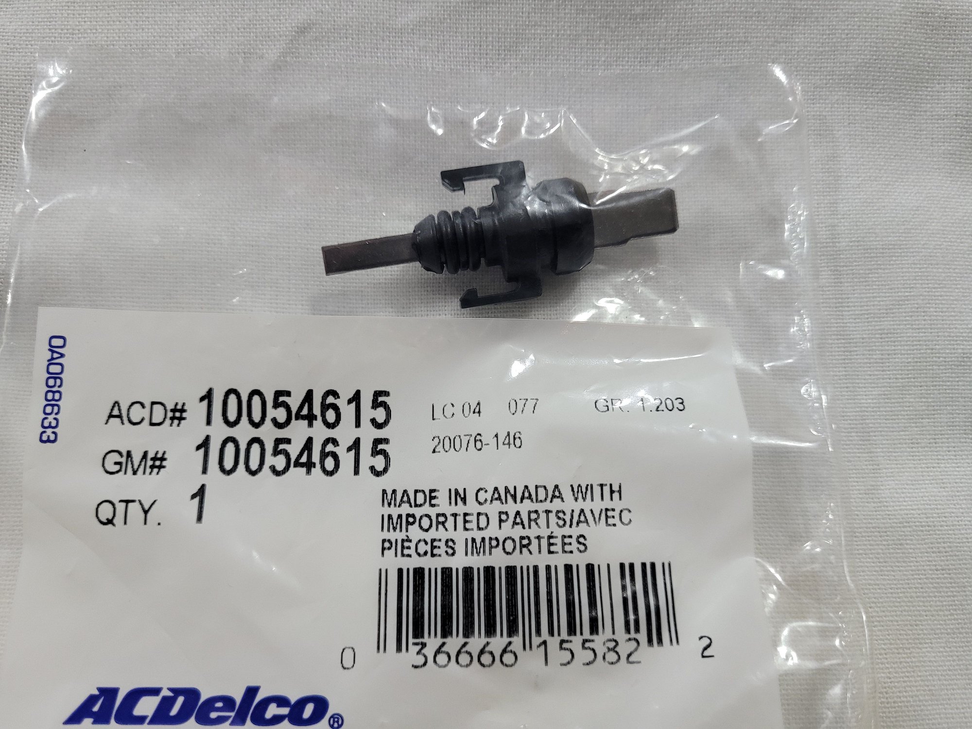

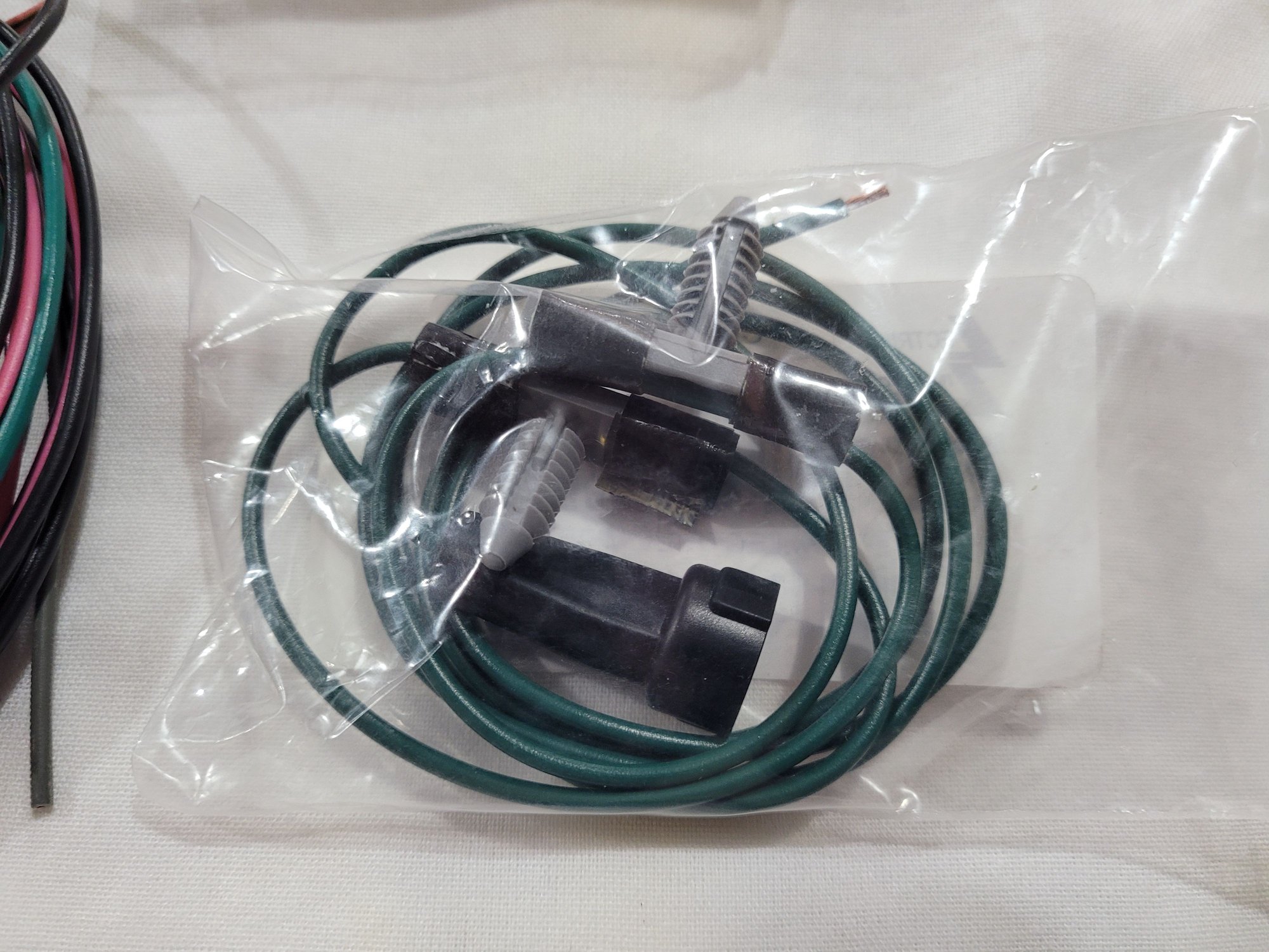

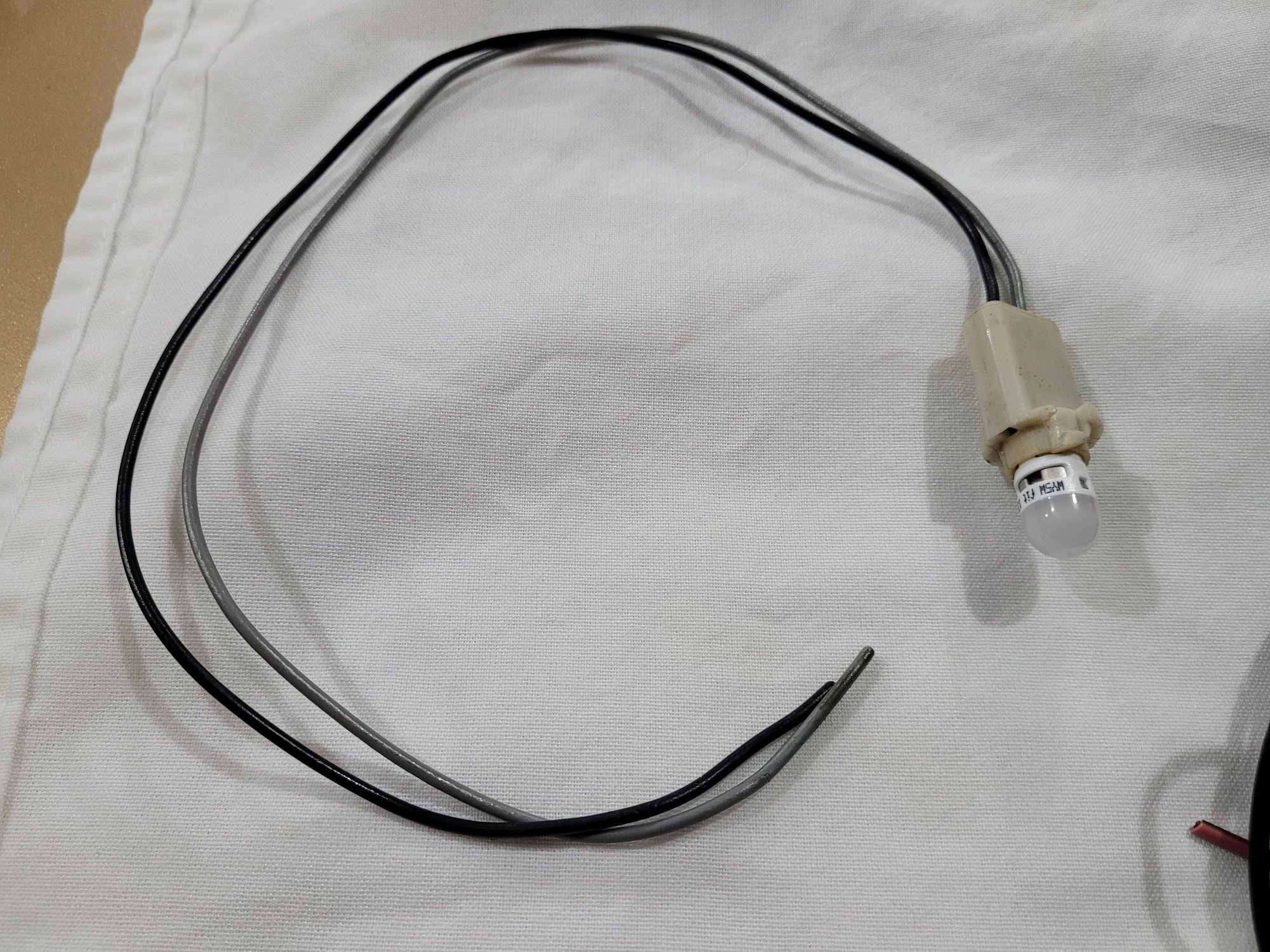

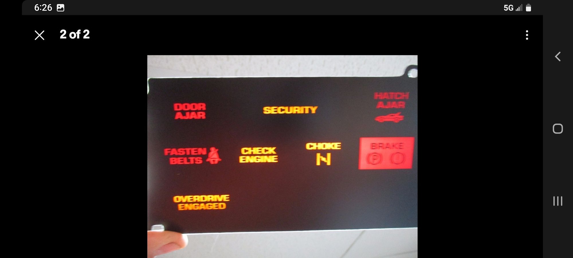

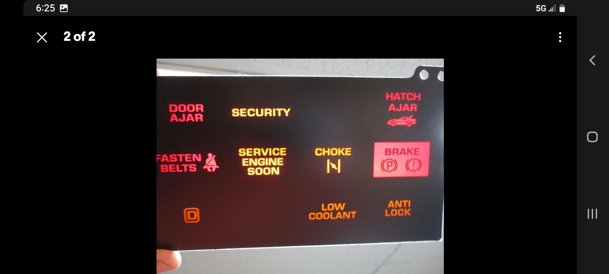

Ironically, I'm in the same situation....and I can't help myself, I like upgrades...especially ones made by the manufacturer! I bought a DeWitt's radiator and it has the same provision for the probe...so I figured I would make it functional! It is in my pile of circuitry to add to my '84 (EBL Flash II, IAT sensor, Trans Temp gauge, AFR gauge, Fuel Pressure gauge, Passenger Power Seat and Switches, VKE-1000 Keyless Entry, etc.....) All of the above is great information! In the photos below you will see what I have collected for this circuit. I can tell you the information center (tell-tale) filter/lens is the same for '84 & '85 and then '86 & '87 are the same ('86 is the first year of "low coolant" light, as correctly stated above)...It just so happens that there is a light bulb hole in the earlier information center housing in the correct spot, but there is no contacts on the printed circuit board for this hole...this is a good thing, this makes it easy to wire it in independently, using a bulb socket with wires instead of contacts (example of a source for this, the gear indicator plate/housing light bulb socket & wires). I think it's cool to add stuff like this, and to know I'll likely have one of very few '84s with a "low coolant" warning light! If you're not interested in adding this circuit, I would suggest that you buy the correct probe anyway and use it to plug the hole...that's what it was designed to do as far as sealing that hole and holding up against leakage. Good luck with whatever you decide to do! For anyone in the future who might be researching this topic to perform this mod, hopefully these pictures and the part #s above help you out...I believe it is every thing necessary to complete the job👍
Sourced from Lectric Limited.
Probe pigtail sourced from Lectric Limited.
Sensor/Probe.
Sensor/Probe.
Factory module/wiring, sourced from Forum member AZSP33D...a super great guy!
Bulb socket pigtail sourced from an extra center console wiring harness I had in my extra parts bins.
Bulb socket pigtail for information center, sourced from an extra center console wiring harness I had in my extra parts bins.
Example of 84 & 85 filter/lens.
Example of '84 & '85 filter/lens.
Example of 86 & 87 filter/lens. Notice all icons are in the same place as the earlier version (some icons changed visually, but are still for the correct warnings) the only other difference is the addition of the
Example of '86 & '87 filter/lens. Notice all icons are in the same place as the earlier version (some icons changed visually, but are still for the correct warnings, and the security went from 2 spots to one) the only other difference is the addition of the "low coolant" and "anti-lock" This filter can currently be had from an eBay seller (no affiliation) for $19 + s/h/tax...search '1986 corvette information center lens'....something to that effect!
