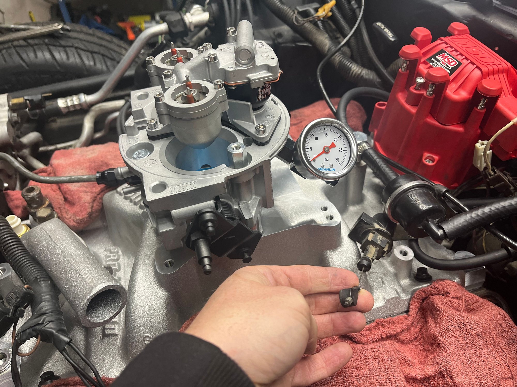

I am in the process of converting the Crossfire to a Single TBI on a Holley intake. I am seeing two issues at the moment. 1. The Kickdown cable doesn't seem long enough is there a easy reroute or another cable solution? 2. I need a bracket for 3 cables, the throttle, kickdown, and cruise control. Does anyone have a bracketing solutions. Here's a couple of pics to help. Any help would be greatly appreciated...

I used the bracket that came with the intake. It looks kinda like this but it has 2 holes that mount it to the pad.
