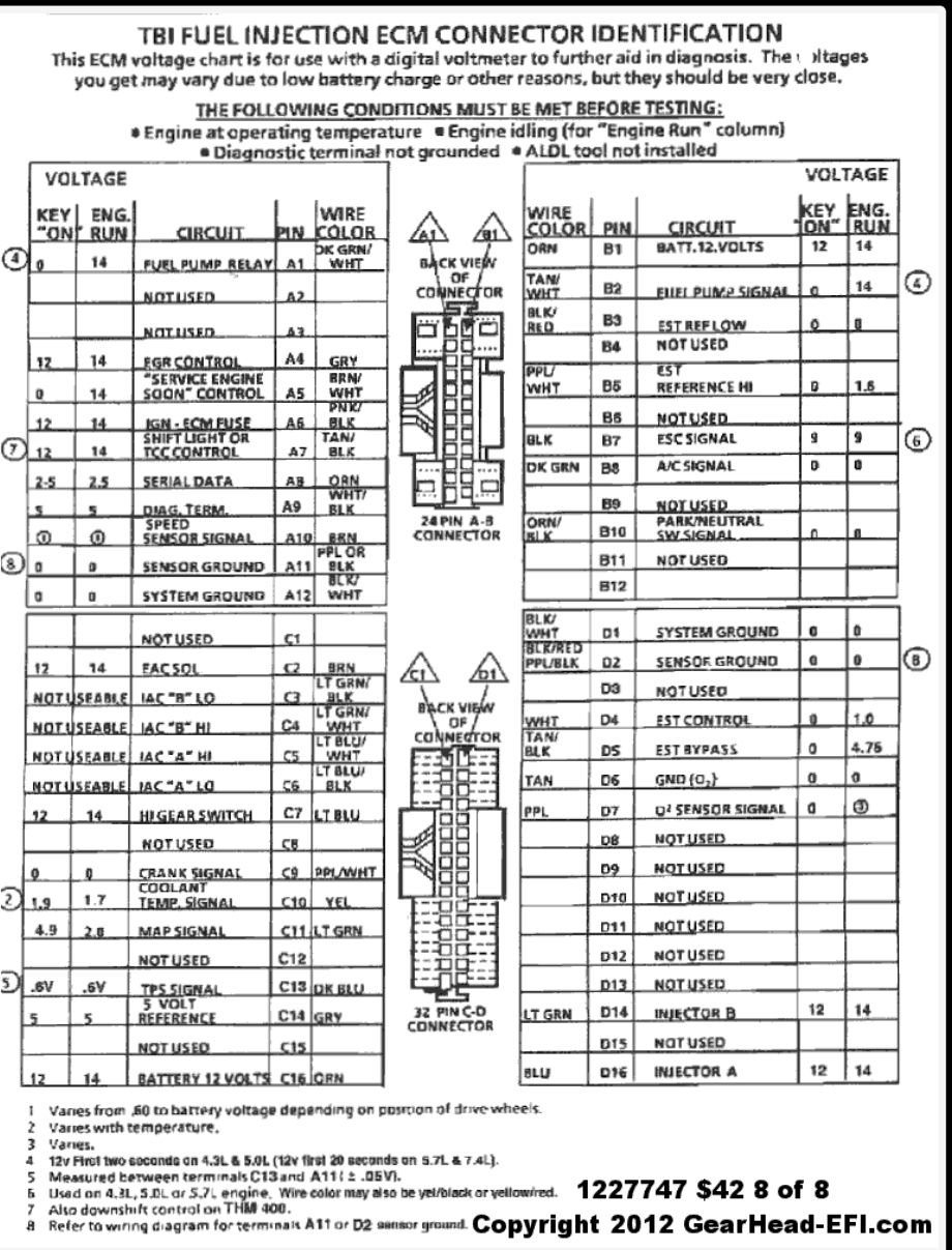

This is the 747 pinout, I have some connectors but terminals can be found on eBay
https://ebay.us/m/gGRRyc

Here's the pin out conversion going from the stock 84 harness to a 7747 harness
Black harness:
1 - C9
2 - B5
3 - B3
4 - C10
5 - C13
6 - C7 4+3
7 - C1 nu
8 - D7
9 - A3
10 - D5
11 - A11
12 - C4
13- C3
14 - NU (C2)
15 - D6
16 - NU
17 - C5
18 - C6
19 - D4
20 - C11
21 - C12 or NU
22 A4
White harness:
1 - N/C
2 - A10
3 - A9
4 - B7
5 - B10
6 - N/U
7 - A8
8 - D14
9 - D15
10 - C16
11 - C14
12 - A12
13 -D1
14 - D2
15 - B1
16 - A6
17 - B2
18 - A1
19 - A7
20 - A5
21 - B8
22 - C7 TCC auto
23 - NU
24 - NC
