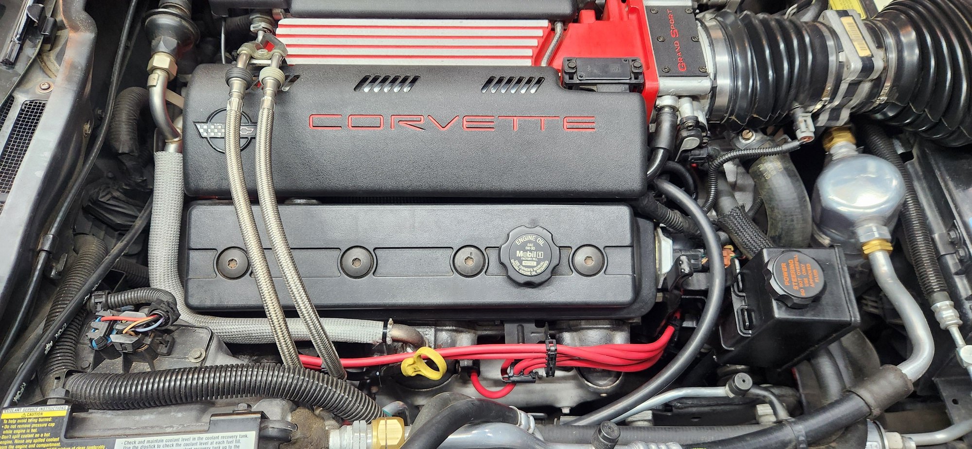

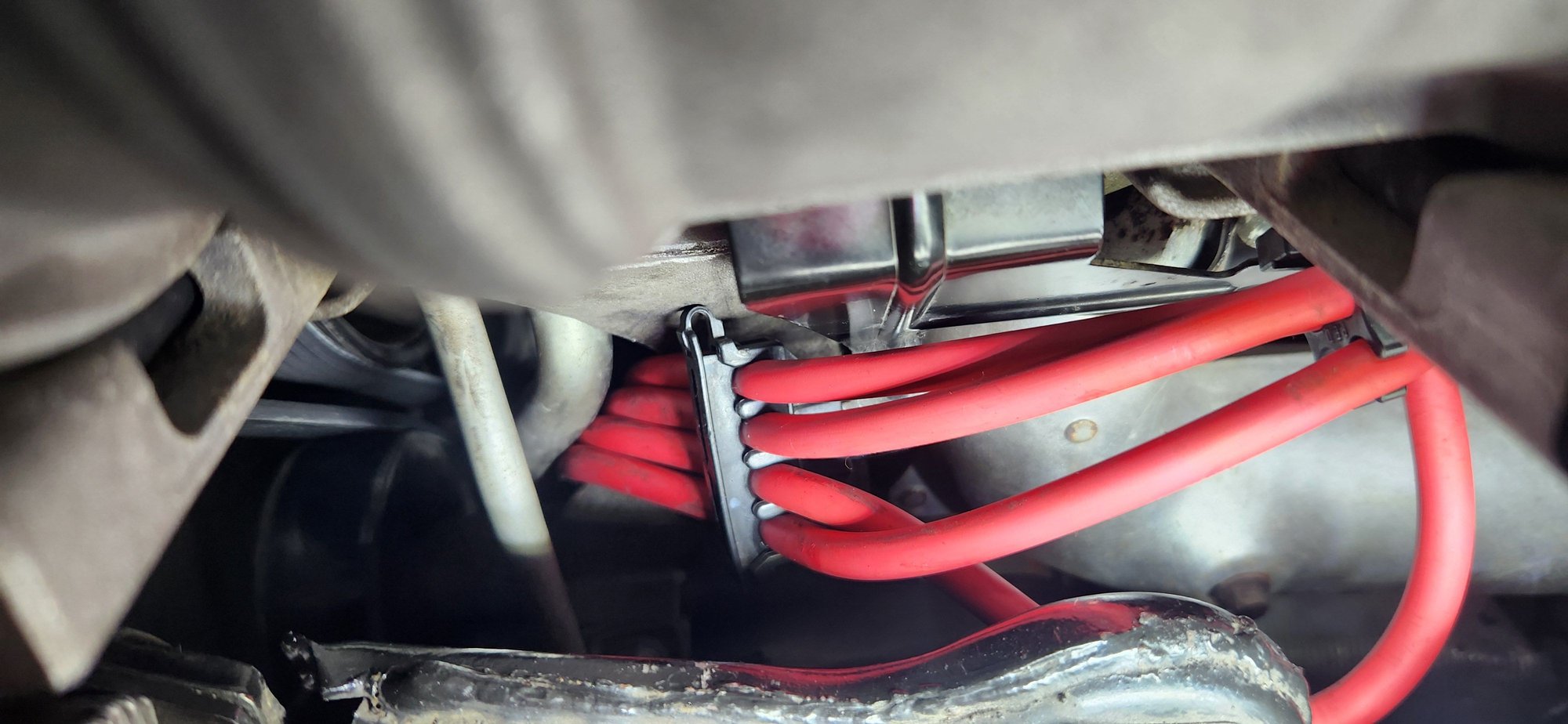

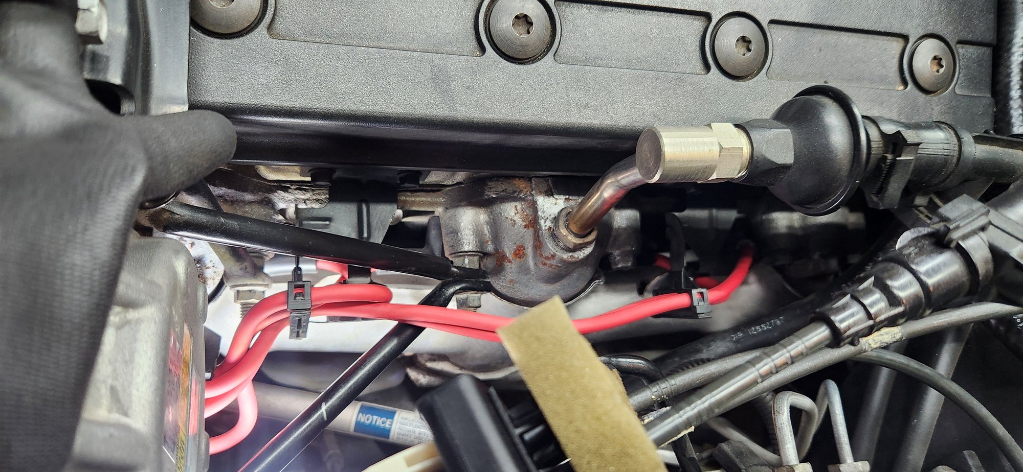

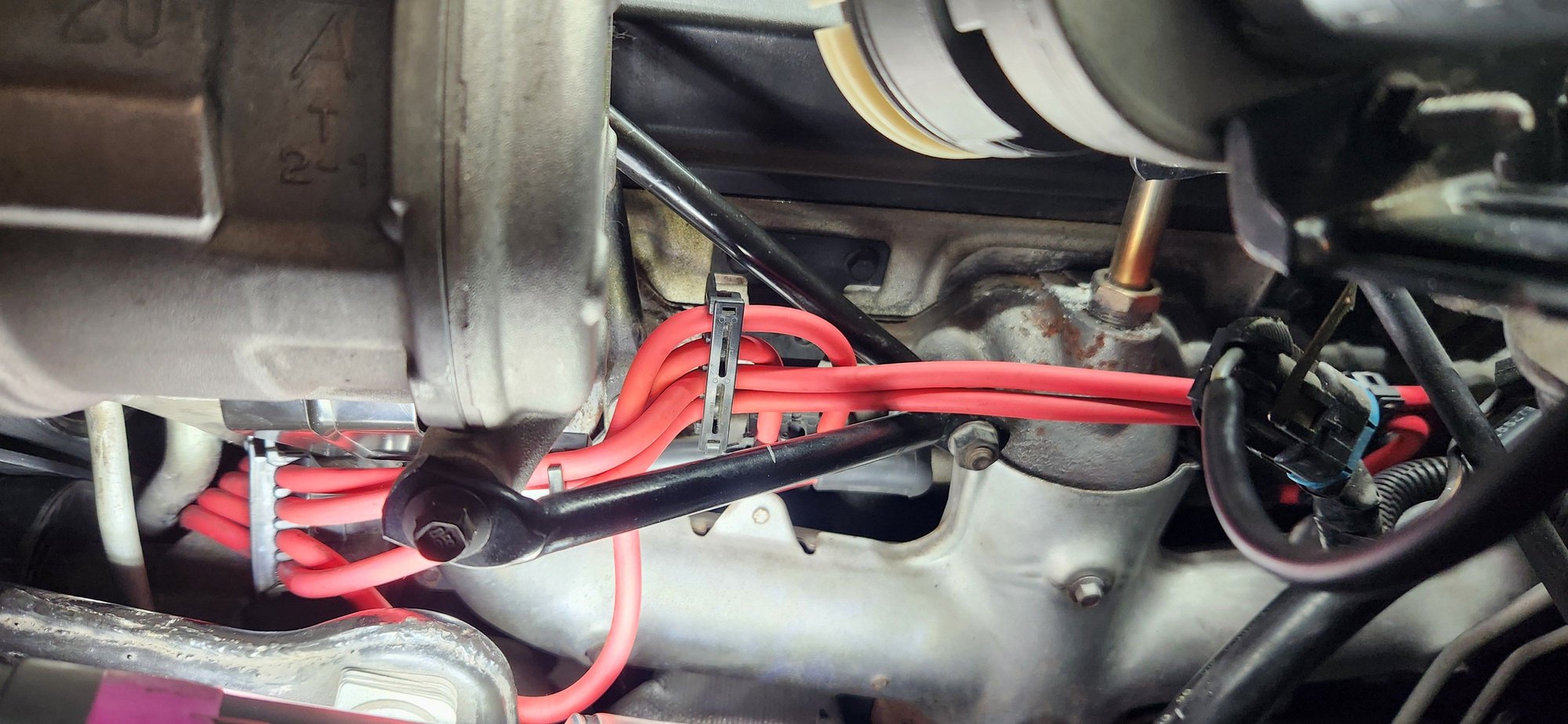

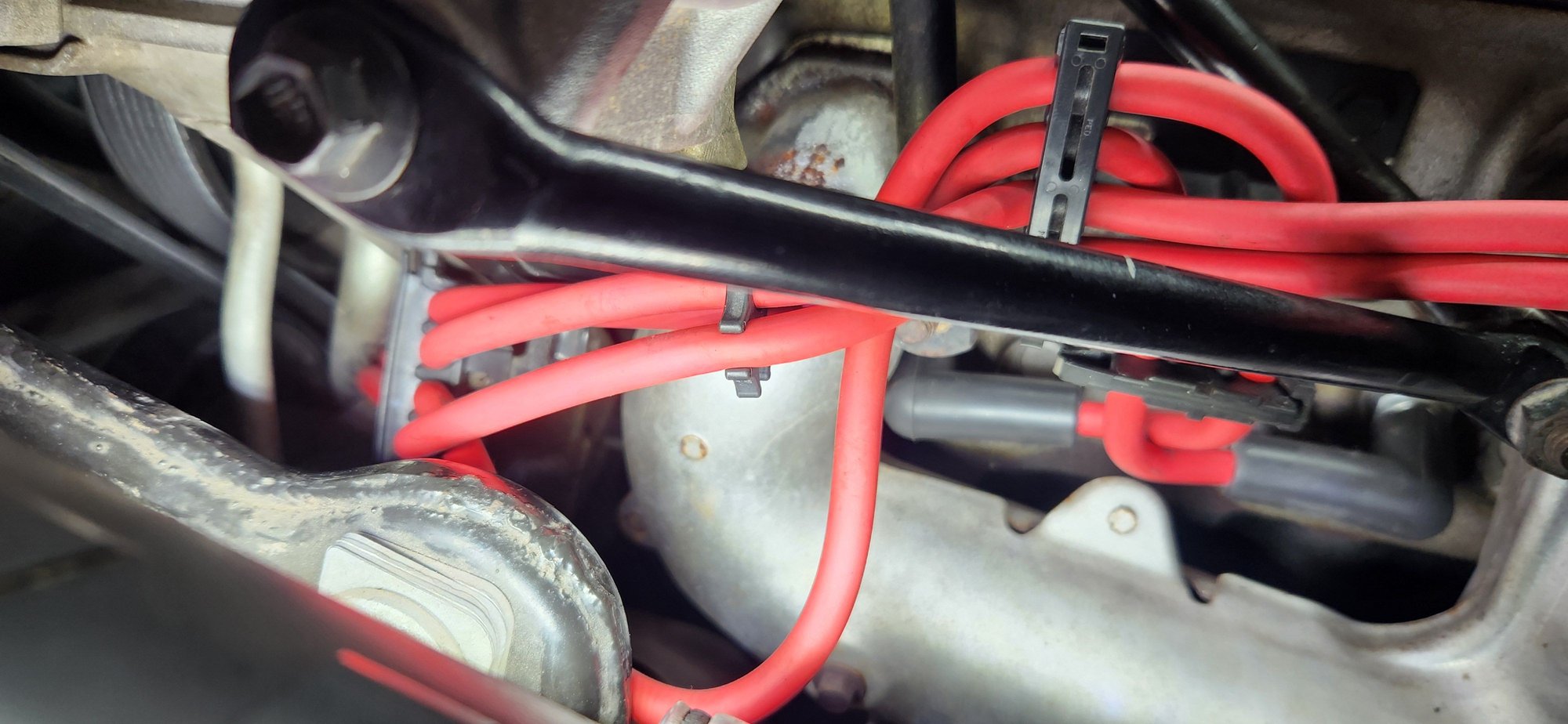

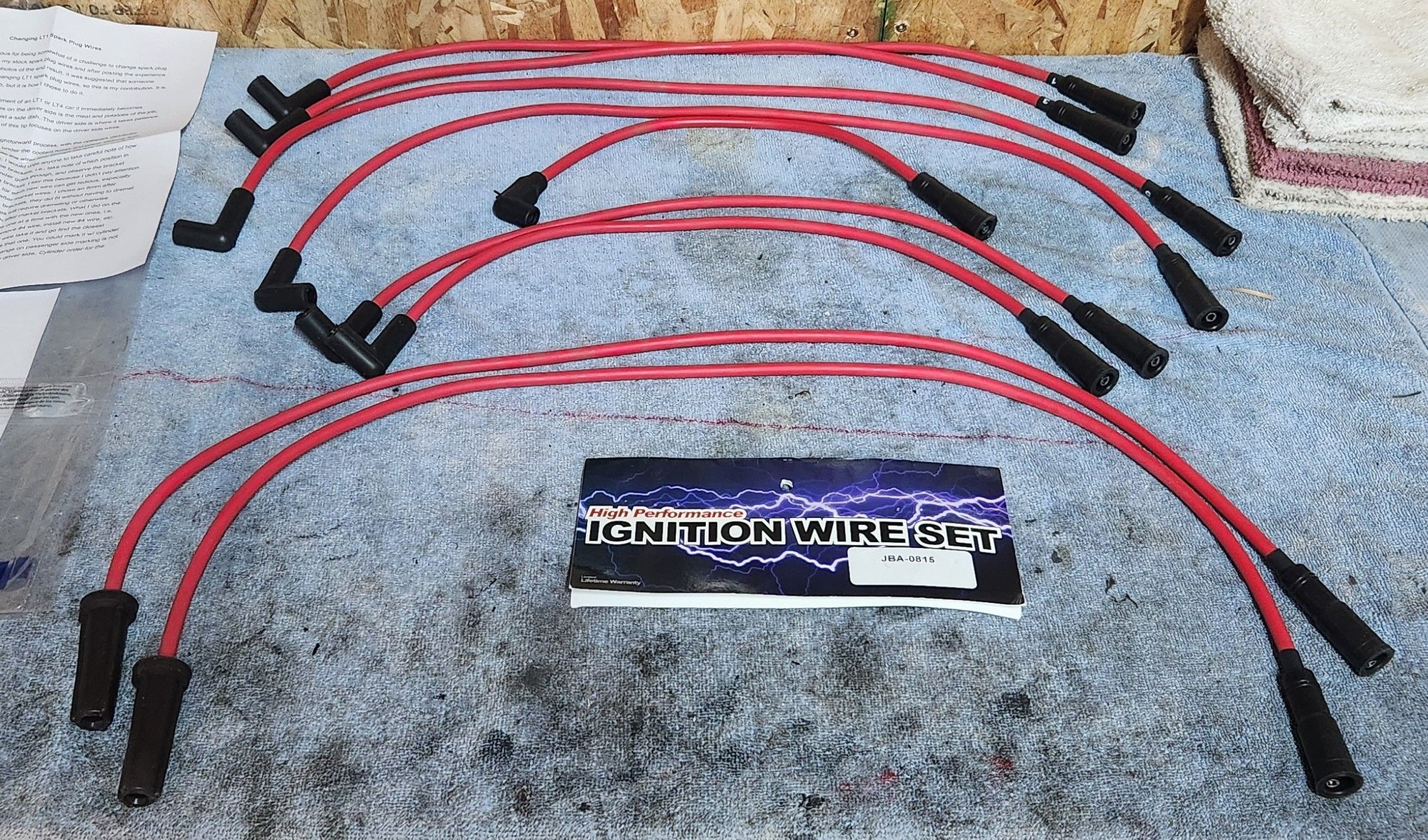

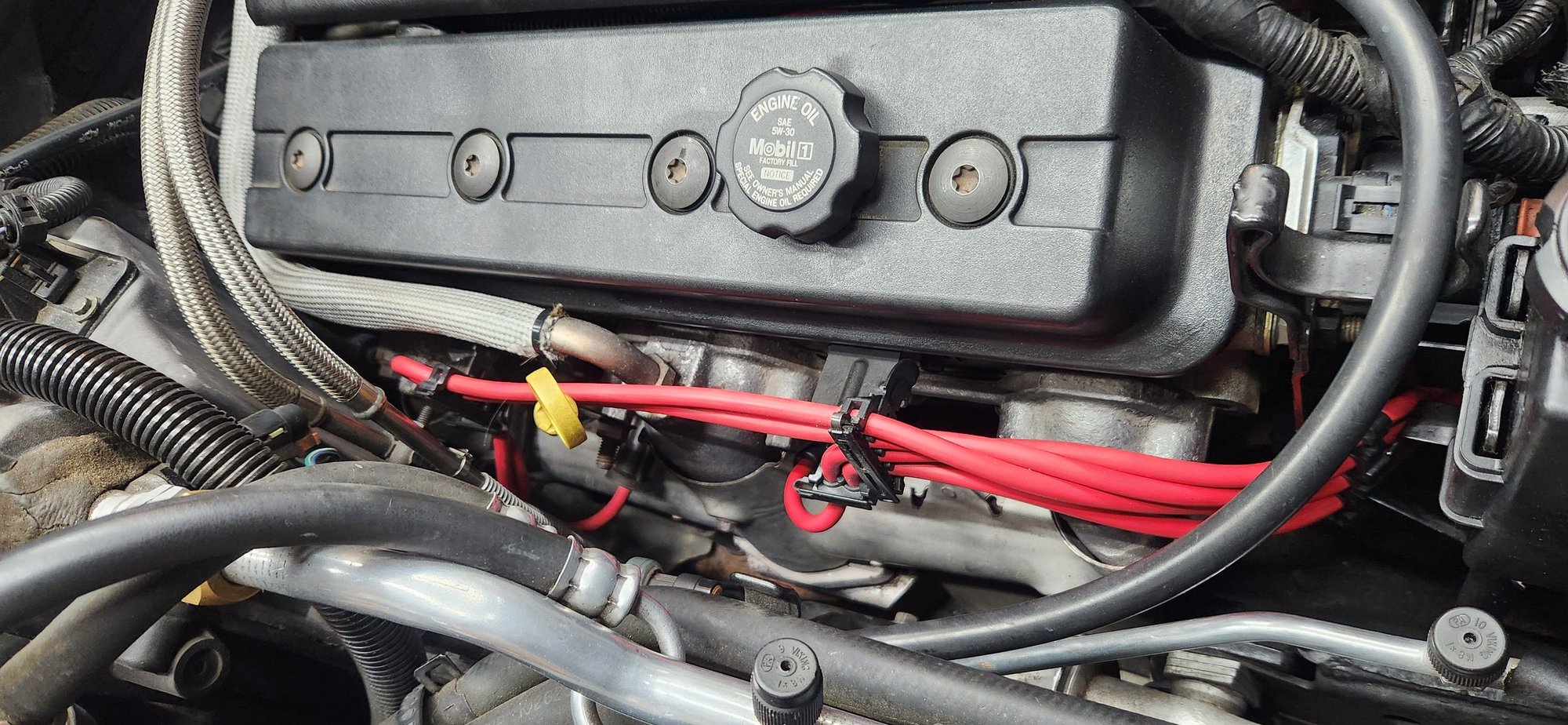

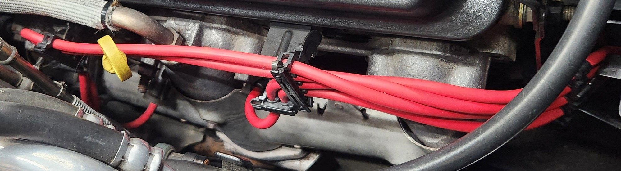

@powerplaytwo I bought the JBA 8 mm red wires and am pleased. They are individually numbered and are the exact lengths as the black AC Delco wires. They fit perfectly in the looms without modifying anything. The only snafu is the coil wire, the i.d. of the 90' elbow is simply not large enough diameter to slip over the coil terminal/housing.The shop that switched out the original red wires for the black AC's for the previous owner left the original red coil wire, so i used it. Will go to AZ tomorrow and see if they have a larger i.d. 90' terminal for the JBA coil wire. Installed JBA's on the passenger side, all straight forward. Saved the fun side for the project's final curtain. Attached are pics of the JBA wires, they have positive reviews on the internet. #8 and #6 on the middle and rear looms need to be reversed so that twist isn't there as seen in front of the middle loom, Grrr. Still need to see if AZ has a cover for the coil end of coil wire so i can have all wires 8 mm.

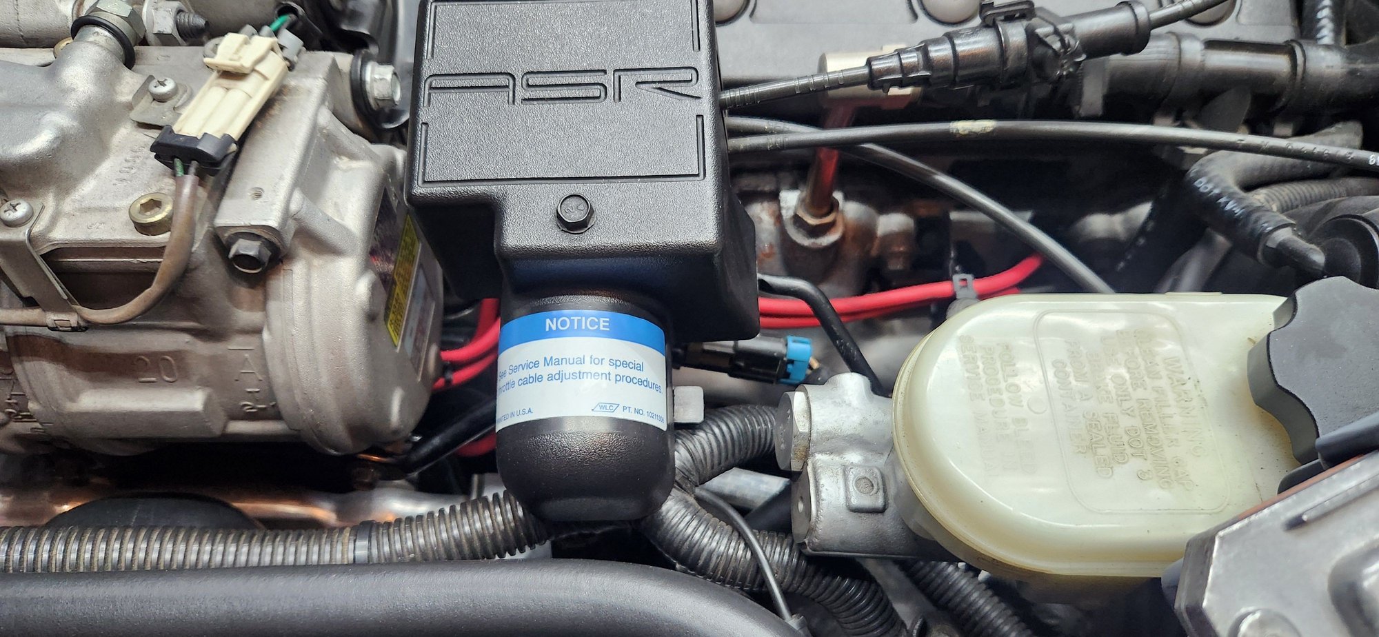

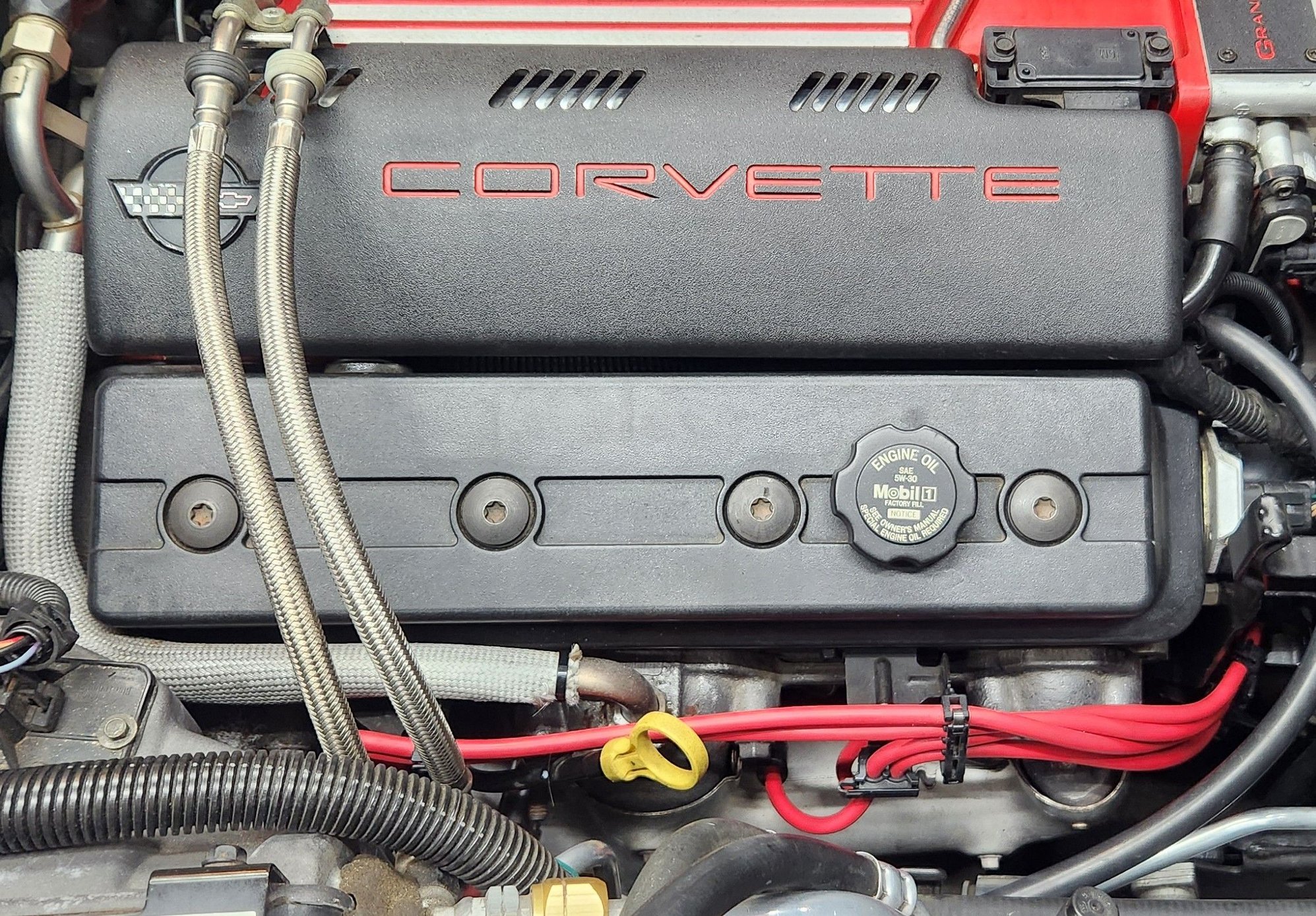

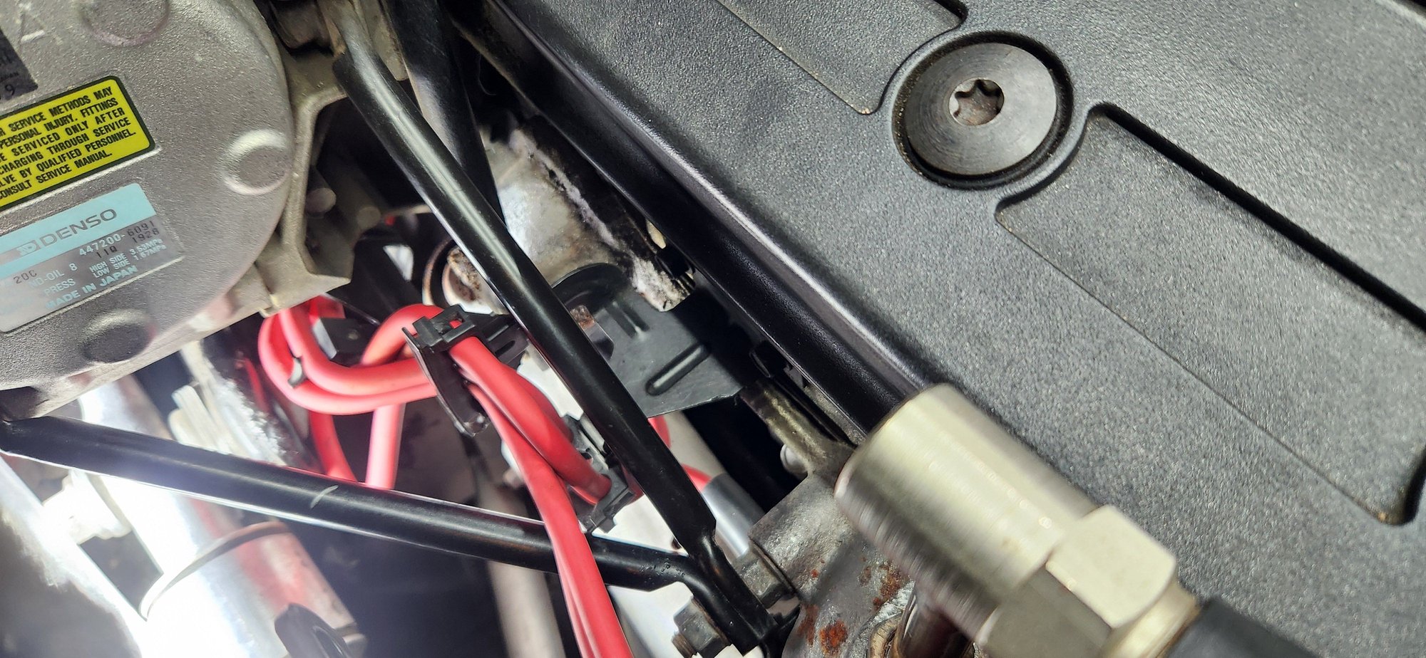

Finished the driver's side today. The #7 wire was longer than it needed to be, otherwise the other three were the necessary length. The 8 mm wires fit the looms without difficulty. Clipping shut the looms were no problem. Long needle nose pliers and a ring plier made the job easier, especially for making the double-click on #5 and #3. The long needle nose and a long screwdriver helped me push the opti ends of wires one at a time through the eye of the needle and guide them through the lower opening for the wires to travel to the opti. The ASR was the only thing i moved out of the way. Also removed the middle and rear inner fender shrouds. Wires on both sides are a nice distance from exhaust manifold, i did not use any heat protector sleeves, althouh i have some Thero Armour silicone coated fiberglass sleeving on order. The shop that had replaced the red for black wires hadn't used sleeves either, although i would think the factory fitted sleeves... Actually took about the same time as passenger side, around 7 hours. Patience, persistence and perseverence, lots of pictures are key. Really not that difficult, just takes time. Feels good to have red like original wires instead of black.
