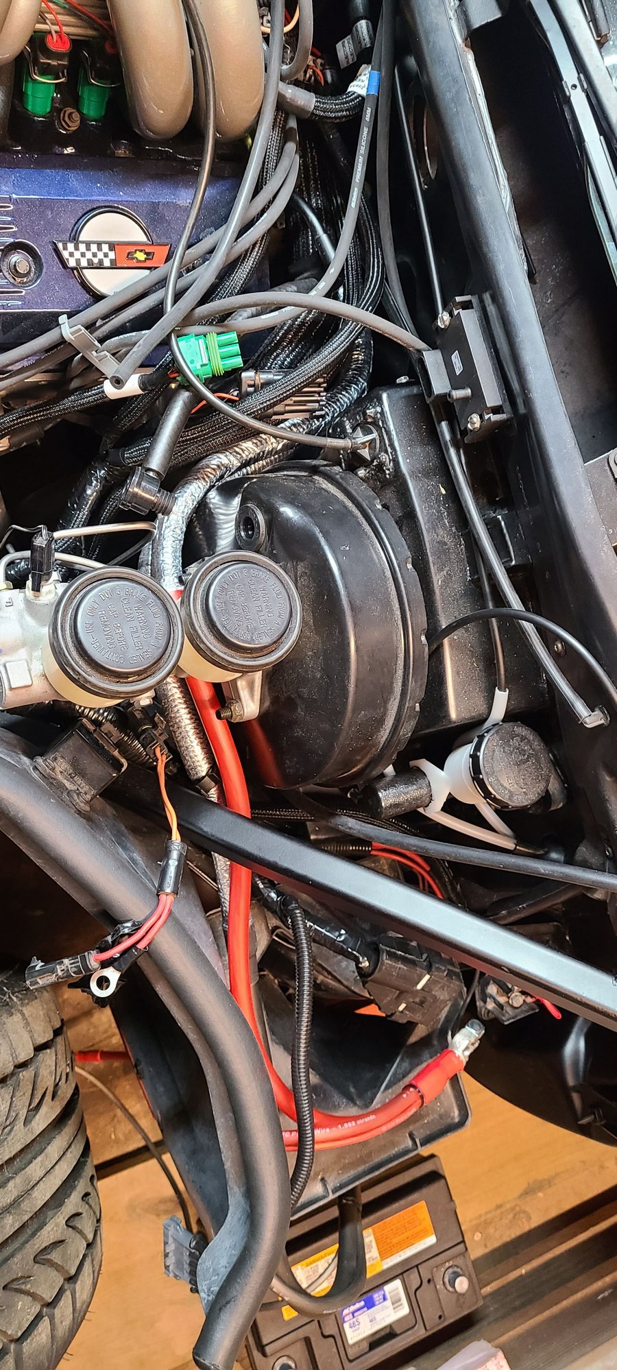

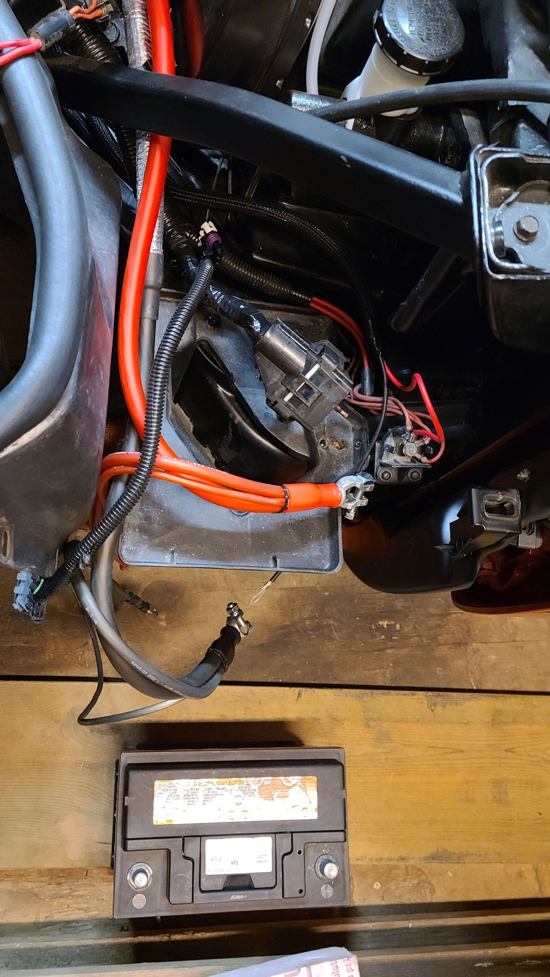

I have purchased cables from CE Auto Electric for my C4 - they do a great job and I was really happy with the cables. Looks like I didn't take that great of photos, but here's what I have from when I installed them. These were 1/0 AWG cables and for the ones running to the fuse blocks I used #4. Routing them was a little challenging since they are a bit larger than the originals, but it did work out fine after a little bit of messing around.

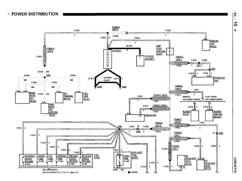

I was really deep into rewiring when I did the positive cable, so I built my new harness around 2 fuse block from like a 95 or 96 C4 (they eliminated the jump start junction block and replaced it with 2 fuse blocks in the later year cars). Also I'm not running the original computer anymore so that eliminated fusible links D and H in my car.
What I think you would have to do is either have a connector or splice before those 2 fusible links (D and H), or else the fusible links would need to be a part of the new harness. I seem to recall there being several weatherpacks in there but I don't remember which side of the fusible links they are on.
1986 Power Distribution Diagram

They should be able to fabricate and duplicate OE configuration for you in any fashion that you specify. You just need to specify pigtail details mentioning fusible link and terminations you desire. Ideally you would lay yours out, take snapshots and measurements and get them to acknowledge they understand. I'd think 1.0 ga a stretch and they should agree. You need to maybe be just concerned with number of strands and quality of them. Is your + cable in reasonable condition that you could lay it out, measure and provide details? Tey should have and understand any fusible link stye that interests you and tidy fabrications.
