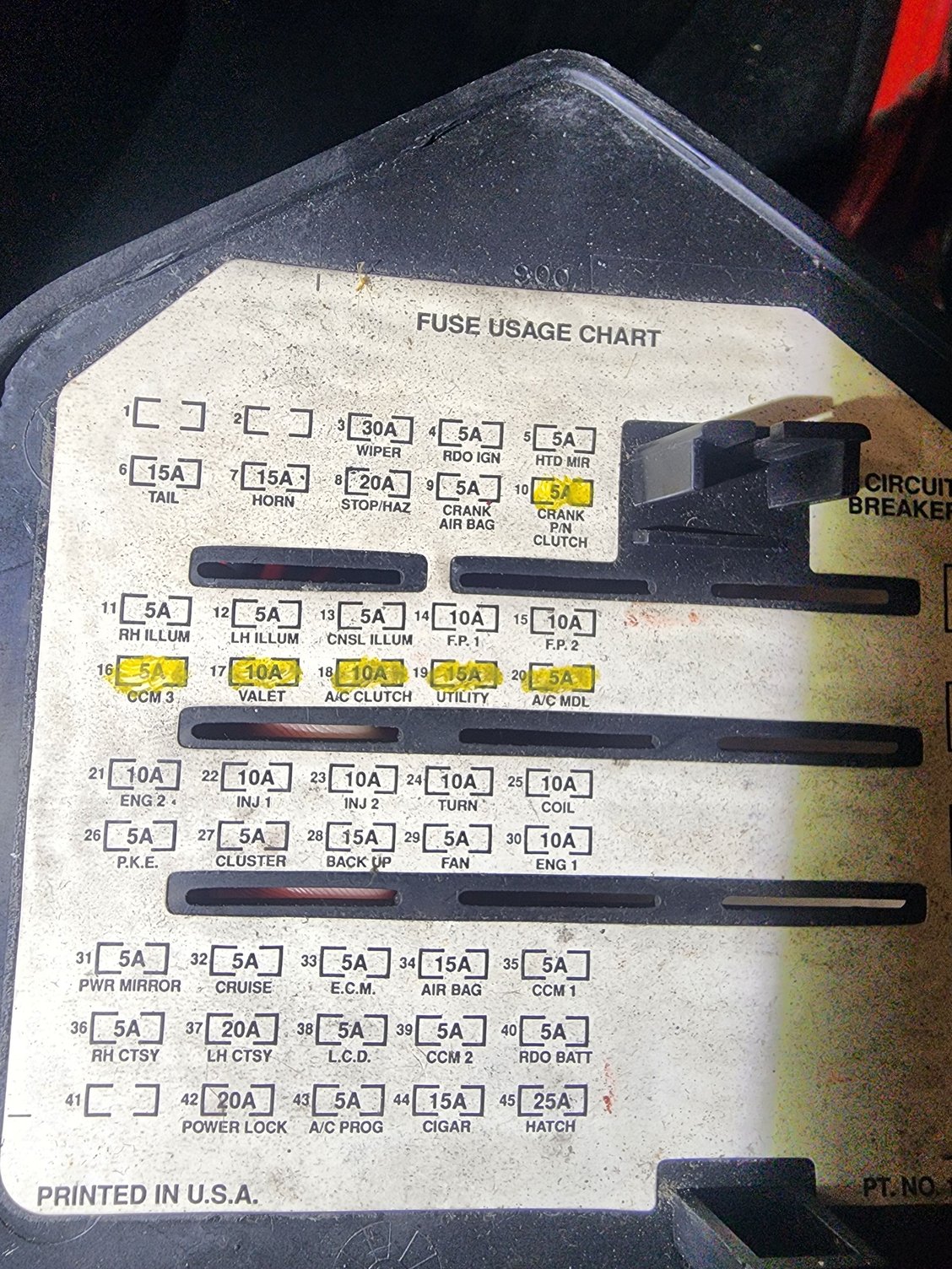

I did a voltage check on all fuses attached is a photo of the ones that display no voltage with ignition on highlighted in yellow.

Every one of those (5) fuses in a row is supposed to be hot with the key in RUN. Note that one of them is CCM1!
That row is fed directly from the ignition switch on the orange wire at the switch. The hot at all times feed to the switch comes from Under Hood "Ignition Fuse 7" which is 40 or 60 Amps depending on which page I look at.
You could have a bad ignition switch, but doubtful. More likely a bad connection of the orange wire at the switch. Or there has been or is an aftermarket Remote Start system that has compromised this wire.
Try this: Turn the key to RUN. With a jumper wire, jump the left (sitting facing the fuse box) hole on fuse 16 to the right hole on fuse 8 stop/hzd. This should energize the entire 'dead' row. The CCM may come to life, and hopefully the LCD as well.
I say may because no CCM functions with the key OFF suggests that there is no power to the CCM from fuse 35 or 39. OR the ground for the CCM is open. The CCM grounds at the RR of the engine on the upper bellhousing bolt. Blk/wht wire.
It's looking like there are multiple problems. Why was this car sold as "non running"? What is the history that led to the PO 'giving up'? What is the general condition of wiring and things? Is this car a basket case with **** hanging out of it everywhere, or is it generally intact? Sorry for all the questions, I can't see it from where I'm sitting at my desk in California.

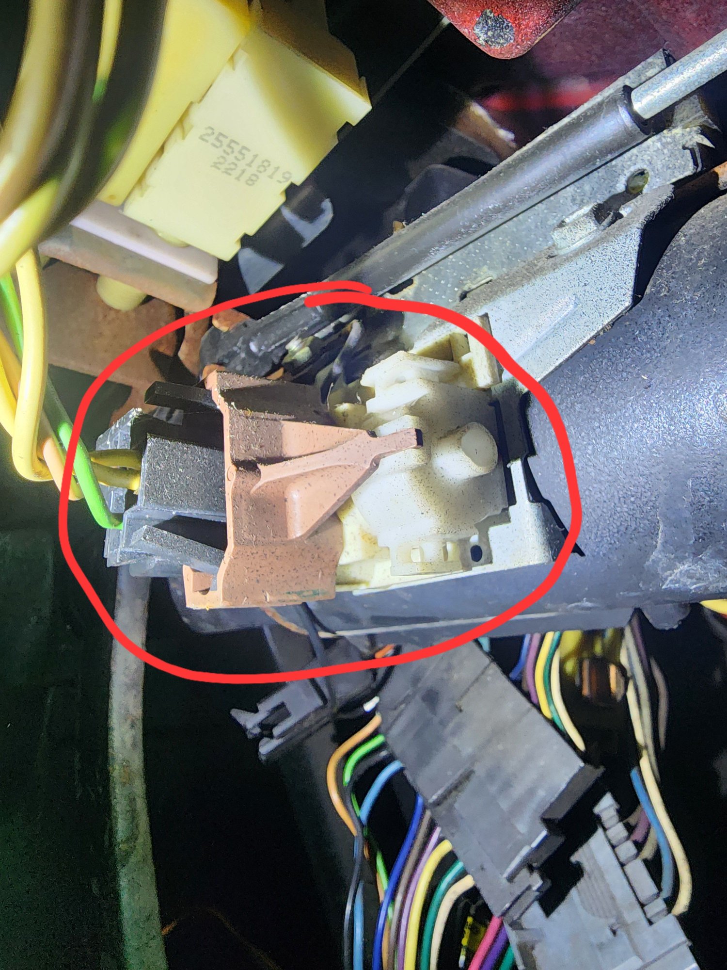

Also, side quest. But does anyone know what this does. Left side of the steering column you push and makes an tactile click. Wires coming out of it appear to be going to the side of the halo where the lights aren't working.
Thanks
Edit, it's the high beam switch the rod for it is just missing. Duh.

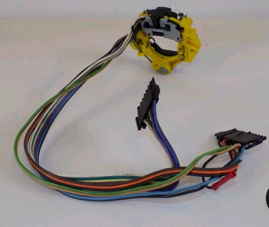

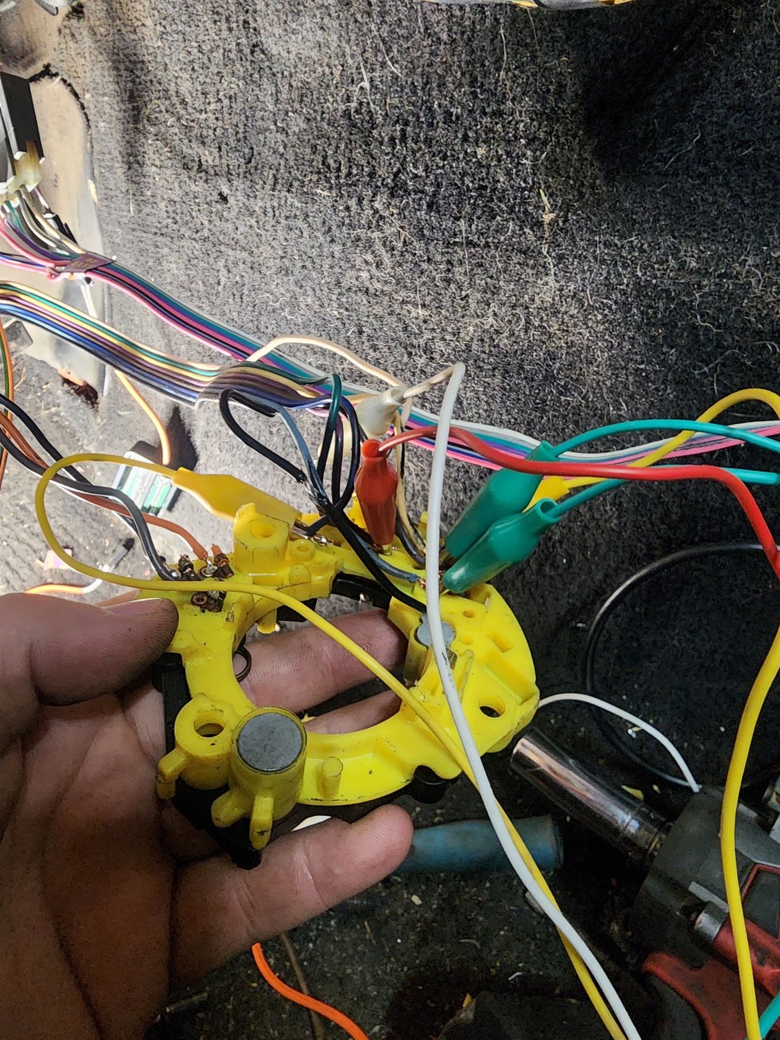

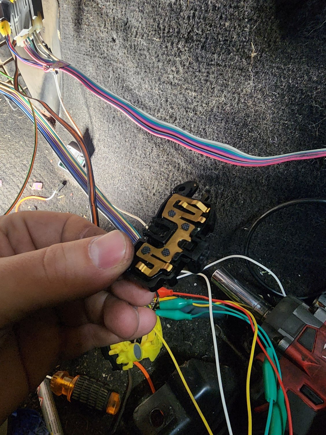

Ok update. I was able to get the green turn signal indicators to come on. The way I did it was a serious shot in the dark. I didn't get the screen in the halo to turn on yet but I feel I'm on the right track. I took apart the turn signal switch because it has a copper bar inside that connects a bunch of different wires together and a spring and some other things. I don't know what all these wires do so I was nervous about randomly jumping circuits together. (I have a replacement coming tomorrow morning)
I removed the copper junction and placed 7 individual jumper wires on each soldered terminal. I jumped one to another (this is the shot in the dark because I don't know what controls what). The turn signal came on. I didn't go any further, I didn't want to risk burning something out before the replacement comes.
​​​​​​Below are two pictures, one of my jumper wires on the turn signal switch and one of the copper bar that seems like it's supposed to join terminals by resting on top of them.
The question for someone more knowledgeable than me. Because I forced the green flashing arrows on is this a good indicator my ccm is functioning?

That yellow thing is the turn signal switch. With it unplugged, the turn signals won't function.
Not at all. The green arrows are not controlled by the CCM. They are just dumb light bulbs wired in parallel with the front turn signals. Lt blue (left) and dk blue (right) wires. My asking about the green arrows' function was to ascertain whether the cluster was plugged in, and if it had a ground. If yes, then the blue high beam check would be valid for the CCM because the blue indicator shares the same ground and connectors as the green arrows.

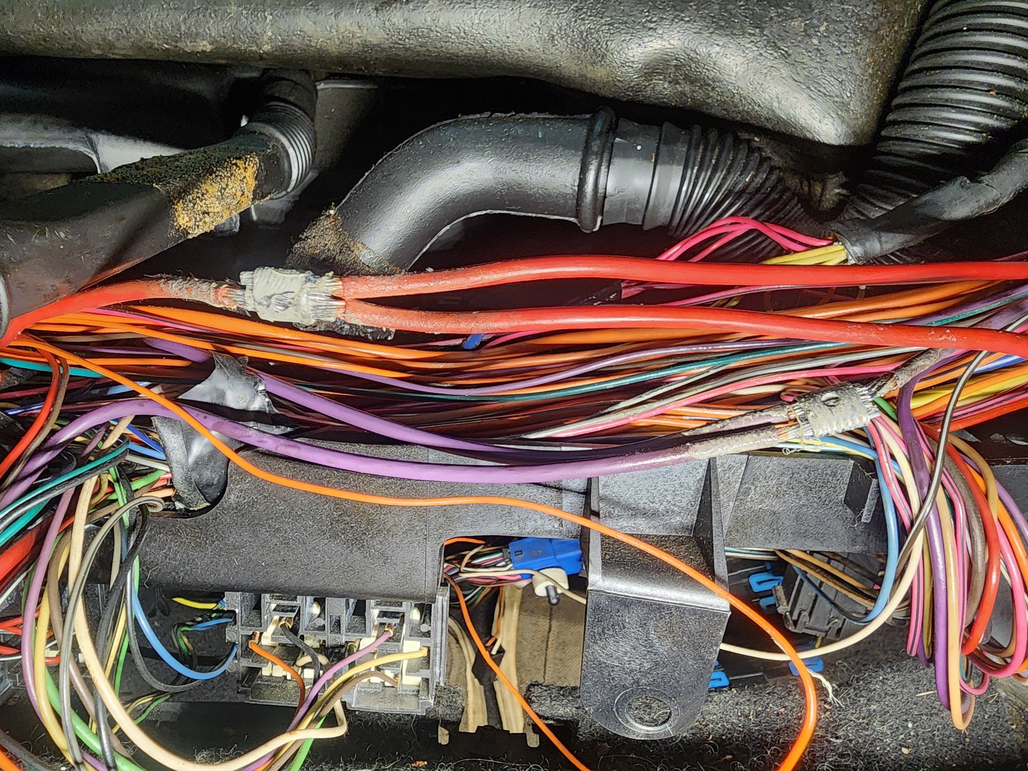

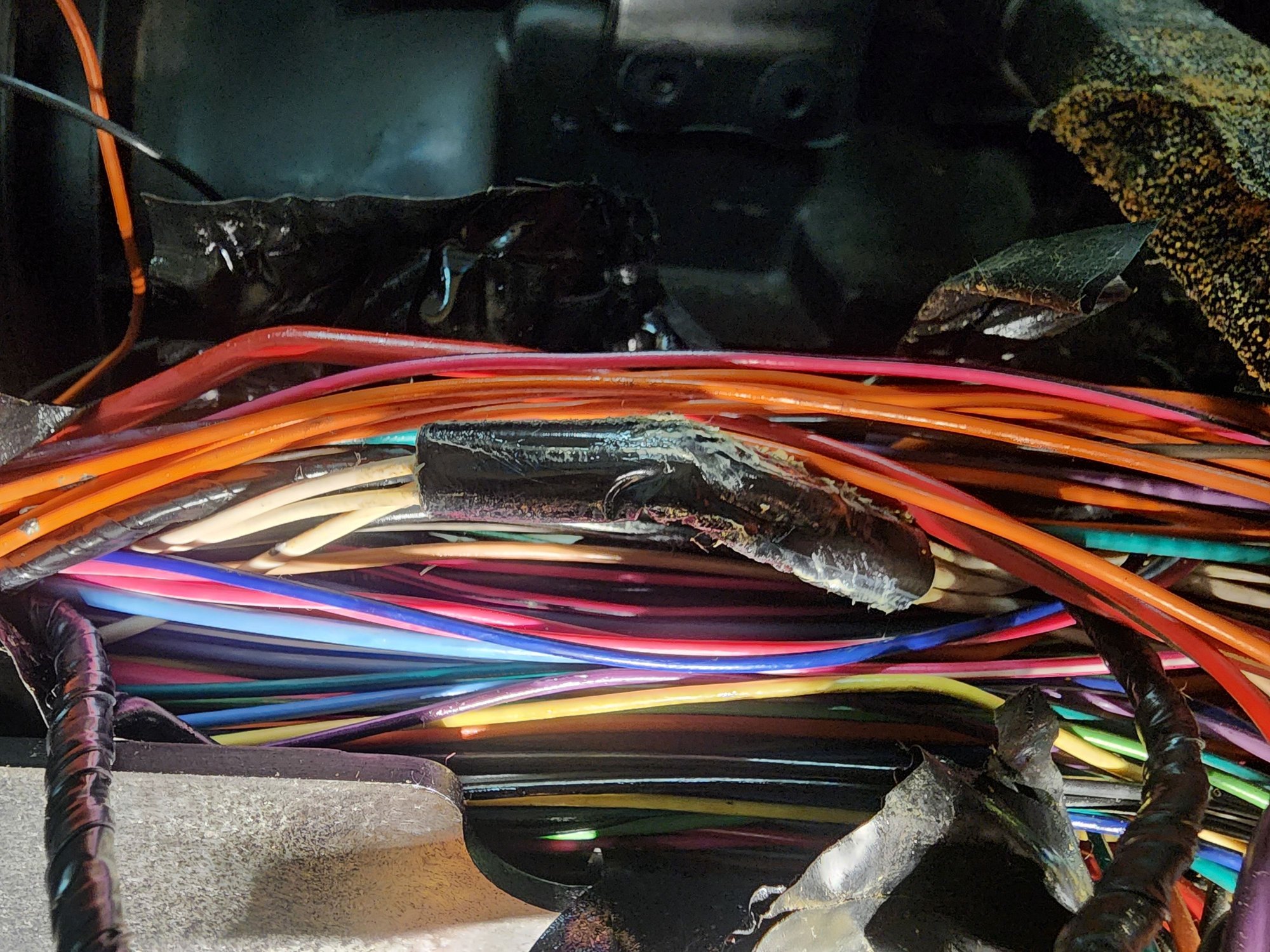

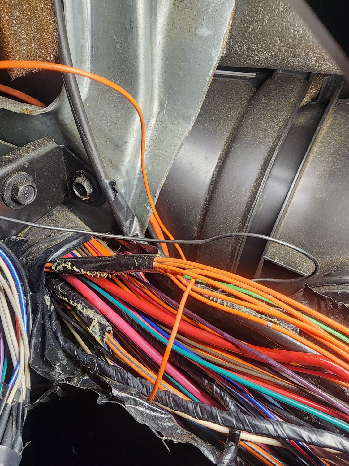

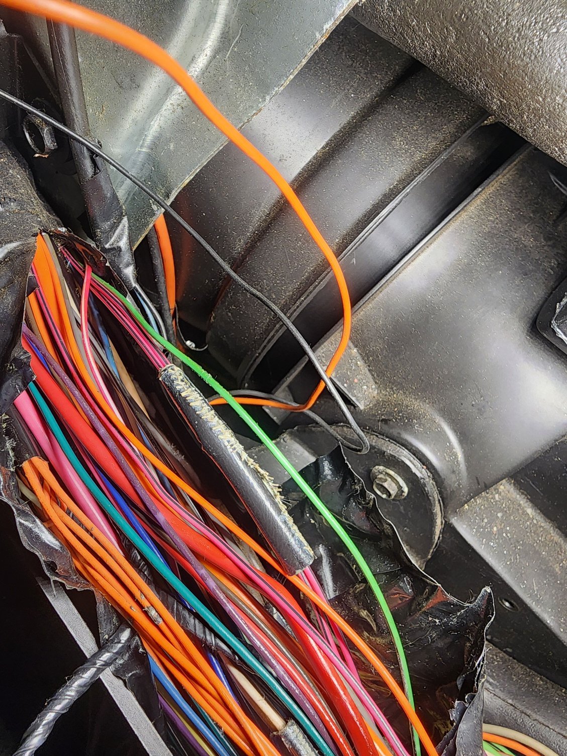

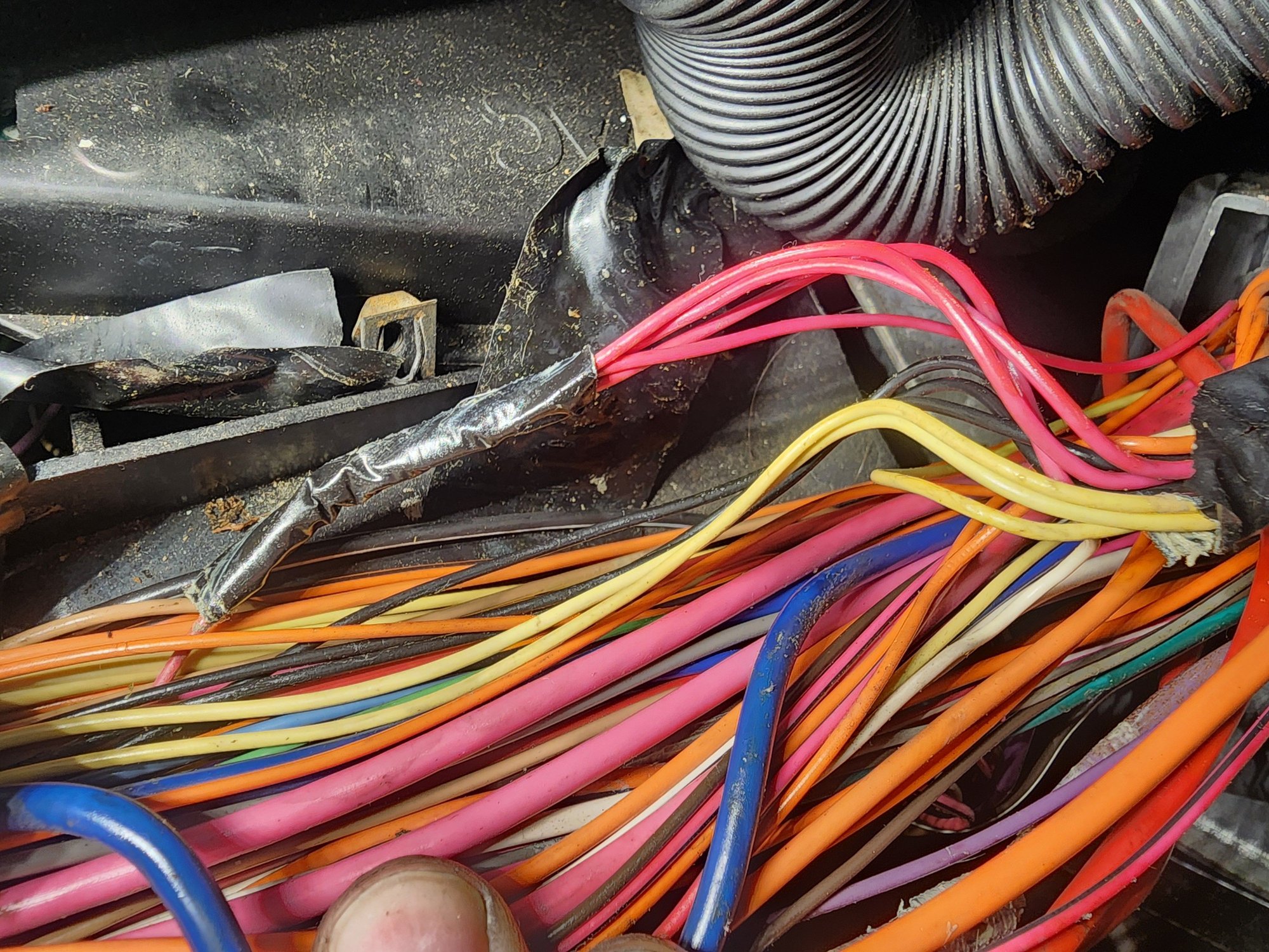

Update. I took your advice and inspected the whole harness inside. I got sick of guessing and squeezing around so I pulled the whole dash. Finally, good visual access to everything I should need to see. The harness isn't cut up or mangled anywhere. One non factory splice has been done on the thick red wire coming into the firewall left of the brake pedal (first picture). Whatever accessory previous owner was trying to run from it no longer exists. The 3rd leg of the splice has been cut off.
Second order of business. Follow the thick orange wire from the ignition switch to the fuse panel. Here's what I found (second picture) the orange wire is actually running into the row of fuses below the dead row. Getting a good 12v reading ignition in run. 0v ignition off. I'm looking at the dead row now. The wires running into the ccm3 fuse 16 are green (right side looking at panel) and yellow(left side looking at panel) I'm gonna keep pressing on but I can't seem to figure out how that dead row is supposed to be getting voltage.
Also, with the dash out what are some other things I can test. (I don't see any aftermarket remote starts. The only thing I can find related to that are two lectron boxes above the hvac controls that appear to control keyless entry.
Thank you for your involvement in this. It's helpful bouncing ideas around.

Ok, I'm sorry for wasting your time and everyone's time for that matter. The harness on the passanger side is absolutely molested. I didn't notice it a few hours ago because it was wrapped up well.
I'm not joking when I say there's literally duct tape and solid core house wiring crimps holding some of these together. I've never seen anything like this, I'm compleatly amazed. Going to take some photos just so you all can see why I was so confused.
Old Feb 18, 2026 | 08:56 PM
ItsYak's Avatar
ItsYak
Cruising
Joined: Feb 2026
Posts: 11
It just gets worse and worse the more wrap I cut off the harness. They are all held together with sticky old gorilla tape. I don't know how this thing hasn't caught on fire. Does anyone know why anyone would ever do this?
Old Feb 18, 2026 | 10:22 PM
IHBD's Avatar
IHBD
Pro Mechanic
Joined: Nov 2016
Posts: 2,256
Likes: 3,083
From: So Cal
Those are factory splices. That is factory "gorilla tape". That is the way all GM harnesses were spliced from the mid 60s through at least 1996, which is the newest GM harness I've worked on. Those splices are very reliable and robust. I've never found one with bad connection. The biggies for wiring damage are rodents, floods, and fire. And people doing electrical work that they aren't qualified to be doing.

[QUOTE=ItsYak;1609452454] Follow the thick orange wire from the ignition switch to the fuse panel. Here's what I found (second picture) the orange wire is actually running into the row of fuses below the dead row.
No, it is not! Look again. The orange wire is to a buss that feeds all 5 fuses in the row. The individual circuit wires are all brown, and are above the buss.
That's correct. It's very unusual to have an entire buss test dead. I'm now wondering if your test procedure is flawed. Like the ground you used wasn't really "ground"?
Again, no they are not. Look again. The green and yellow are on #6, RH ILLUM which is above CCM 3. The brown wire below the circled yellow wire IS the wire to the CCM from CCM3. (I looked it up in my FSM and confirmed that green and yellow are indeed Illumination RH.)
Through the orange wire!
I now think there probably IS voltage on those fuses and your testing is flawed. The orange wire and CCM3 tell the CCM that the key is ON. Because the SECURITY light doesn't flash with the door open and the key OFF, there is either no power to the CCM from CCM1 and CCM2 which are both hot at all times, or the CCM is bad.
Before I'd start cutting up the harness, I would remove the CCM and test at the connector for power, grounds, and continuity to things like the SECURITY light. You really need an FSM for the pin outs, and frankly this level of testing may be above your skill set. If the connector colors on your 93 CCM are green and gray, I'll take a pic of the pin-outs in my 92 book. Other than the 3 wires for the PKE in 93, everything else should be the same as the 92 which I have an FSM for.
Those are the PKE and the cruise control module.
Please. I told you what the wire colors and fuses were. Then you just missed looking closely enough and jumped to conclusions that are incorrect. It takes time to research this stuff and write responses and corrections. (I've been working on this post for 45 minutes. I have two FSM in my lap.) I'm human and can make mistakes. (Ask arbee or WVZR). But not so far in this thread. Please read carefully, and double check yourself when your findings disagree with what I wrote. Cheers.
Old Feb 19, 2026 | 01:33 AM
ItsYak's Avatar
ItsYak
Cruising
Joined: Feb 2026
Posts: 11
You're right my intentions are not to waste your time. I incorrectly assessed the fuse panel and hastily posted after making an assumption the harness was tampered with, I've never seen a harness look like that before today. Moving forward I'll be careful and thorough. Your time and involvement means alot and I do appreciate the effort.
I'm going to get back after it tomorrow morning. I don't believe I have a false reading on the dead row because I probed the orange wire on the back of the fuse panel 12v key run 0v Key off. Same ground same time checked ccm3 row still dead ignition run. Now that I know the whole row is on a buss I'm going to look for any kind of damage to the bar, possibly the orange wire somehow isn't contacting the buss bar.
​​​​​I'll post my findings, and start checking wires from the ccm to the instrument cluster.
