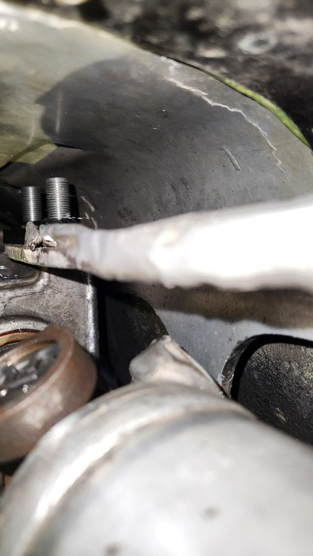

Best I can give now is this picture I took a couple years ago. This has the c-beam support kit from Van Steel for scale if you can find the height of those nuts.

I can work with this...Thanks!
