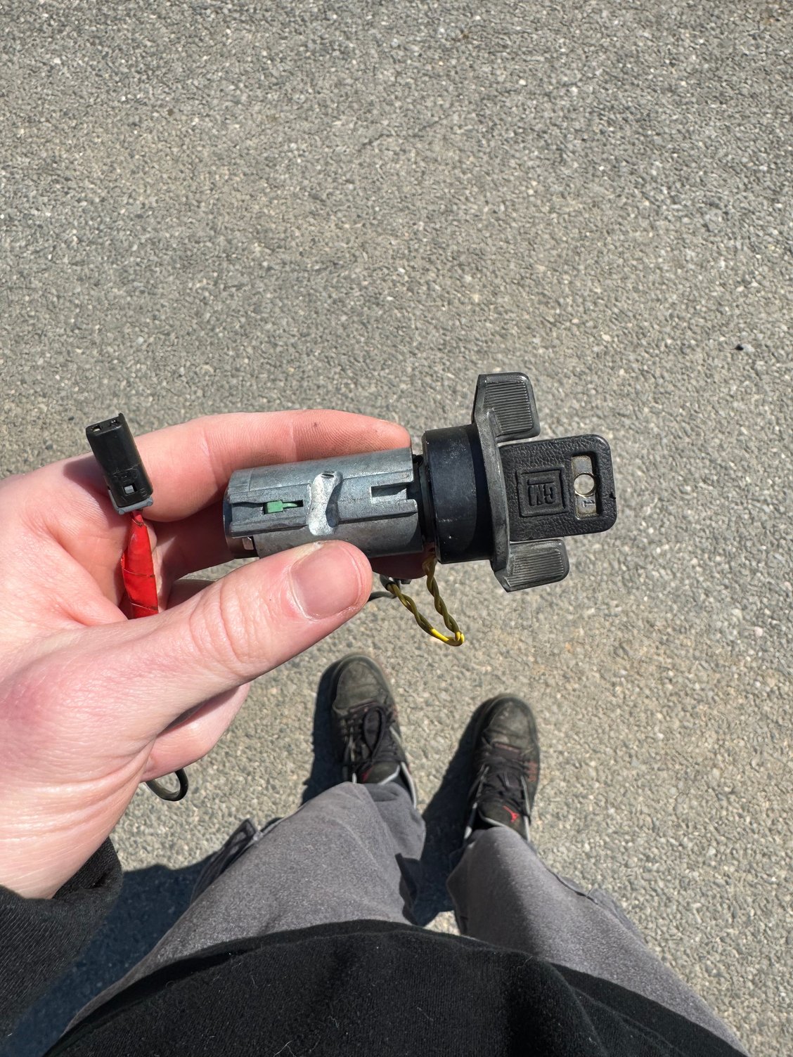

Yeah once I go to my shop this afternoon I’m going to take some pictures and post on here but yes. I do have two ignitions. They have it zip tied below the dash. I assume it has power because it’s still wired and I don’t see why they would keep it there otherwise.

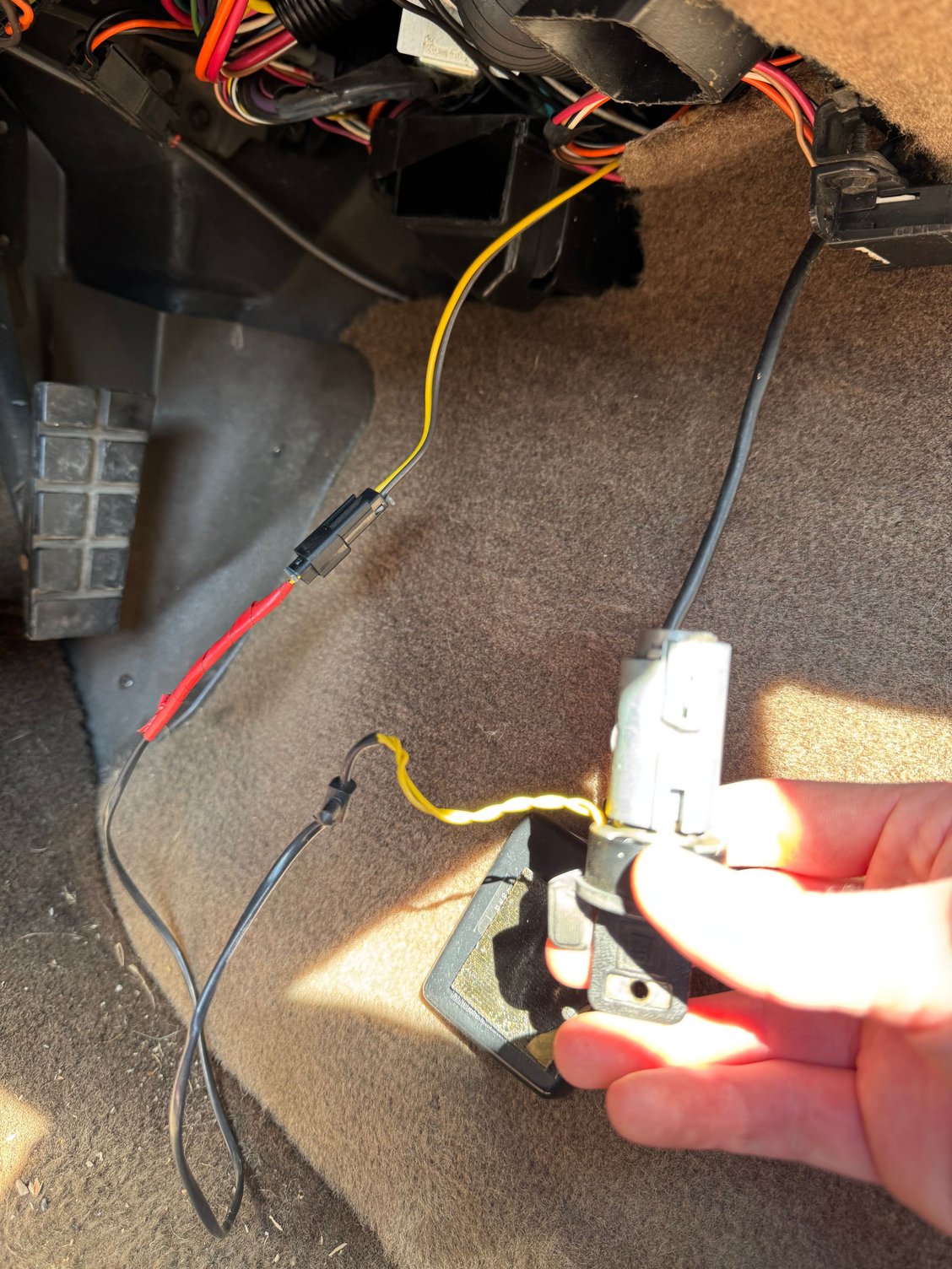

Ran out of time for the day. Took apart the dash and traced these wires back. Looks like they go into one of the harnesses. When unplugged the old ignition with key from that harness car wouldn’t start and would throw security light. Plug it in and give it some time and it starts. Probably opening a can of worms with it at this point but I’ve had it with the car so f it. Going to figure out wtf the last person had going on

Anyone have any ideas of next steps or why this would be setup like so?

This is a home made VATS bypass someone made. Normally, someone will wire a resistor between that black and yellow in order to bypass VATS in one of these cars. Instead of a resistor the previous owner seems to have wired in the original resistor key itself (maybe to be a killswitch?) as the bypass.

This was my thought as well. My next question would be regarding an actual vats bypass. The old ignition is locked into the on position and won’t release the key. I’ve messed around with it pushing on stuff trying to turn it and get it to release. Any pointers on this? I assume I’d need to get the resistance from that key in order to order the correct module. Any other ideas on getting the resistance or freeing the key so I can get it

Right, the key wont come out. I would remove it from the vehicle again, place a chisel on the ignition switch case, and beat it with a hammer until it splits in half and the key falls out.

Yeah this was going to be my last resort. I didn’t want to destroy it because currently it does start the car most of the time.

Yeah measuring from the wires I’m getting .401k or 401 ohms

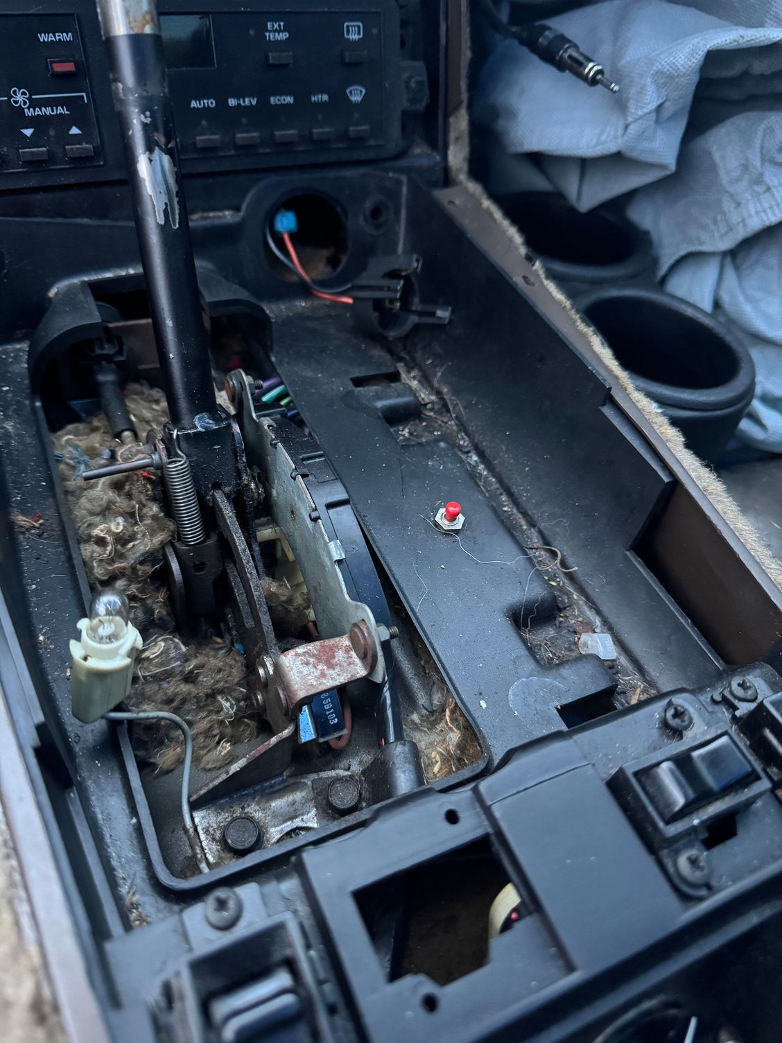

Do you all know what this button here is? I’ve been curious. Doubt it’s OEM but want to confirm it’s not before I tear apart further
