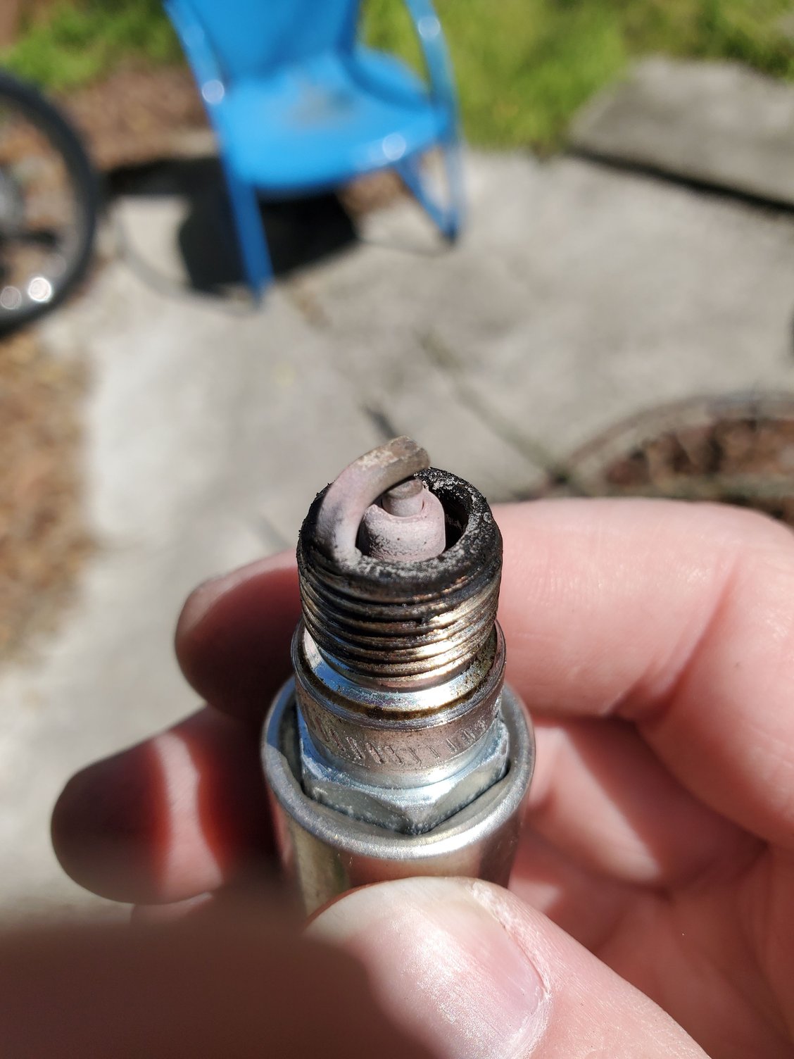

Replaced the spark plugs with brand new ones. Still has a minor stutter under heavy acceleration but seems to be doing better in every other scenario. At this point I wonder if it's something to do with the leaking intake manifold gasket ingesting oil/coolant that's causing the skip. I hope it's nothing drive line related but I haven't ruled that out.

Looking at plug #1 which is right next to the small puddle of coolant on top of my intake manifold I'm starting to think this might be a part of the problem. I should probably get around to changing that intake manifold gasket 🤔

I did that and it definitely alleviated the problem in that it no longer does it leaving intersections but it still does it under heavy acceleration. What I found yesterday makes me think it's ingesting coolant in one of the cylinders under heavy load. Everything in the ignition system is new at this point and it still does this.
