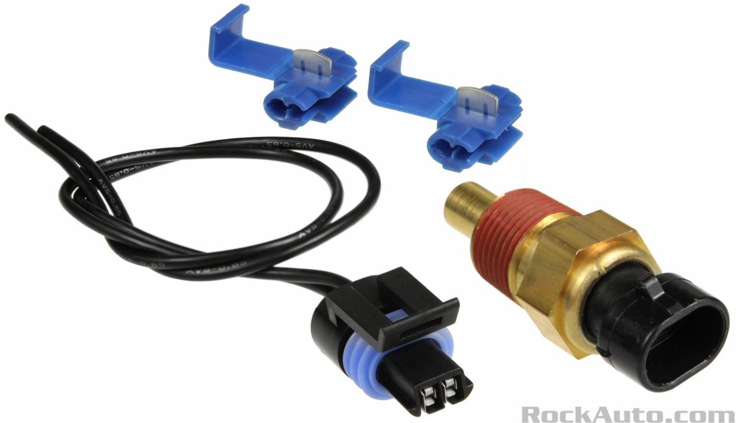

New IAC's need to be "reset" by warming up and driving at least 30-35 mph. I went even further when I replaced them on my '84 by disconnecting them and driving with the high idle for a few minutes and making sure I got up to the 35 mph, then reconnecting the IAC's and doing the same thing again. Everything worked great after that. As for the CTS this is the one I installed recently (I was getting code 15). It has the newer style connector and the right pigtail to replace the original.

Most likely its the CTS unless you installed the newer updated sensor and connecter. There was a TSB on it way back and was a common repair on early GM tbi cars. Part #Wells 5S1474 kit. Toss the scotch locks.

Ill be taking it for a drive and seeing if i can find a way to test the CTS, might just replace it. It does have the later 2 pin CTS.

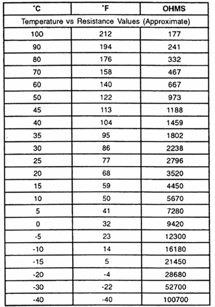

You can do a resistance with an ohm meter. If the car is cold it should read ambient.
