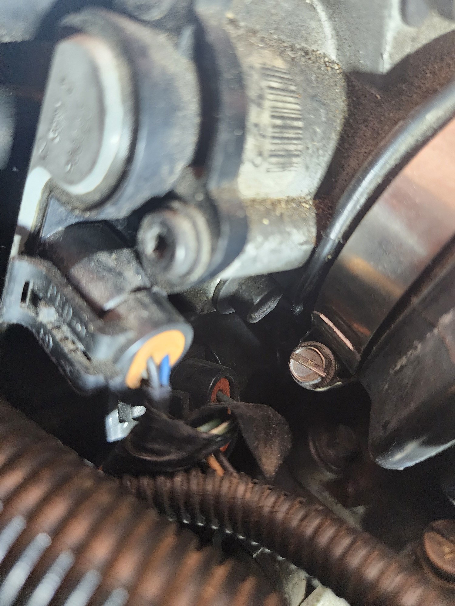

So I went to back-probe the Throttle Position Sensor by sticking paperclips into the connector from the rear side. Imagine my (lack of) surprise when I saw GM changed the connector to a design where you can't stick a wire in and the inside are small pins that you can't attach a wire to. Oh...and also...GM now attaches the sensor with three Torx cap screws instead of two. Kinda makes it hard to pivot the damn thing. Anyone have any ideas as to how I can get a reading on this?

Originally Posted by Rogue One
Anyone have any ideas as to I can get a reading on this?
I didn't have much difficulty. I verified contact by checking each 'pin' to ground with my VOM. Picture taken 3 days ago and posted in "how do I wake up my ?" thread.
Thanks for that pic. I didn't think it could be done. If I'm seeing correctly, you went with the blue and black wire. Also it looks as though there are 3 Torx screws. The YouTube video I watched only had two and he turned the body of the TPS to adjust the voltage. Do you loosen/remove all three to adjust?
No. I am probing the gray and blue wire. For this picture I was intentionally forcing the TPS signal (blue wire) high by jumping it to the 5.0V reference source. (gray wire). To check TPS signal voltage at closed throttle you meausre between the blue wire and black wire. Ie between the TPS signal and ground.\
There's only two screws. Looking at my pic (I didn't go out and lift the hood) it appears that the screws are in round holes. There would be no ability to "adjust" by rotation. I also have an intake assembly for a V6 CPI that has the same TPS and its holes are slots; ie it can be rotated to adjust.
Reading the FSM reveals that the ECM will accept a value between .03 and .09 Volts. Upon power-up, the ECM reads the TPS voltage and uses it for the remainder of that key cycle as the closed-throttle value. There IS however a 'learn procedure' for the ABS/TCS zero-throttle position that requires the use of a TECH-1 with BRAKE module to calibrate the 0-throttle TPS for the ABS/TCS.
Again. Because the TPS is used for shift-timing for the 4L60e (94-96), if TPS is erratic or really wrong, you would experience shifting 'problems' with your electron transmission.
One more thing: Some systems have "clear flood" and some don't. My 92 LT1 does not have "clear flood". With the jumper pictured the ECM thought my foot was on the floor, but it fired right up. So you may be chasing a ghost if your 96 does not have clear flood. It may not. Run the experiment I did: Jumper gray to blue and see if it starts. If = yes, it does not have clear flood and TPS has nothing to do with your hot restart difficulty.
