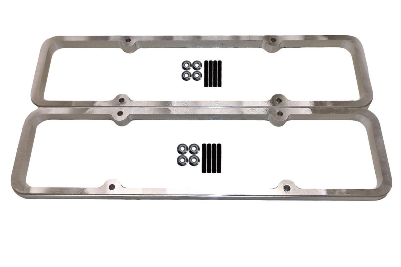

There are plenty of valve cover spacers. Perhaps that gives enough clearence.

Height is not the issue. I don’t know if spacers would space the rockets away from the side wall. The covers do seem to taper so maybe.
