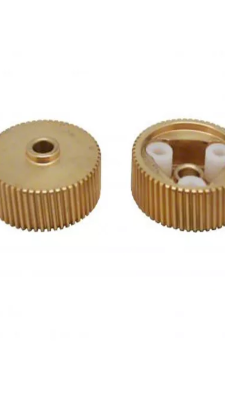

Have anyone used the metal sprockets for the pop up headlights

I'd considerd them but then I got to thinking that they were likely originally made from vinyl for good reason. That likely being so that the gear itself breaks apart before anything else it comes into contact with through operation tears up. A metal gear might have the opposite effect and tear up whatever it comes into contact with through operation.
That's my theory anyway.

I've renewed a bunch of motor assemblies by replacing the pellets. Because the big gear is installed in the housing with the pellets down, the big gear must be removed. Because the big gear has a depression in the middle that the motor's worm gear drives, the big gear doesn't just 'pull out' without first removing the motor shaft and drive gear unless you force (pry) it up and out. This probably damages the gear, and perhaps that's why it fails in the future and is replaced with a metal gear "because the plastic gears broke or stripped."
I'm pretty sure the assemblies I've worked on were virgins in that they had not been "had" by previous bubba's prying out the big gear, so the gears I've encountered were A-Ok, and I reused them.
Removing the armature and drive gear is easy. Putting it back together is not so easy because you have to retract the brushes into their holders to install the cover plate that holds the brush assemblies. I tie the brushes back with dental floss. With the cover almost all the way seated, cut the floss, pull it out and install the two motor bolts.

Select a socket that the O.D. will almost, (but not force) the brushes into their fully-retracted position and place the socket between the brushes. Put the dental floss through both braided brush leads, tension it gently and tie it together on top of the end cover. Remove the socket and check that the brushes are still far enough apart to fit over the commutator. Install the cover, cut the floss, install the bolts. Cheers.
