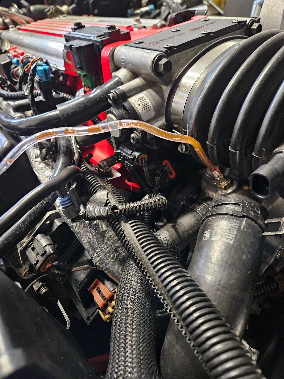

Tidy finished appearance 😁

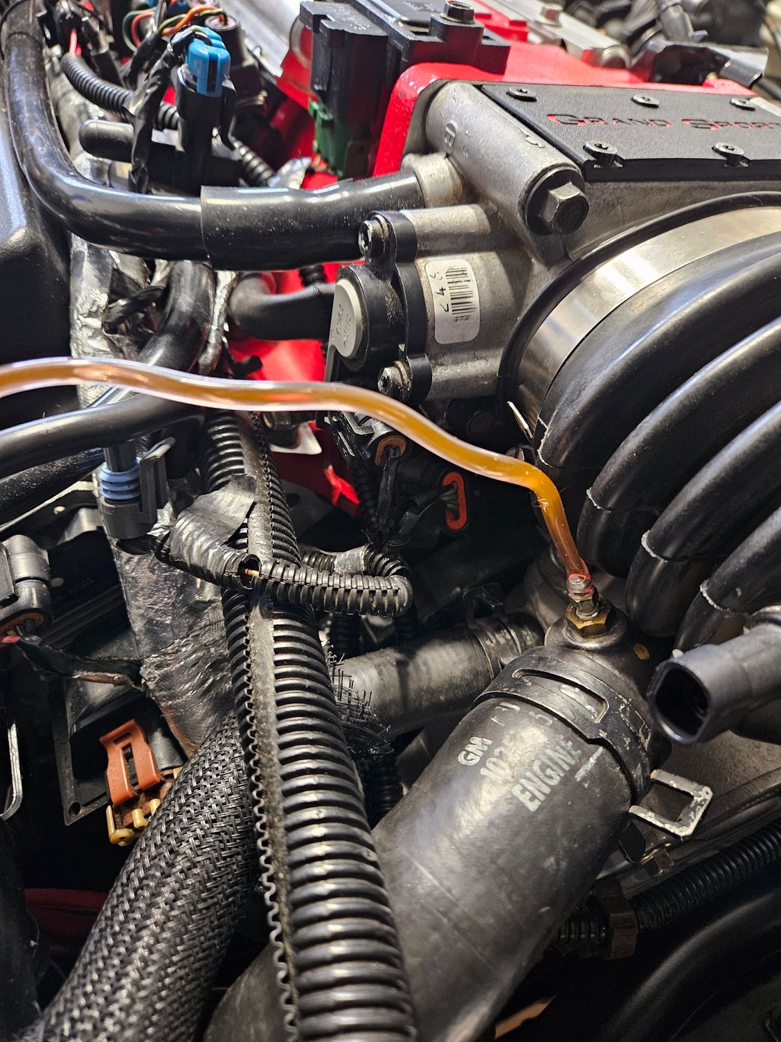

all tucked in under the factory intake bellows with a little silicon nipple to cap it off. No drips 😁
The line i sourced for the connection was a hair small, but I made it work 'cause I wanted a "clear" hose to visualize bubbles and flow. I had to add a junction to reach down to the overflow tank, but I had enough clear line to see what i needed.
Bubbles at 1st Crack, but slowly it does what it's supposed to.
Closed loop system now, so no loss to spillage Doing this also keeps the pressure tank capped, so system pressure and flow work like normal, as long as the system was burped enough to prime itself. Let the engine run a few minutes to develop a tad bit of heat & slight pressure on the hoses, then open the bleeder. I let mine flow more than likely needed, cause tiny hose wasn't moving a ton of fluid and it just goes into the overflow. No more bubbles, close the bleeder. I pinched the hose end right above the bleeder with pliers and raised it to allow whatever was in the line to empty in the tank.
