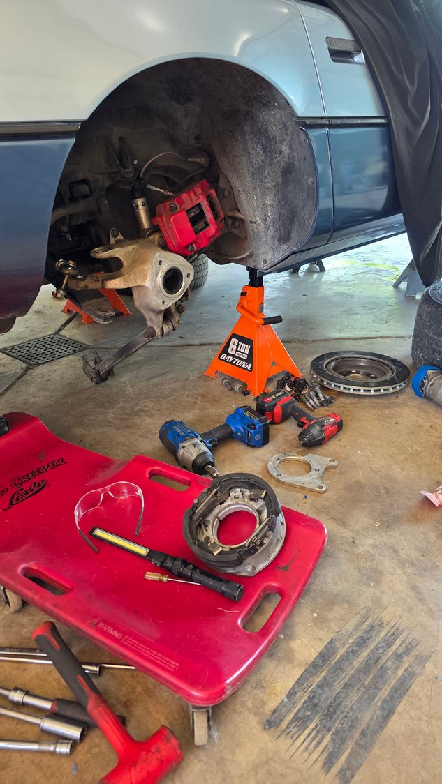

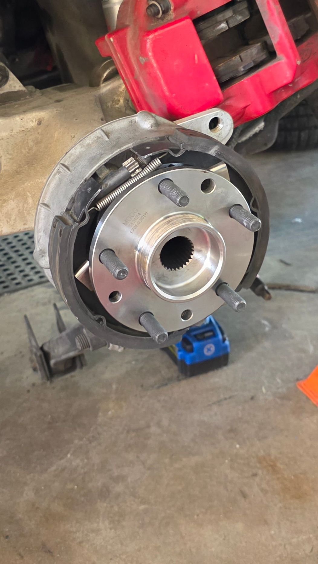

Got the swap done in my 85. Had to replace a broken ujoint and mangled halfshaft anyway so it was a good time to knock it out. It is amazing how fast these hubs wear out and how significant the wear affects handling and feel through turns. After the hub swap the unnerving "oversteer" feeling during quick steering inputs is gone. The real test is going to be longevity. I'm at 75,000 miles now so I'll keep track of how long these last me. The last OEM style set made it about 15,000 miles and probably needed to be replaced 5,000 miles ago. Took a quick video of a little test drive after the install.
One bummer that will turn into a bit of a science experiment. I ordered 2 SKF bearings but one of the hubs sent was a Moog 513124. The SKF fit perfect with no grinding needed, it has no access holes in the hub face though , so it does make lining bolt holes up and any needed parking brake shoe service a bit more difficult. I just chopped up the ABS sensor to keep it in there as a plug. The Moog needed quite a bit of material taken off of 1 side to clear the parking brake strut bar. Either way, but SKF and Moog hubs are beefier looking than the stock units and I'm hoping that translates to more than double the original useful life of the OEM parts.
