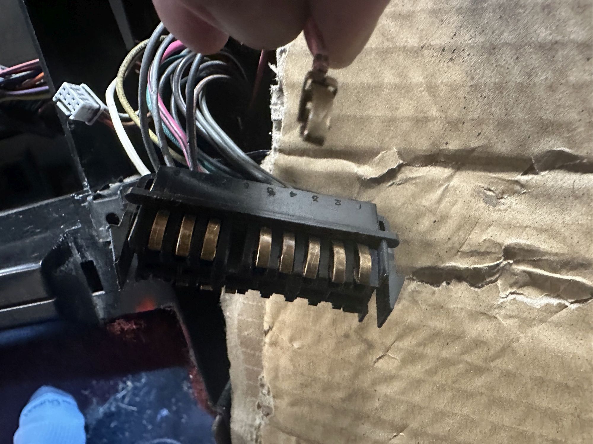

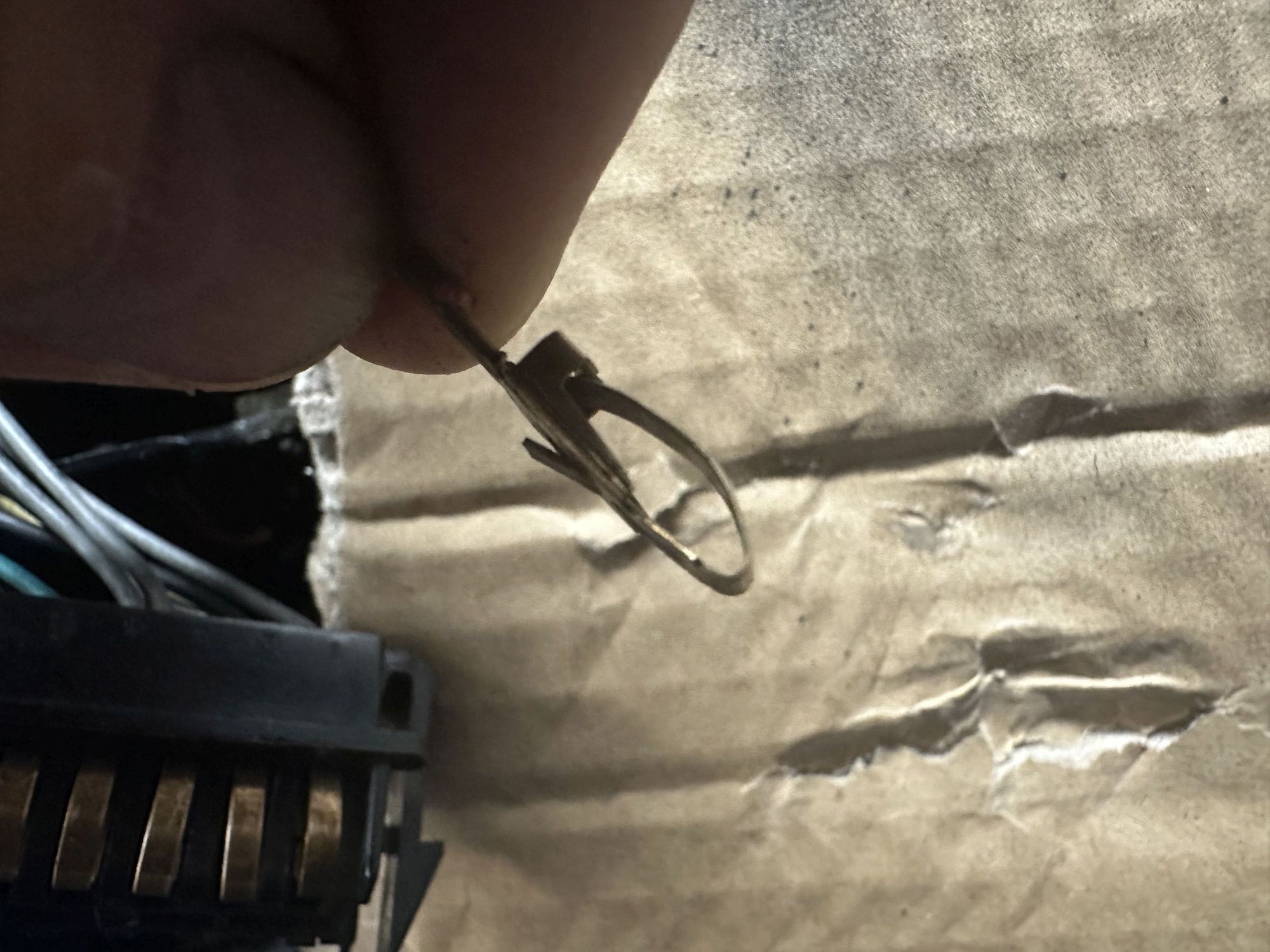

I have a broken conductor next to the terminal in my telltale assy. I'm having trouble finding a part number, description and source for these terminals.

Finally found it. These are called printed circuit bow terminals. Terminals are Delphi part number 2984794 or Ron Francis wiring pc-3. They are also used on GM trucks and earlier corvettes.
