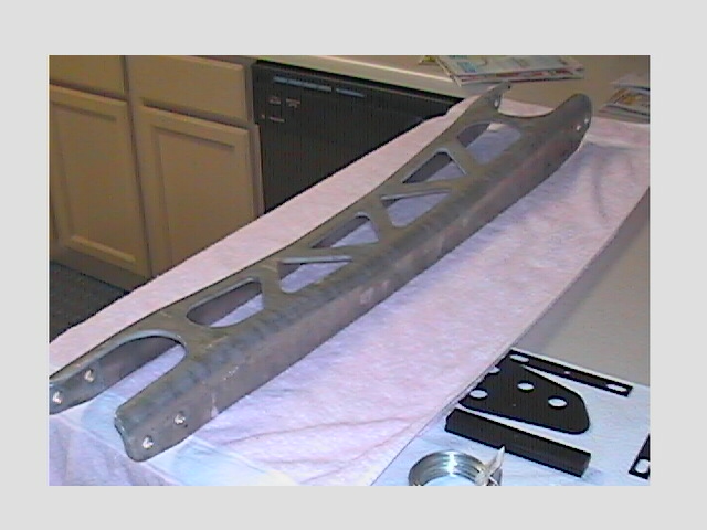

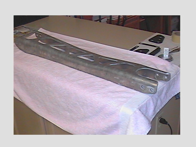

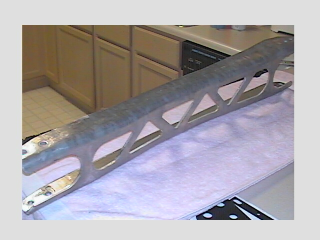

I'll try to take some pics of mine later today, it's just standing up in the corner of the garage. If your e-mail is in your profile, I'll send them to you.

some pic's

Thanks for the pics. Mine has a little wave in it that yours doesn't. I guess I"ll look around for another one. I wonder what the history is on this? Oh well. :rolleyes:
Maybe next year when I pull the engine and replace the clutch and exhaust system. Come on Lotto :lol:
