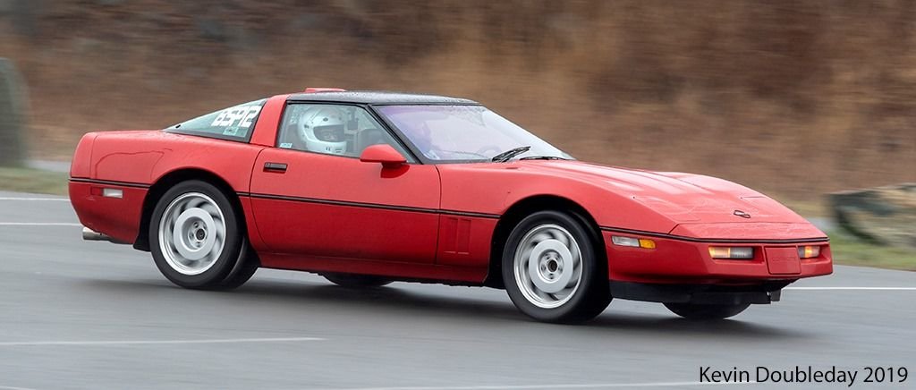

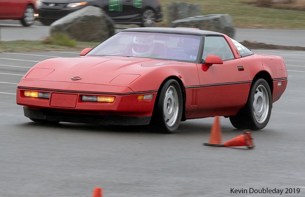

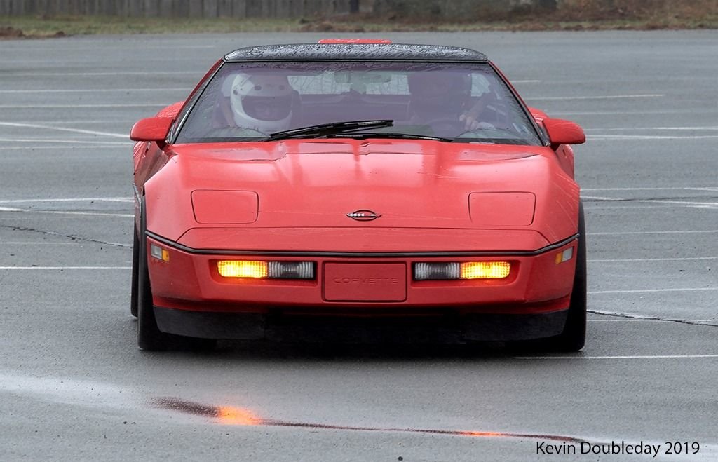

Figured it was time for an update it has been a very busy spring and lots of rain. The car received all new super pro bushings, ss brake lines, Hawk HP Plus pads and hoosiers a7's 315 35 17 on all 4 corners factory wheels (Please save me your wheels are to small if you would like to donate 2 17x11's that will fit the front of my car that would be great . Sorry I didn't have time for hardly any pictures but we did get to put the car on the scales with half a tank of fuel which really surprised me as far as cross weights go. So far we have had two events the first it was 5 degrees celcious and rain in a small parking lot a good friend had an incident which really made me check up in the video. The second event was at our normal spot an old runway on a military base it was 20 degrees celcious. Its a great venue but it really is important to have a co driver to keep the a7's hot they would get nice and warm on my first run than by the time I got back out they just weren't there. I am still figuring out the car with new bushings and a7's the results are not anything to cry home about but at the end of the month we have a great event at another air strip and I have my co driver lined up so fingers crossed! Now what I can tell you is this the car feels very tight and responsive. The old bushings were so shot it was scary but its amazing how tight the car feels, Second ss lines and hp plus pads are fantastic the car really bites now and will actually slow itself down. Now the a7's when they get warm they are incredible you can really feel the car change in steering inputs etc even with the big 315's on a 9.5 inch wheel the car turns in fantastically. We were allowed passengers today and my friend with a very well prepped ssp c5 z06 says the two cars felt almost identical he figures if he was on fresh hoosiers he would nose me so im happy with that. I'm going to try and link some videos from Facebook but if it doesn't work ill post them later now on to some terrible pictures Except for the ones our fantastic photographer took at the bottom! (Kevin Doubleday)

ZRConekiller, good job, but one thing is bothering me. Put the rear wheels on the correct side

JoBy yeah we were rushing to get the car together hence why the wheels were backwards lol. Improving the chassis is the next step I really want to buy a z51 spring and bar set next to try. I read over on the registry someone was doing this in the mas area with some success. The crippling factor for these cars is that the mold is broke at hypercoil so as far as aftermarket stiff springs were SOL. Lets face facts its not economical to make a new mold for these cars. Ideals next year id like z51 springs and id like to try the big bars front and rear from vansteel. I really want to stick with leaf springs but if I go coilovers the car is headed in a CAM S direction with 200 tread wear tires. We have another event tonight so well see what happens.
