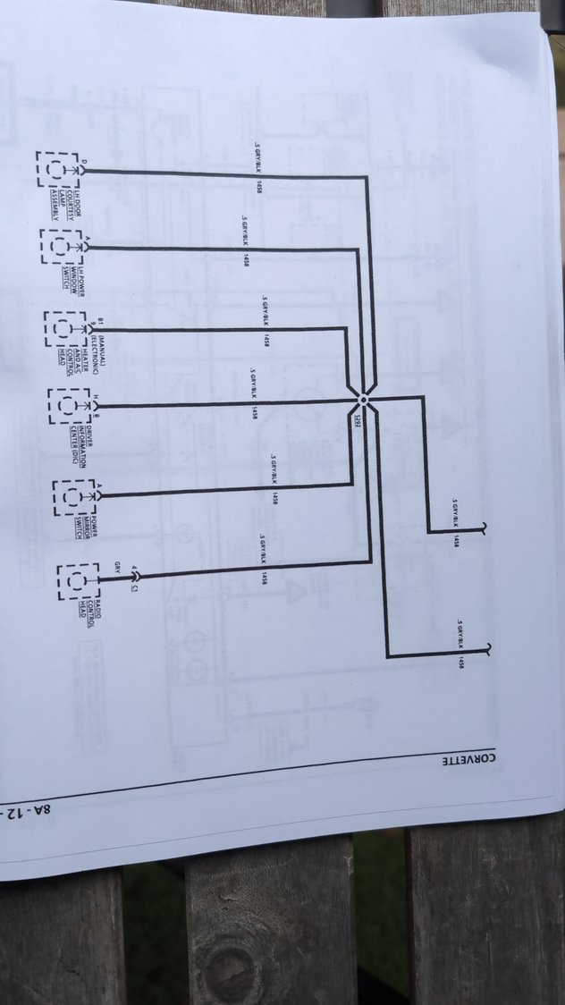

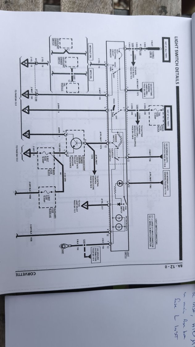

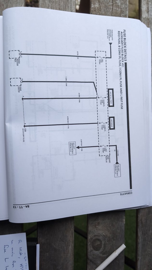

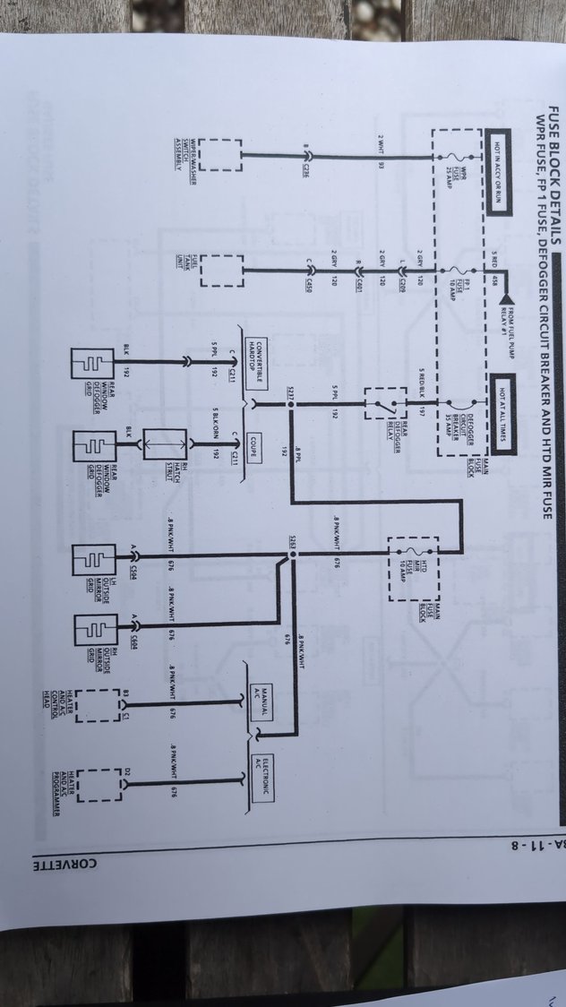

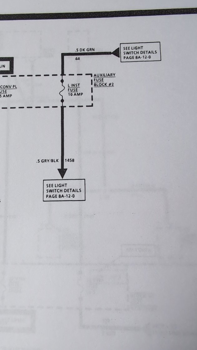

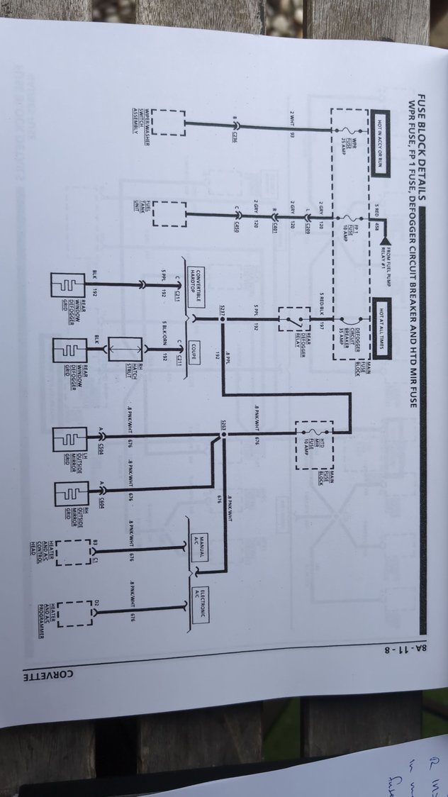

Hi attached are from my 91 shop manual, hope it helps 🙂👍

@Topspeed , thanks to @gerardvg you've got what you need to track down the problem
Good luck
