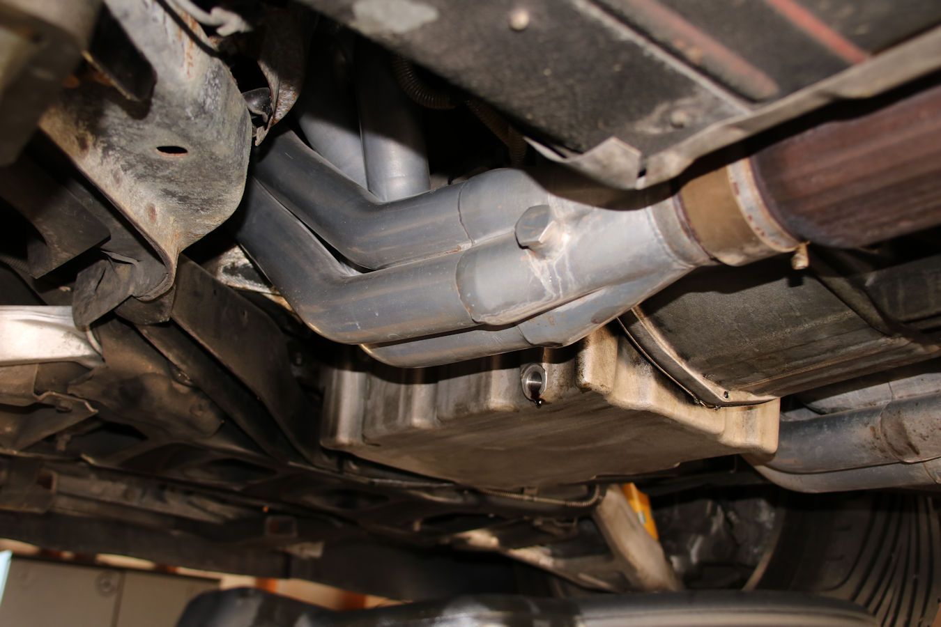

Originally Posted by ZR WON
Please keep in mind that current iteration of the Stainless Works headers are a slightly different design than the originals I was involved in helping develop 20+ years ago
Good to know.
I think my SW are 10-12 years old, so the old design??

From: IN
My guess is they would be the original longer tube design; shoot a 'ground up' photo of the headers on the car and I can tell you.
Can you tell from this angle?
Old Aug 19, 2025 | 05:55 PM
ZR WON's Avatar
ZR WON
Joined: Jan 2001
Posts: 1,234
Likes: 175
From: IN
They appear to be the old design to me.
