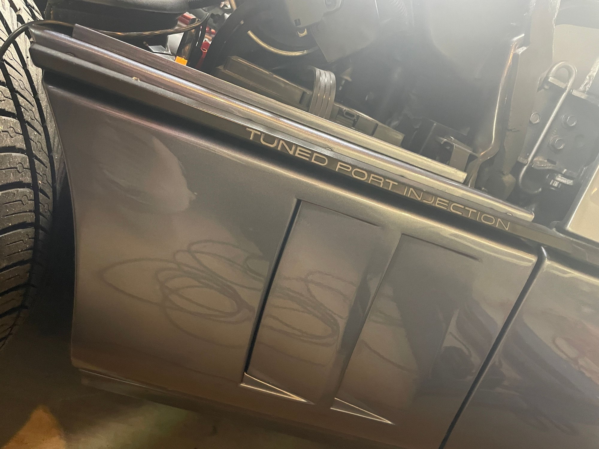

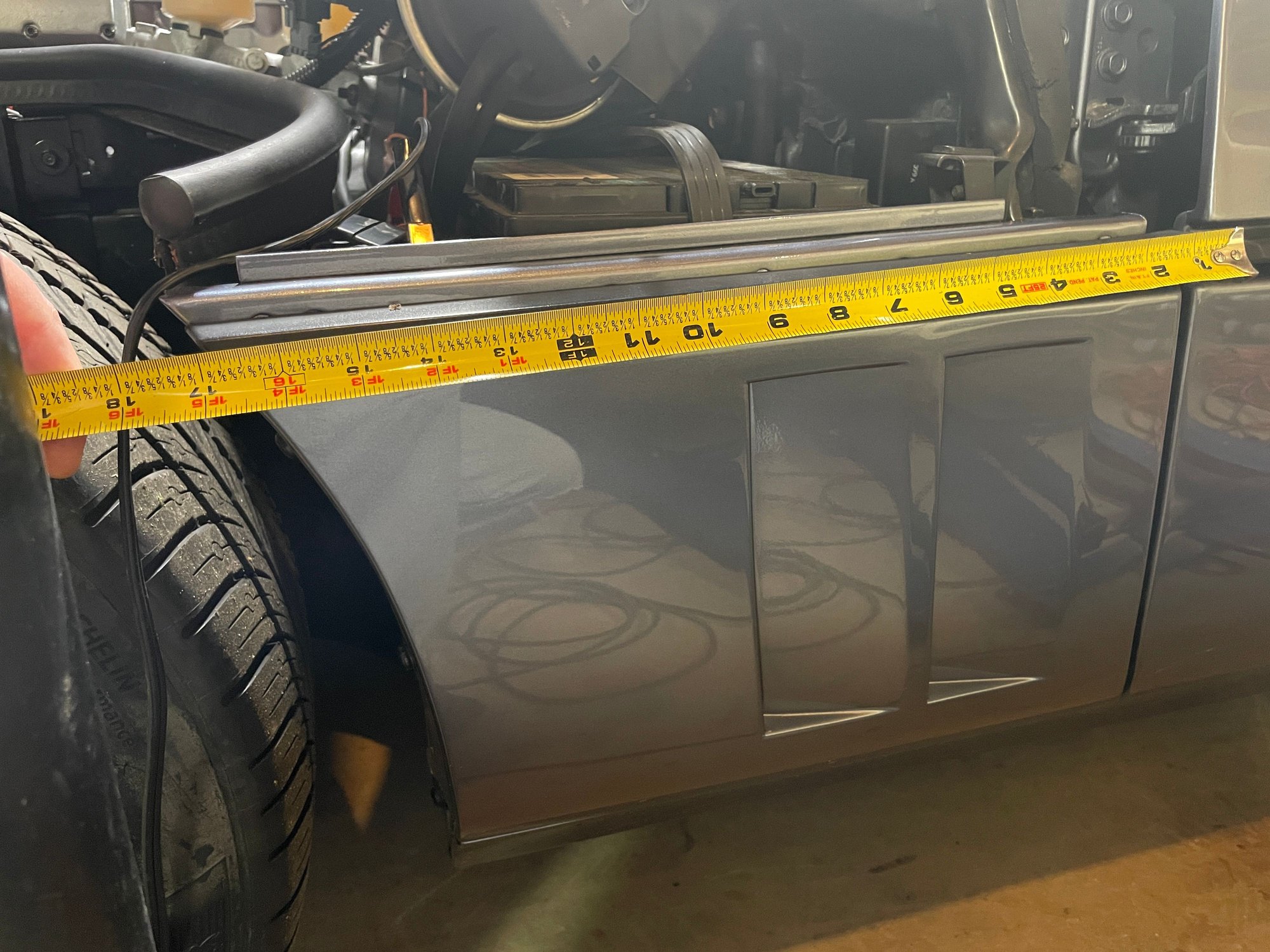

It part is the same from 84-90 only 84 has Crossfire on it all years mount the same. Of coarse they are Rt & Lt. About 17 inches long. If you remove your you will see the mounting stud area would be a bit complex and my have to be done in 2 parts and glued together.
The second option would be a snap over cover to the original part, but this may look out of place.

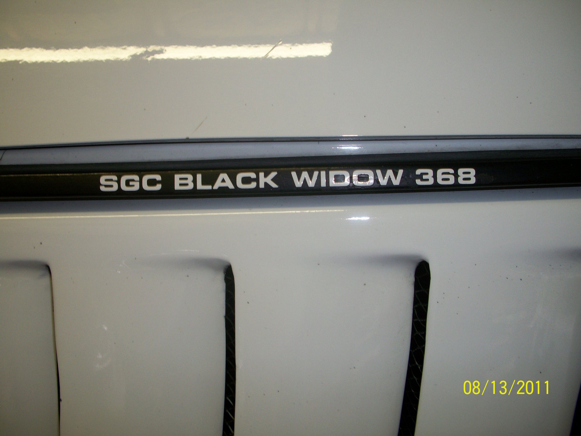

Default 3D printing
Back in 2009 I took a stock 1984 strip with cross fire injection on it. Filled the cross fire injection with with body filler, then had a print shop make a decal that read
SGC BLACK WIDOW 368
Take's a little time to do ,but came out great

Great idea... TY

Thanks for posting this.
I like the idea of 3D printing the part, and also the idea of having a printed overlay.

I must say that is cool AF John!! 👍🏼🤙🏼
