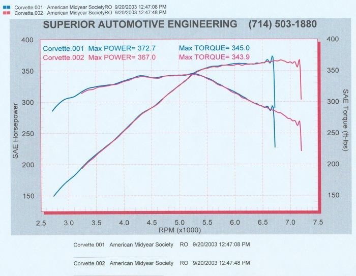

I've lurked here for a while and this board has been very useful to say the least. I have a 91 that I 've owned for about 6 months. The car has had the inlet tract extrude honed, Watson's, a chip, and borlas, all done by Exotic Muscle in Phoenix. The car has 70k miles on it and has run strong since I bought it, and is my daily driver. I recently had it dynoed: http://www.67fso.com/dyno.jpg
I was pleased with these results....car showed 132mph in 4th gear on the dyno.
