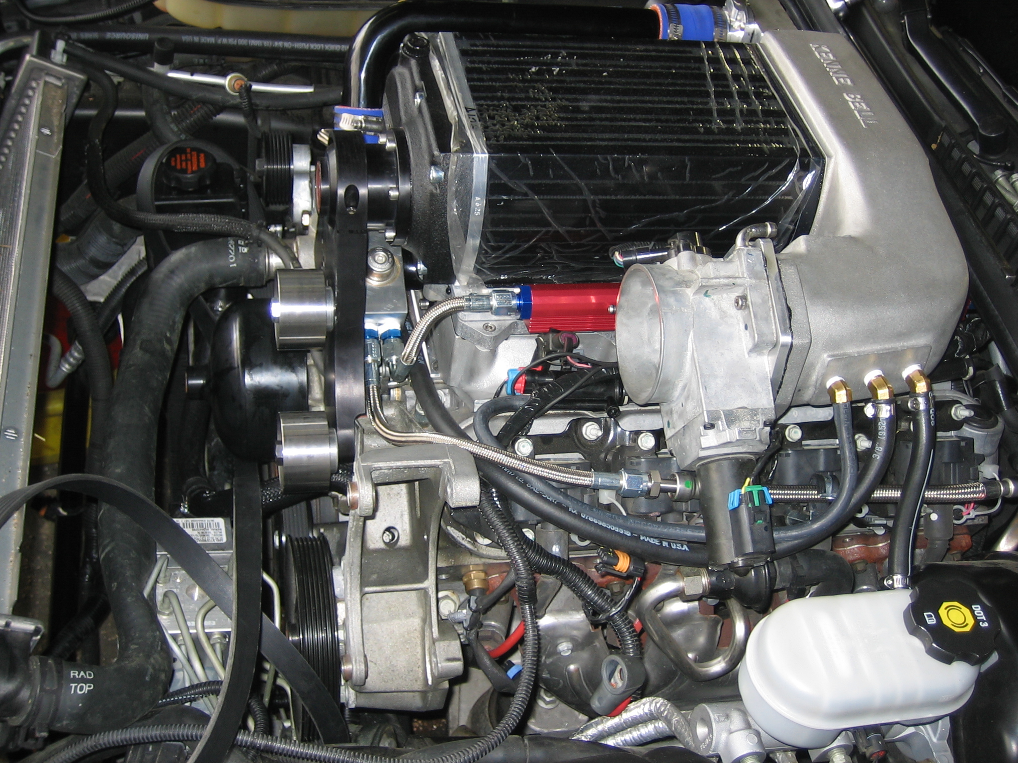

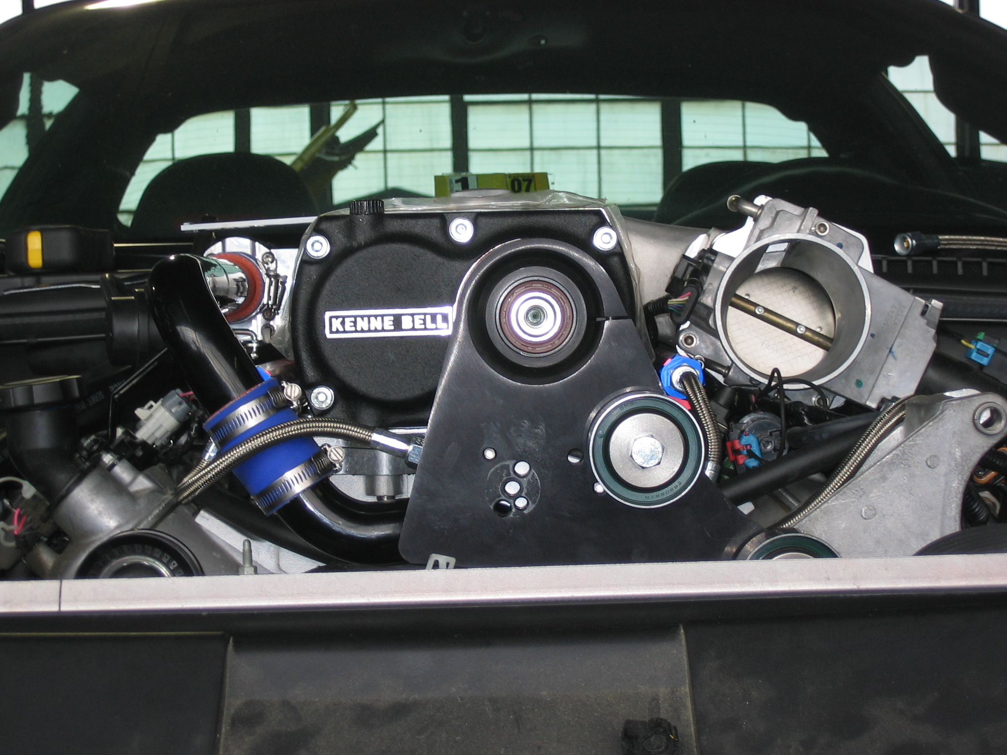

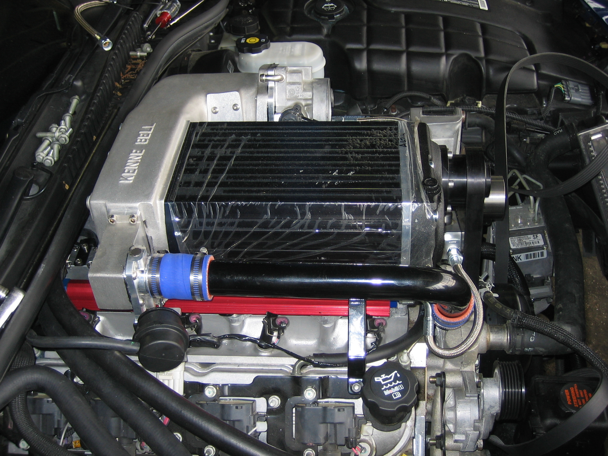

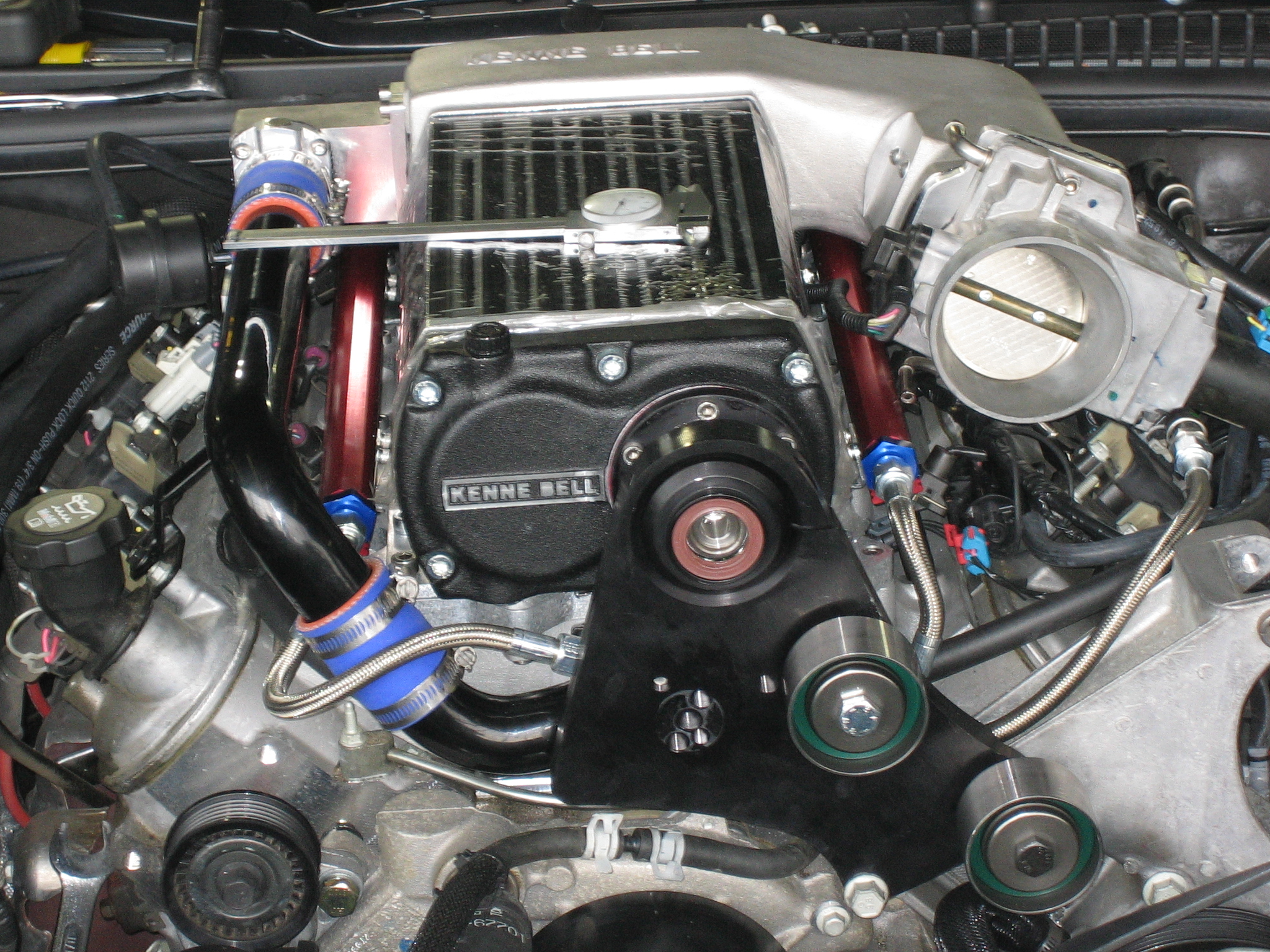

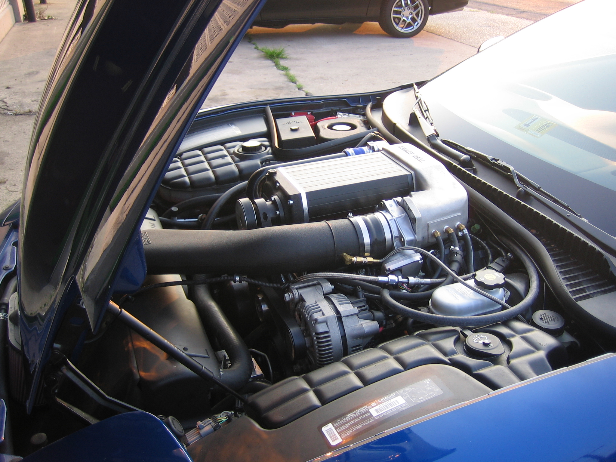

Here are some more pictures of a Kenne Bell Blower on a C5 Z06 that Carolina Auto Masters installed and tuned

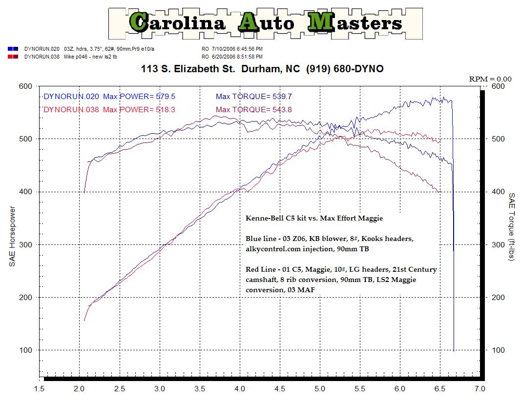

Here is the dyno graphs showing the Kenne Bell versus the Magnuson Maggy
