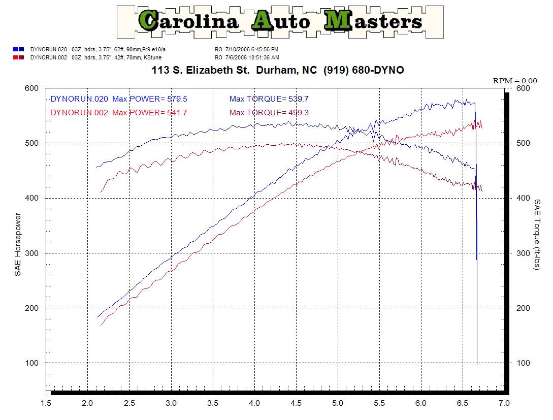

I always see everyone's peak numbers and thier setups but always have to search for their dyno sheets. I'd like to see if everyone would be interesed in posting a copy of their dyno sheet in this thread for all to see along with a listing of what mods they had at the time.
Peak numbers are great but I'd love to see tq & hp curves as well.

Kooks 1 7/8 headers, Alky kit, 90mm TB, and a Kenne Bell running 8#

I made this forever ago. Obviously there are probably more updated numbers and other players in the game now.
I'd be happy to update it if it would be helpful. Just need submissions.

Here's mine, just upsized injectors, racetronics fuel pump and return and reg at the rails, otherwise bone stock, except for a little spray.
Robert

Here's another dyno overlay, which includes a couple dry n2o hits. The dry hits can be set-up more progressivly if one want's such, or it can be set to hit hard like my graph above (same cars). This was put together by fellow memeber Chris Stewart.
Turbo/Nitrous Overlay
Robert

http://www.exoticperformanceplus.com...Car.php?car=40
Here is Tom Snitzer's C5. 346 ci with ATI ProCharger D-1SC. Bob

Stock 99 tune stock exhaust (borla catback) vs a Diablo Predator Tune (Diablo custom not the default performance tune).
50 shot dry Nitrous Stock 99 and stock exhaust (borla catback)
75 shot dry AFR was to lean (discovered injector issues, see how the AFR climbs )
Same day Nitro Dave wet plate kit 50 shot
wet plate 100 shot
wet plate 150 shot
50 dry and 150 Wet
50 dry and 150 shot w/fresh bottle, probably over 1050psi (shop bottle no gauge)
This is what I left with
two stage working the 50 dry and estimated 125 wet
All these were untuned, heading back to the dyno with headers, ported tb ls6 intake and 42 pound injectors and tuning this time

A&A S-Trim kit, Supermaxx long tubes, OC Corvette tuning

A&A Vortech S Trim, LGM Headers, Corsa Touring Catbacks, Dual nozzle alky injection
