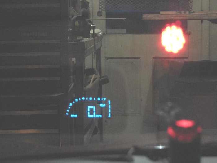

OK, here's a pic taken in the garage. Sorry, it's about 15 degrees here.
You see the head-up display, and on the upper right, the warning light reflected in the windshield. Looks like something you'd notice, but need to check outside in daylight. The 12 LEDs are a little blurry and actually red, hard to get a camera to focus on the windshield.
That would DEFINATELY want to make me slow down FAST!

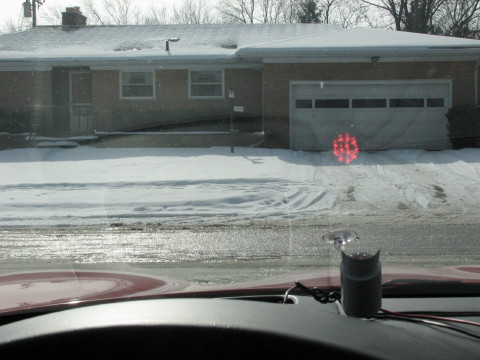

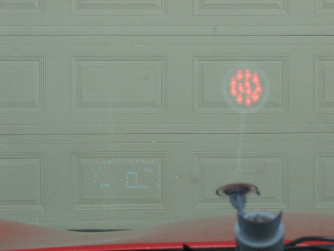

Couple more pictures of the warning light reflection on the windshield, this time in bright sunlight.
The second picture is facing into the sun.......so bright that you can't even make out the heads-up display.
Yeah, the bulb is temporarily stuck to the base of the windshield with a suction cup.
Ain't cuttin' anything up to mount it in the dash till I'm sure everything works as planned.
