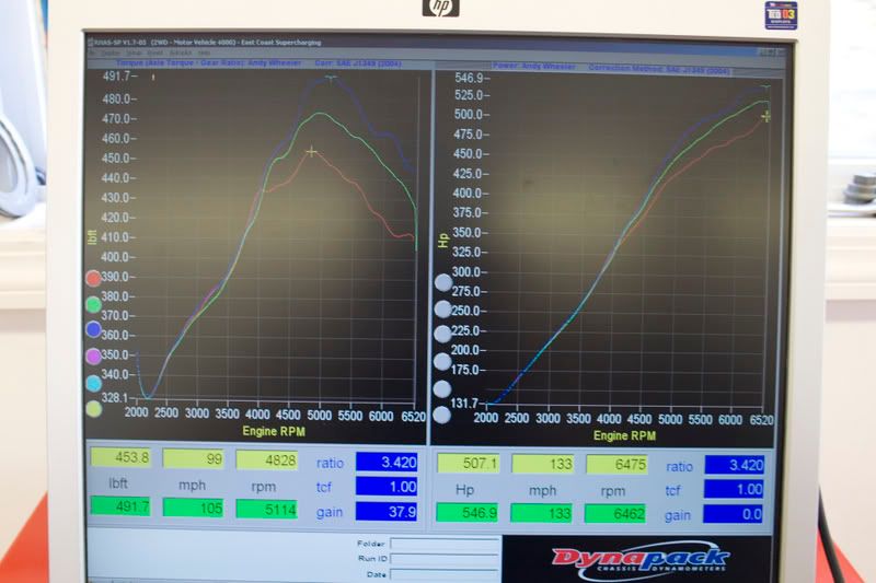

Well here are the numbers. Previously on my old 3.8 pulley I saw 6.5 7lbs of boost and the car made 504 rwhp. I added the 3.6 pulley and expected to see 10lbs of boost today, but with it being so damn hot out we only saw 8 lbs. So needless to say the car didn't make 10lb numbers, BUUUUUTTTTTT.
On 8lbs of Boost the car made 547 RWHP So when the weather gets a hair cooler and I see 9-10 lbs of boost the car will easily make 580 rwhp, which is what I was hoping for on the HIGH END. My car has always Dyno'd like crap and I finally felt like it did OK. With 8lbs of boost on a 2001 Z06 with a little S Trim in this weather I was pretty damn happy!
***** Just so everyone knows. I was running HEET in the alky tank for the first two pulls of the day and the car was getting knock and pulling timing. After scratching our heads for 10 minutes, Doug suggested that I dump the HEET and put in some Pure Meth. The Knock went away and the car picked up 45RWHP from the previous dyno so if your running HEET I would get rid of it and try and find the real deal *****

The numbers,
