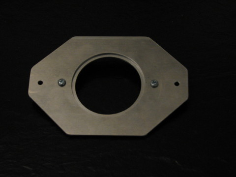

I wouold like to see a pic of this restrictor plate i hear so much about. Im am interested in purchusing one and i would like to know how much they cost and how they bolt up. Thanks mike

It doesn't bolt up. It's snug fit into the air cleaner and is held in place by the intake tube/bridge. As far as cost, the best thing to do is call ECS or A&A.
Here's a picture of one installed:

I see i thought it was closer to the inlet of the supercharger. Thanks for the pic. what pulley are you running and how much boost?

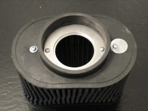

Originally Posted by Z06supercharged
Caution....
Just a snug fit will not stay snug usually and the plate will either drop down inside the filter or go sideways. You need to support it with either a second side plate with screws to keep it in one place or 2 small zip ties wrapping around the inside edge and then through the filter media edge which will hold it in place (how mine is and works just fine).
Some filters do have a underneath "shelf" the plate can rest on but usually not.
I had the same concerns, so I made a new plate with "wings", and bolted it to the inside of the air cleaner. Plate gets dislodged, and the motor might be toast.
At the time of the photo, I had a second smaller plate mounted to the larger one.

3 full seasons plus track rentals and many other track days. Air filter holds it in, nothing else. never had a problem, never had it come loose... 280+ passes at the track!
incorrect.
