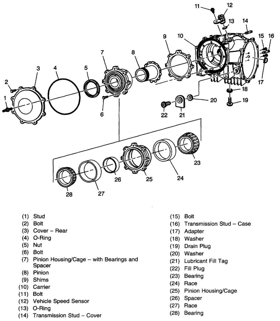

k i figured id just take it apart and figure out on my own, not bad, pull both covers off, take rear cover off, remove pinion. then remove the crap ton of smaller bolts around the ring and pull apart - the driver shaft will have a gear, remove clip and slide gear onto new shaft and put clip back on - reassemble, which i will do tomorrow once i get some more cleaner.
btw what is the lil round disc that kinda rubber but has grease or something in it that fits loosely in a slot in the inside of the case.

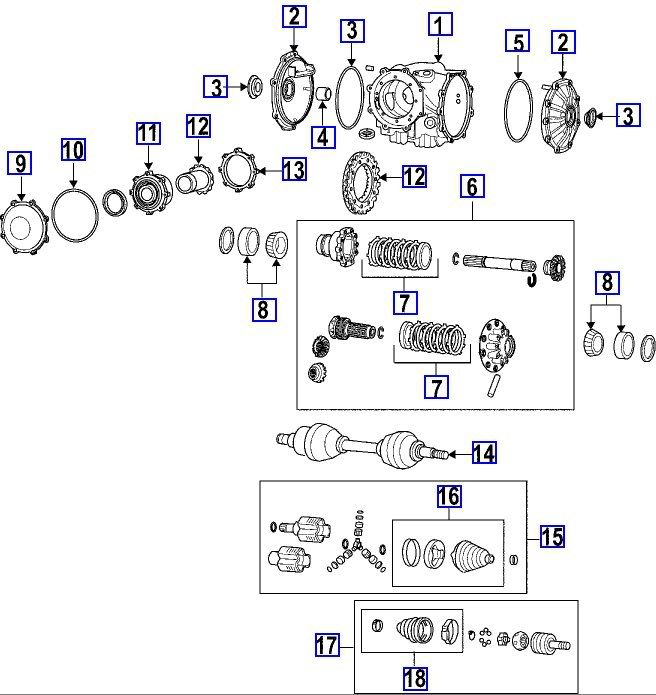

This help any?
Old May 1, 2009 | 09:55 AM
slothy's Avatar
slothy
Joined: Feb 2008
Posts: 1,765
From: St. Clair Shores Mi
its the lil washer looking thing above 12 on the top pic - that's the mystery part
Old May 1, 2009 | 10:10 AM
clemsondave's Avatar
clemsondave
Joined: Mar 2006
Posts: 1,872
Likes: 7
From: Richmond VA
According to this one, it is just a magnet.
slothy's Avatar
slothy
Joined: Feb 2008
Posts: 1,765
thanks! felt squishy - prob just needs to be wiped down.
