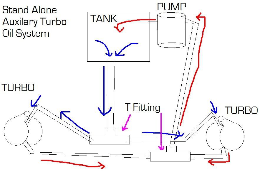

Default Idea
Here is an Idea for a redesigned System. Tank and pump will go in the center stowage area of the Vette, Maybe outside and mounted behind the bumper...
For the Pump I was thinknig about this: Tilton Oil Cooler Pump
For the Tank, I still need Ideas but something that would fit in the Center Stowage Area. Something like this Tank
Things I don't know are:
What fittings are in the pump?
How hot will the Oil Get?
Do I need a Filter?
Good place to get Key on Power, Maybe use existing STS Harness.
Things I can Measure are:
Dimensions of Containter
Legnths I need of hose
Legnth I need of wire
Thoughts? Concerns? What Am I Overlooking?

I am not sure gravity feed alone without pressure will work.
Old Apr 9, 2009 | 07:56 AM
BLOWNZO6's Avatar
BLOWNZO6
Premium Supporting Vendor
Posts: 5,241
Likes: 21
From: Knoxville Tennessee
+1... the way you have it setup it, it would end up not working for several reasons.
1. The oil would take FOREVER to get to temp if it even did.
2. The pump would probably no prime.
3. As pointed out above you are not feeding pressure to the turbos, which is a must,they don't require a TON of oil, but there has to be pressure there.
There are other reasons as well, but that will suffice.
Do I need a Filter?
A major problem with the STS system is where the oil pump is mounted. Most pumps are p***-poor at pulling fluids. Pumps are designed to efficiently push fluids. Move your pump to the rear of you Corvette and use this pump:
http://www.turbowerx.com/Scavenge_Pu.../Exa-Pump.html
I like your idea, where do you suggest I mount it and how would you plumb the system?
Old Apr 9, 2009 | 04:54 PM
Pumba's Avatar
Pumba
Joined: Sep 2003
Posts: 2,458
Likes: 105
From: Northville Michigan
I can't see the underside of your particular car, so you will have to determine where to mount the pump.
As far as plumbing, I would run a short #8 line, with an internal spring to prevent collaspe under vacuum from each turbo to the pump that I recommended. Out of that pump I would run a #6 line forward to whatever switch, etc. STS has provided.
Good luck with your installation.
