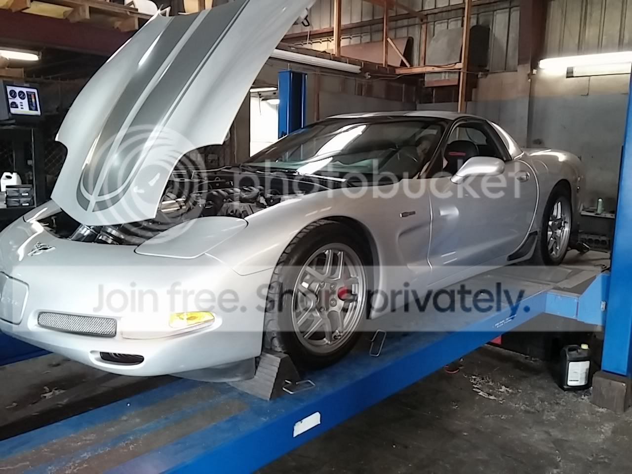

We maxxed out the turbo. At 14psi it stopped making more power and we had to pull timing anyway. Boost actually falls off after 5k rpm down to 12psi.

What size turbo are you running, I forgot? I can't believe it maxed out at only 14psi. Did boost fall off because of back pressure or the turbo being maxed? I hope my Hinson kit don't stop at 14 psi I have a precision 76mm. Nice work on the build and and got your goal

Mine is a Turbonetics TC76. Small 68mm turbine

Car is exactly what I wanted. Very snappy and quick into boost. The torque curve is very flat. Pretty similar to the stock ZR1 charts, but I've got 50hp/50tq on them

cam is killing you...I'm sure you are happy with it, but a good cam would let you turn up the boost more and probably get you another 150hp.

if your boost fell after 5k... you have belt slip..better get a 11 rib put on it..

Nonsense, chain drive is the way to go
Nice job Mawnee. Definitely choked off with the F1-68 .96 a/r turbine and increased displacement. Look at that torque curve though
At least you know if you ever want more, you can throw a F1-75 snail on with bigger hot side and pick up a ton.

Lol Thanks guys Funny enough there was a kid there to have his z tuned after me...and even though he was looking right at my turbo he kept saying " you could pulley down". I didnt bother to correct him =P I guess the turbo location confused him.
You can tell by the torque plateau that its the turbine maxing out. Above 10psi more boost gained more hp, but not much torque, it just came on a bit sooner. Some guys see this as a problem, but I see it as my perfect setep. I got my positive displacement torque and response and fit it under the stock hood. I can blow the tires off at will, but at the same time with a little pedaling the car will still hook and put down.
