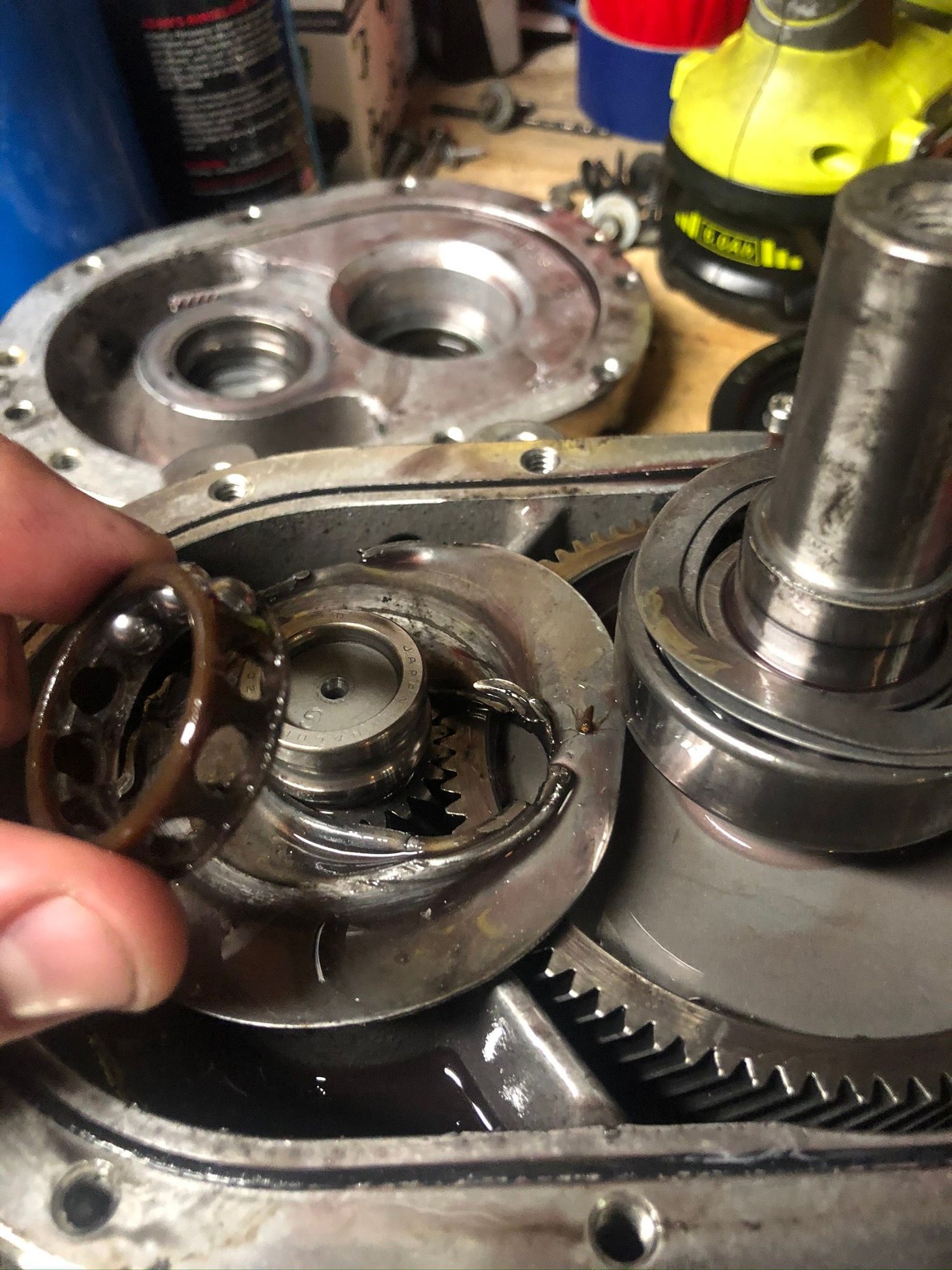

Are there no part numbers on your bearings ?
And that's the high speed one in pieces.
there is a part number on the high speed it’s nachi 7203. I dont see a number for the low speeds on them. Also looking for seal part numbers. Im going with the 71k bearing for high speed. Blower is at 56,000 rpm before slinger let go and took out high speed bearing

From: Northern Ireland
There should be numbers on them both.
Although when I did my YSi about 15 years ago, they were actually Vortech marked bearings, but I think they stopped that maybe 10 years ago. So finding suitable bearings back then was a total nightmare.
I think the low speeds on the YSi were a 7205 high precision angular contact, although the lower models might just use regular roller bearings ? Not sure. There should be numbers on them though.
Cant recall on the seal on the input/low speed....I just used a regular oil seal bought on dimensions.
I never did find a supply info for the high speed seal, but never did change it anyway as no need to.
I think that supercharger rebuilds place sells complete kits ? Although they probably grind part numbers off.
