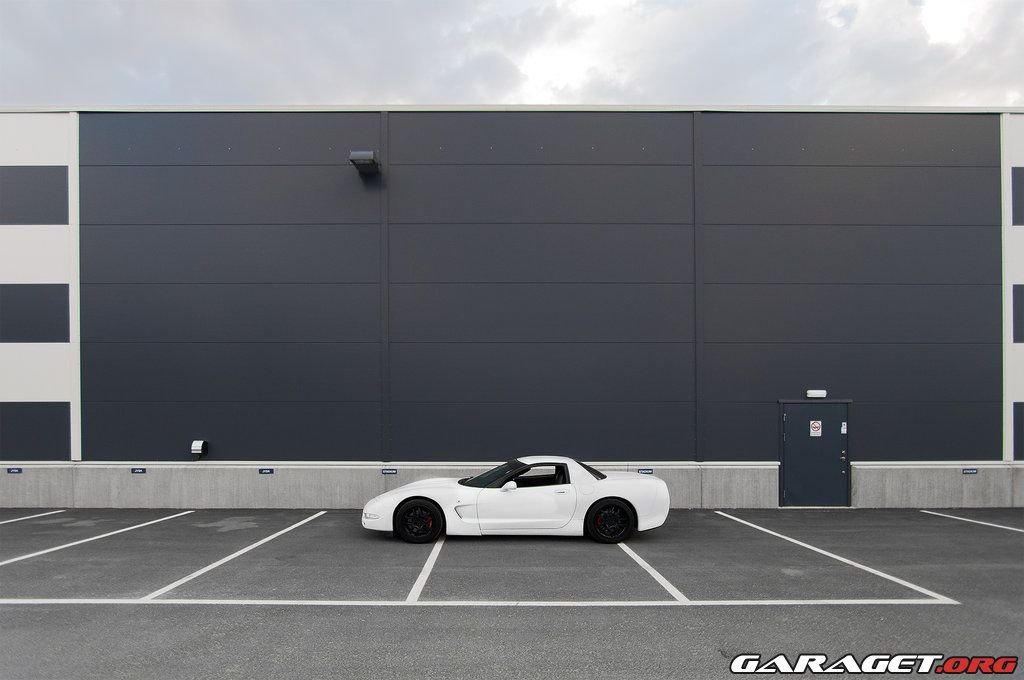

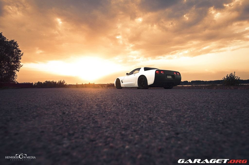

Image of the car

No clue on the answer to your question, just wanted to say your car looks awesome. Sounds like a quick setup.
