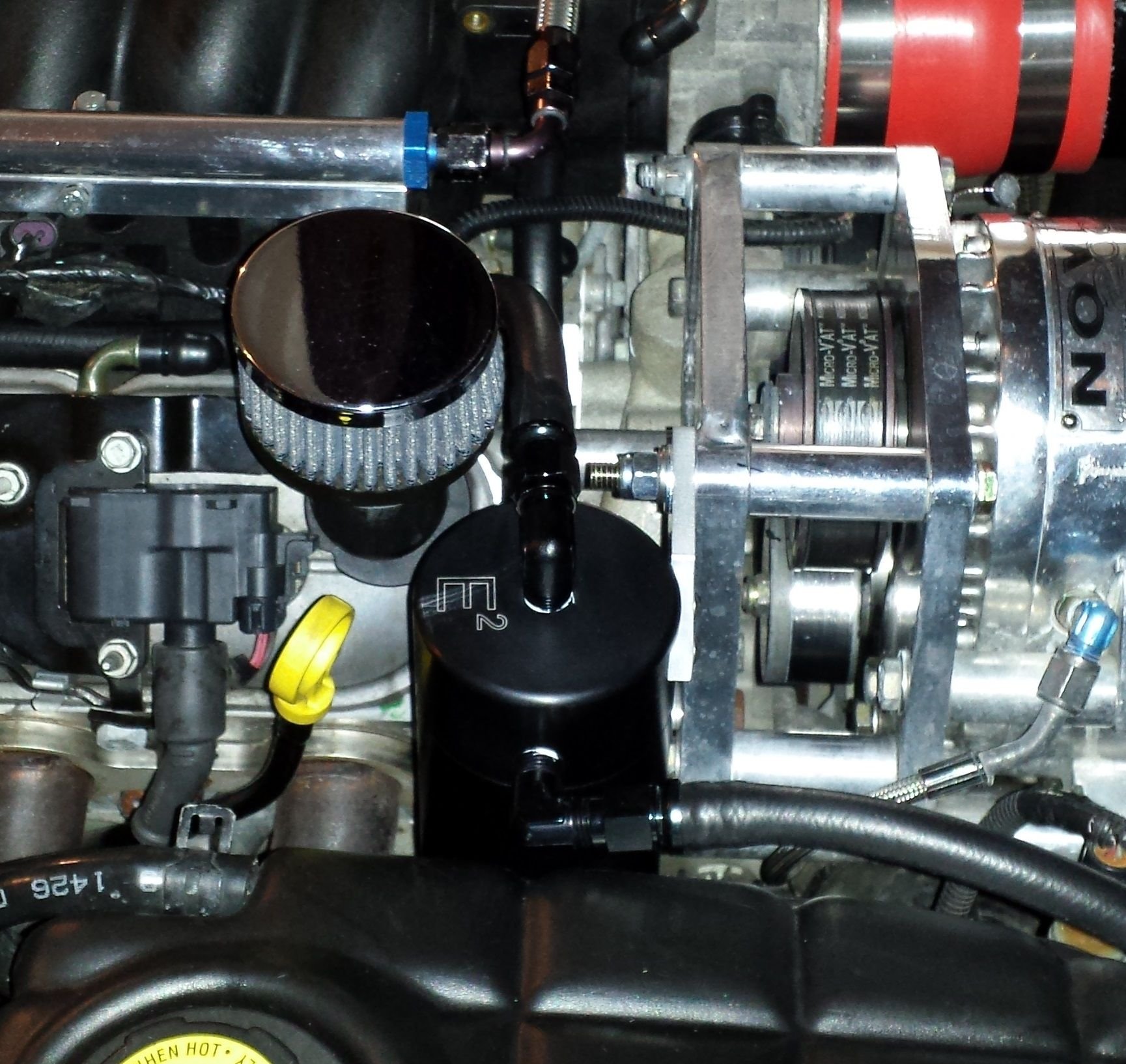

I installed the E2 last year on my NOVI 2000 bracket. Not sure if your bracket will allow for a similar installation.

My MM catch can setup

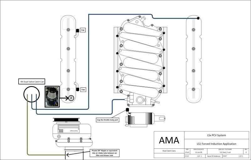

Don't you need another hose coming from the air filter inlet on the Procharger going to the can? I'm asking not telling you. I saw a few diagrams on supercharged applications showing another hose being used. Anyone have any idea why they would want you to do that?

This is what I was referring to. Why are they running a hose between the blower and air intake tube?

There have been more than a few threads in the C5FI section regarding this topic; including one or two long ones with a ton of info (https://www.corvetteforum.com/forums...ri-builds.html and https://www.corvetteforum.com/forums...ac-thread.html). As with most things, there are many solutions to this problem. The diagram you posted above is one solution (it is also what I chose to do on my car).
The theory is that when not in boost, the vacuum in the intake manifold will draw air out of the catch can, which draws air out of the driver side valve cover. When in boost, the intake manifold is pressurized and the check valve on the catch can closes as to prevent pressurizing the can and the driver side valve cover. So to evacuate the valve cover while in boost, the line at the supercharger inlet is used. There is vacuum at this location (I have never seen this quantified) which draws the air out of the can/valve cover.
I hope this helps answer your questions.

The MM catch can has a one way "flap" built into the filter on top. On the PCV setup, while in boost, it will vent out the filter
