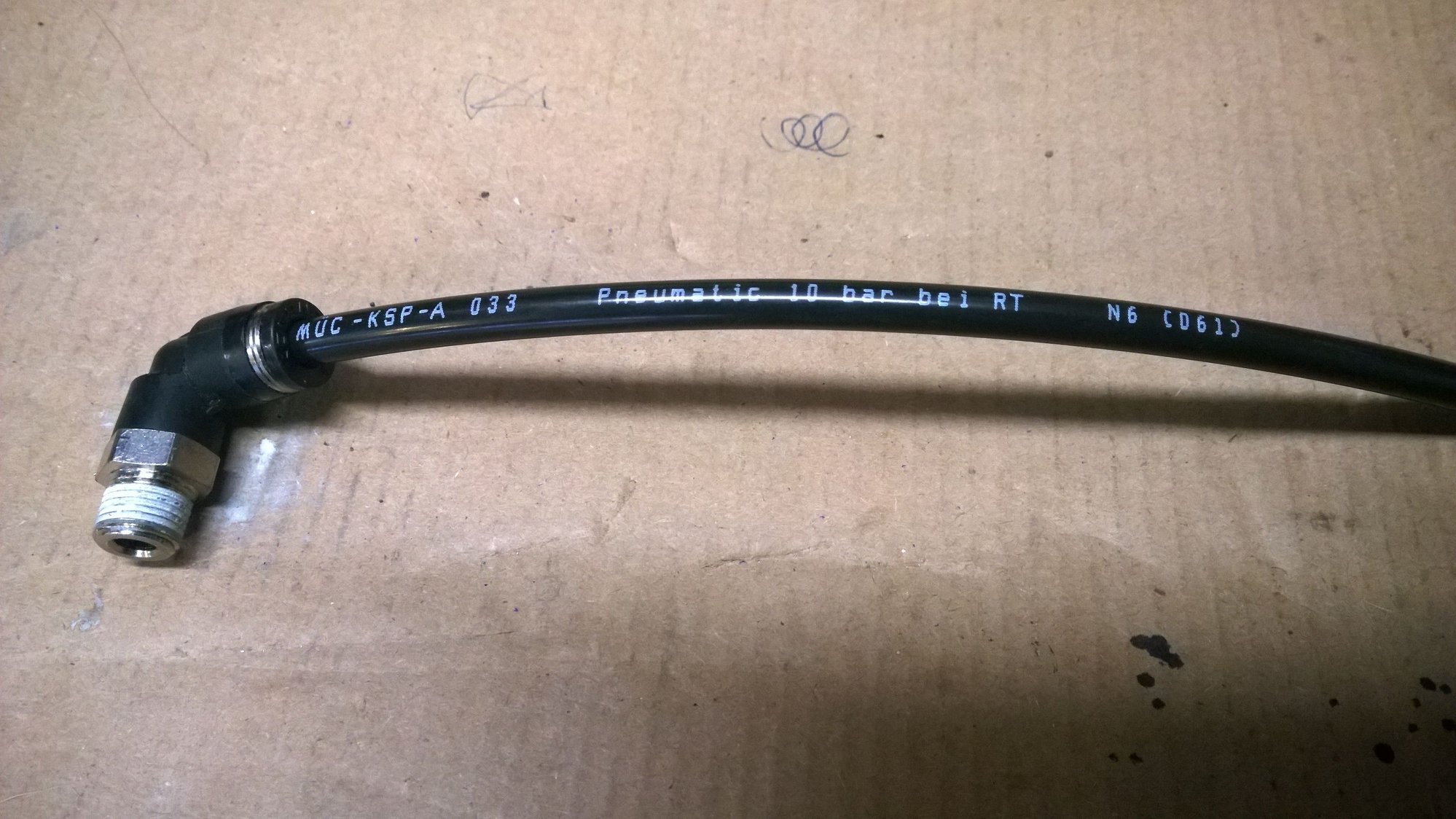

I ran mine through the factory washer fluid grommet. I just disconnected the washer fluid line and re-routed it through the wiper arm hole. I also used 6mm push-lock air hose, it was easier than running and bending metal tubing.
