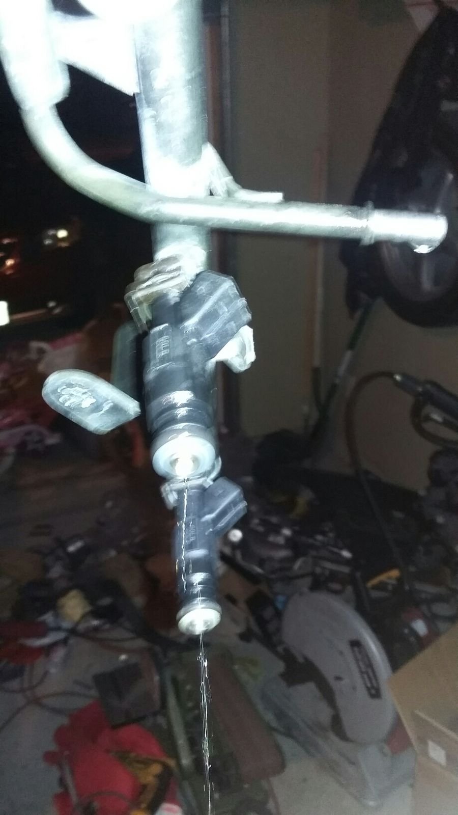

So brand new 60's stuck open, hydrolocked the cylinder and broke the starter... Starter is replaced, injectors swapped and she fired right up!
To Rear mount build.
