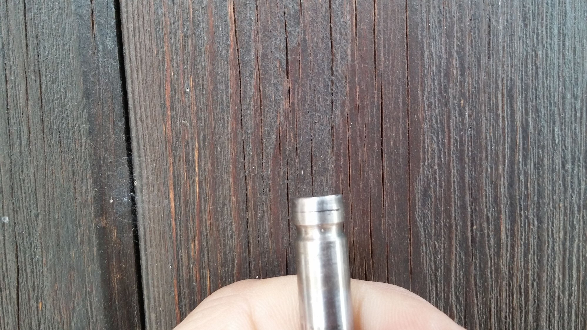

Sorry for the delay, i was not in the country
Here are the pic of exaust valve (all of them have the same problem)

I'm still not following.
What did the valves look like new ?
Are you referring to the line around the valve ? the actual top of the valve ? Other ?

yes, the "line" around the valve
i can try post other pic

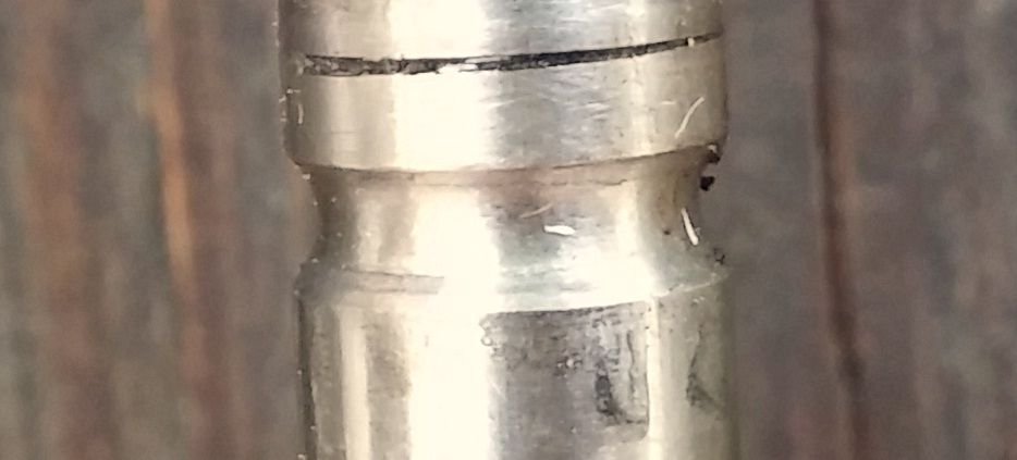

Posts: 573
Here is !!!

Ahh, wasnt sure.
Now that doesnt look good at all !
It doesnt even look even all the way around ?
What valves are they ? What rockers etc ? lifters ? is lifter pre-load set correctly ?

not all the way around, perhaps all the way who were the locker (because at the exact position of the top of the locker
only exaust valve (have seen the same story on another LS forum)
stock rockers, with trunion upgrade on stock LS1 head
brand new LS7 lifter
have check the lenght of the pushrod
all cam kit from ed curtis (FTI) cause special cam spec (#640 lift, double PAC spring, ...)

That's a common issue. One that has made me nervous when assembling motors but been put to rest by respected machinists. They tell me it's common and a non-issue.

On sodium filled that is probably the parting line/weld line. Shouldnt be a problem unless you run extremely high exhaust temps for extended periods (possibly causing it to crack and fail due to thermal expansion). But then you would have other problems too.
I run Manley extreme duty exhaust in my LS3/YSi. We have run Manley valves in our oval track engines for years and years.. good stuff imo. Ferra seems good too.
