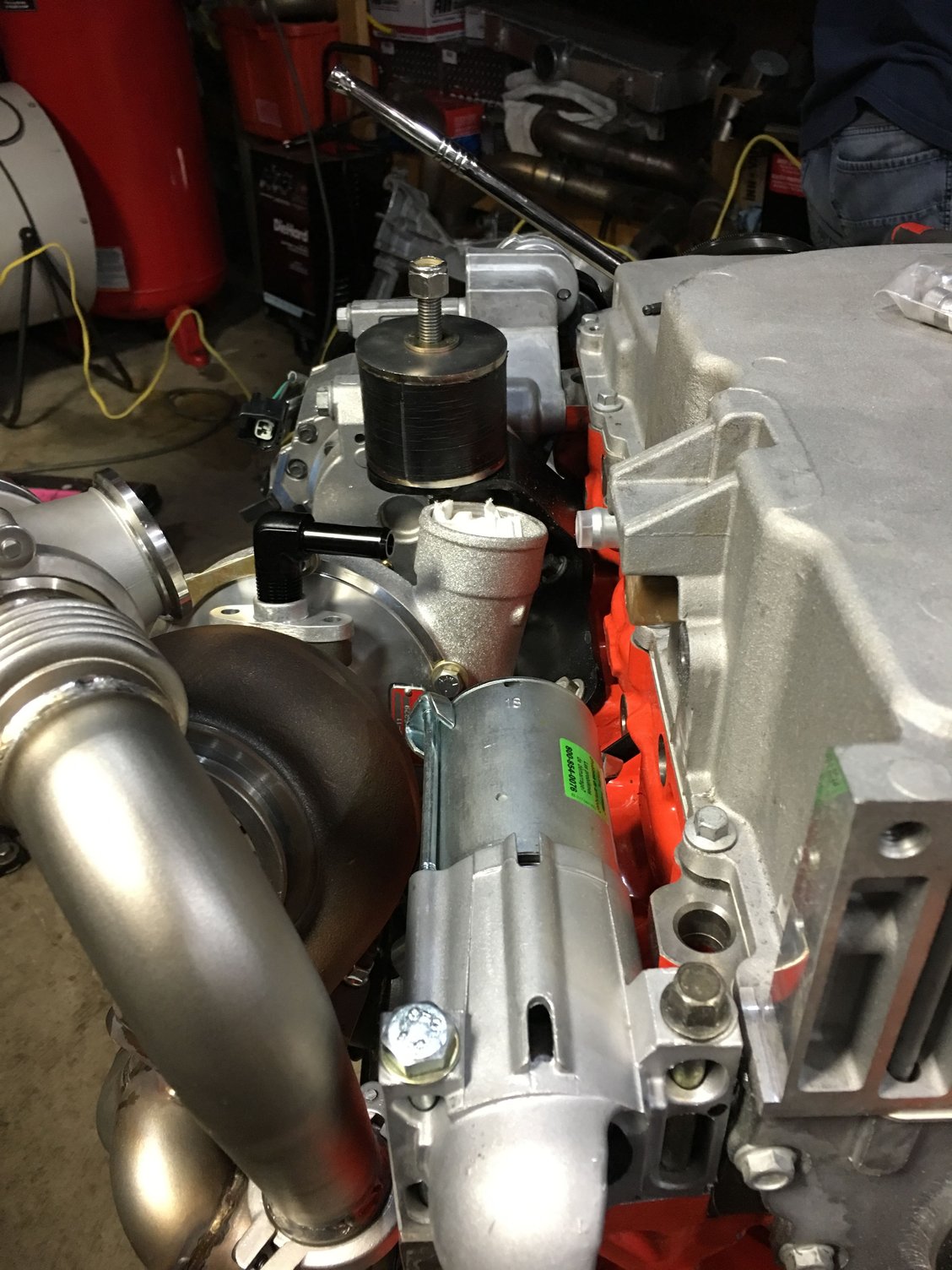

Replace it with the starter from a Silverado. They are physically smaller, gives you some space.

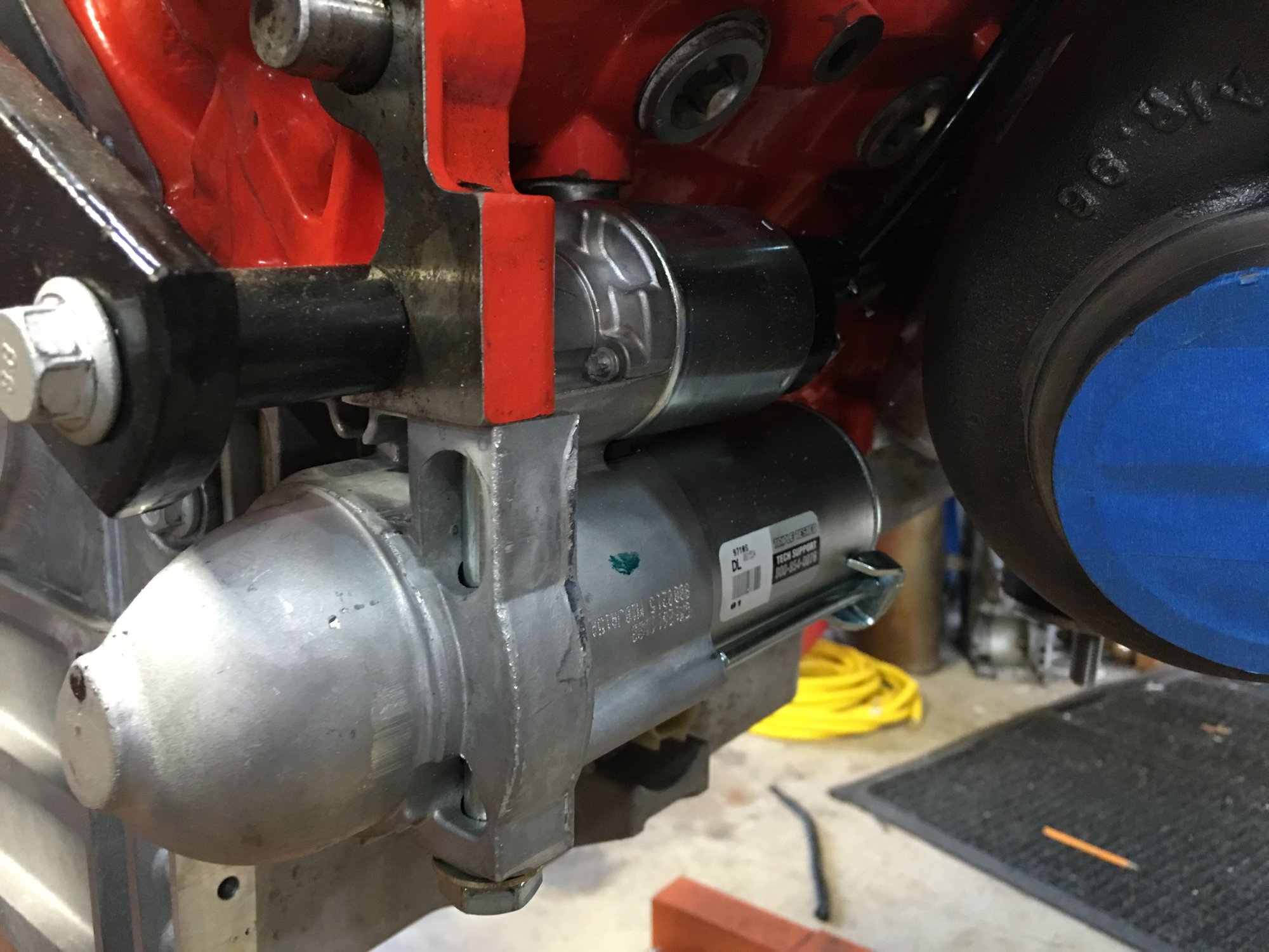

True, silverado starter certainly creates more clearance along with C6 pan. Then with gates off turbine housings, can drop starter even with 3.5" downpipes

Just look one up for a 2013 5.3 Truck, Autozone or whatever.. It was $150 locally. JDS99 was the one that figured this out, works awesome.

Aren't there a few other things to consider with the truck starter? Longer bolt, electrical connector, etc?
The electrical connector is $10, you just cut off the old one from the car and solder on the new one. Yeah one bolt is different, simple trip to the hardware store as you can see in the photo I posted. Its a very simple swap.
