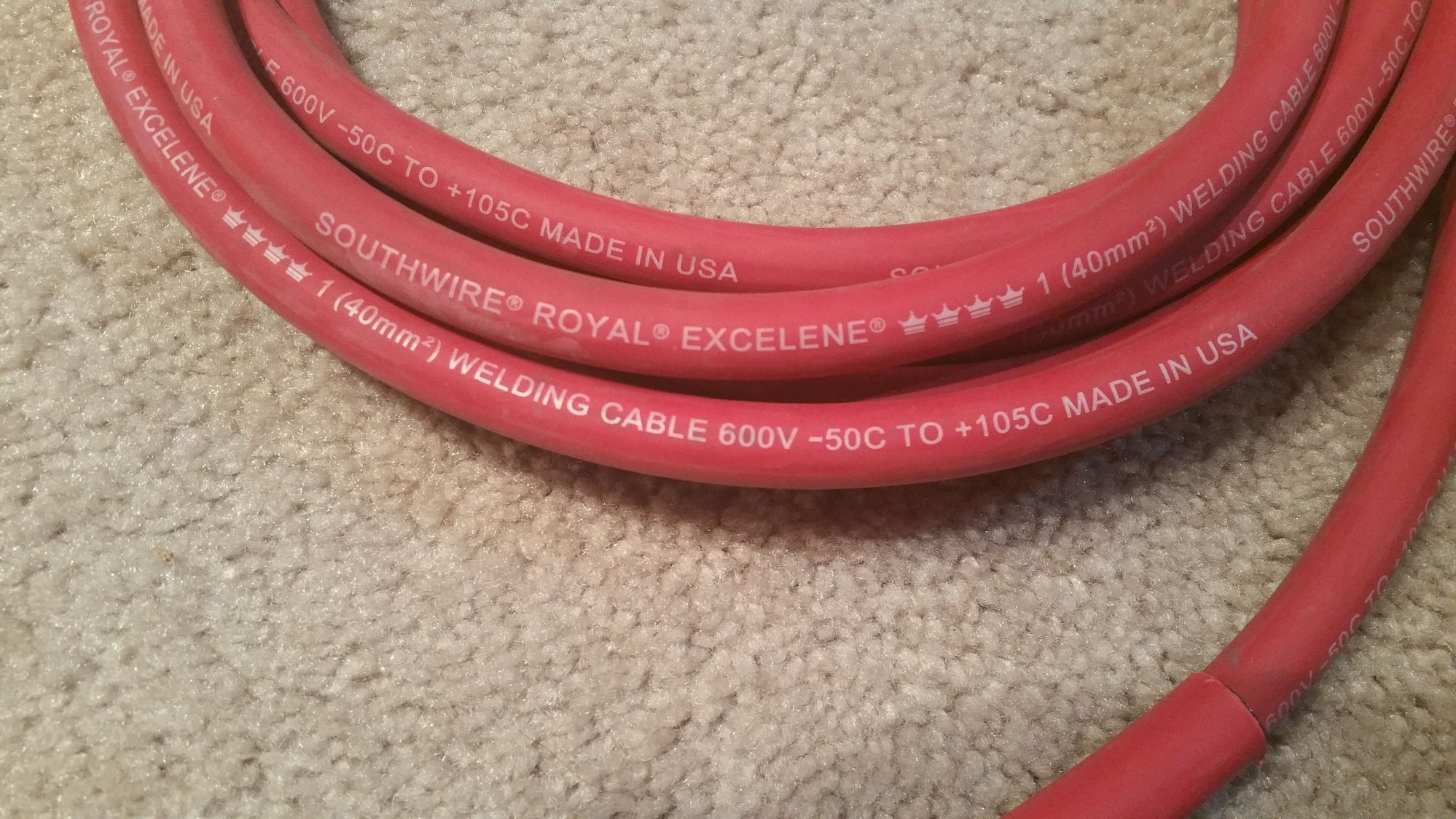

I ended up buying one gauge cable last week and arrived yesterday. So i will scratch out the idea of running 2/0 cable as I had posted above.
I got it pretty cheap on ebay. I'll attach pics of the cable and the link for anyone else who needs it. I will update more once its complete.
I will get the battery box later based on the type of battery I go with.
Bobby
http://www.ebay.com/itm/291710070419
