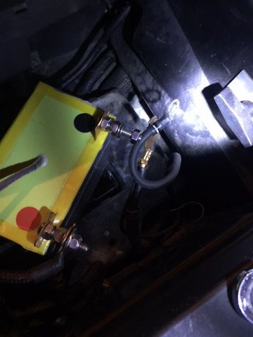

Finally had some time to take a photo of mine.

I put my $600.00 AntiGravity battery in this morning.
The terminals are backwards so I had to make some short cables
and the bolt to hold it down was too short as the ledge on the battery is higher but nothing I couldn't do.
Also the threads on the top posts to mount side terminals are a different mystery thread that is smaller than the side terminal bolts but not 3/8 x 18 standard however those size
bolts at 3/4" long worked well with my Big 3 kit and monster stereo and such.
Goes in ok and threads about 1/4-3/8" then get stiff.
